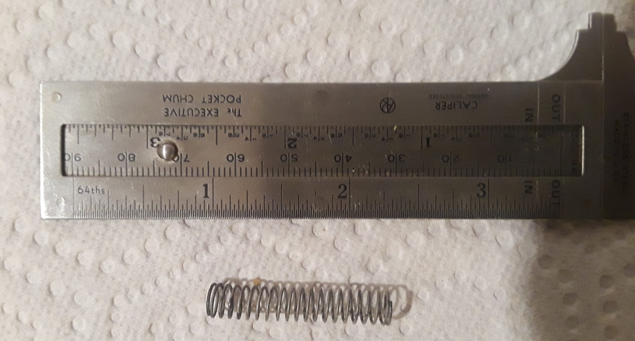

November 13, 2025 at 11:34 pm #301488This is a very old thread, but in case folks are googling this, a perfect replacement from McMaster Carr is part 1986K66. https://www.mcmaster.com/1986K66/
Description:
302 Stainless Steel Corrosion-Resistant Compression Springs
1.375″ Long, 0.25″ OD, 0.21″ IDOld on right, new on left.
6 users thanked author for this post.
November 24, 2025 at 6:23 am #301785This is a very old thread, but in case folks are googling this, a perfect replacement from McMaster Carr is part 1986K66. https://www.mcmaster.com/1986K66/
Description:
Sometimes the best answer takes about six years or so to arrive. These springs do look to be a very good replacement. Thanks for posting this helpful information.
