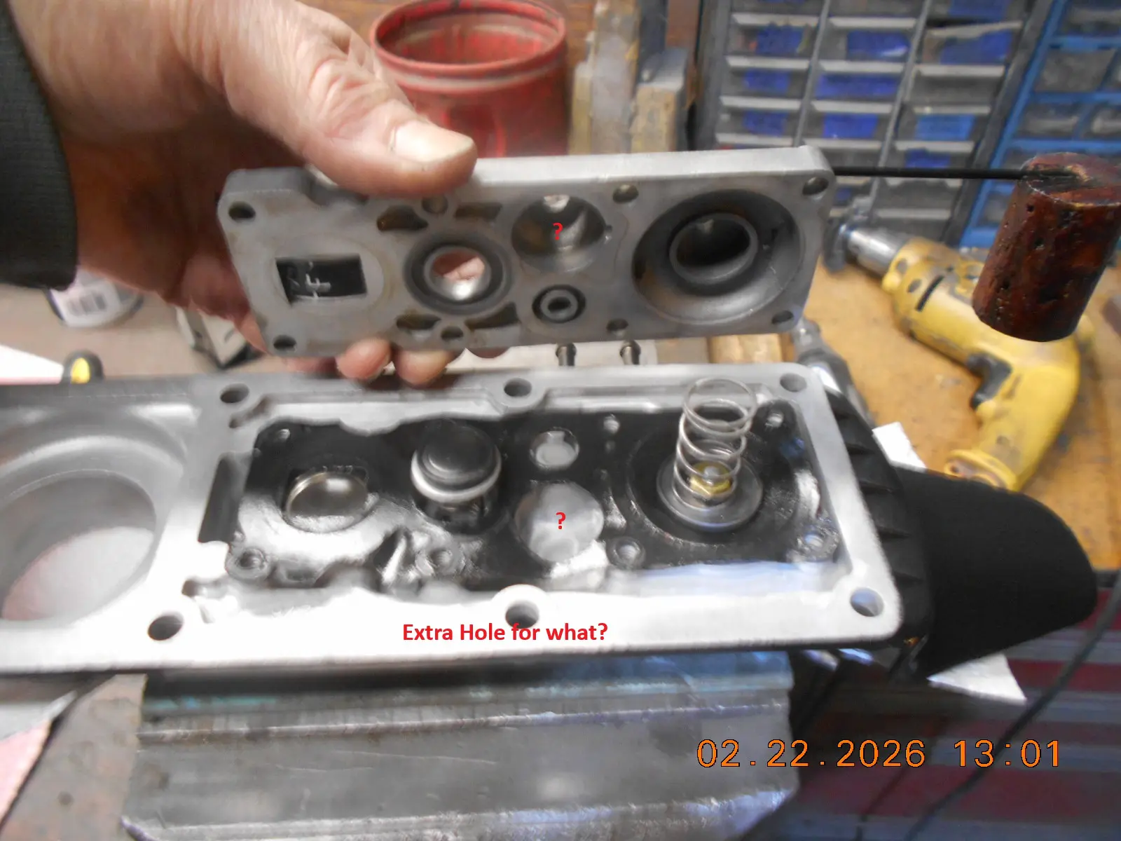

Just went through a Evinrude “Junior” tank and noticed a couple of
things that made me go hmmmmm?This original diaphragm (or at least the one that was in the tank)
- has an extra hole in it, that lines up with a dome with a hole.
The new diaphragm I have does not have this hole.
Just curious as to what’s the deal with that?
Regardless, the primer works great with the old diaphragm.

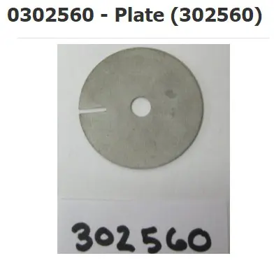

- This cap had no chain nor slot in the washer to attach one.
Were the Junior tanks like that, or someone switched out
the washer and eliminated the chain?VIDEO of Primer Test

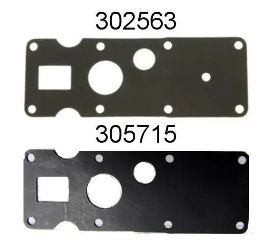

February 23, 2026 at 7:05 am #304959Hey Buc, I’ve never seen an extra hole that you’re referring to in the diaphragms. The only extra hole is in the earlier diaphragms for tanks that had the aluminum push rod like that tank, and not the black plastic button. And the Junior tanks did originally have slots and chains just like the 6 gal.
February 23, 2026 at 8:41 am #304962February 23, 2026 at 10:14 am #304966Thanks Steve,
That diaphragm with the extra hole must have had
a use in some application at one time, as it’s directly in line
with a dome in the casting.
Not worried about it, as it works as is, but was curious.

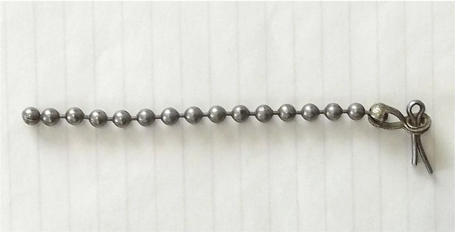

I guess I can make a slot in my washer for a chain.
Just have to find a chain now!Prepare to be boarded!
February 23, 2026 at 10:21 am #304967I’m sure I must have one in my extra tank parts I can send you in a stamped envelope.

February 23, 2026 at 11:27 am #304976February 23, 2026 at 12:25 pm #304982I’m sure I must have one in my extra tank parts I can send you in a stamped envelope.
Steve, Thanks, but I have one new diaphragm left, but am saving it for the next tank
I’m working on, just in case I need it.Prepare to be boarded!

February 23, 2026 at 12:29 pm #304984Steve, I have some other “non pressure” tanks in a pile. I’ll check
to see if any of them have chains. Thanks for the offer.Prepare to be boarded!
