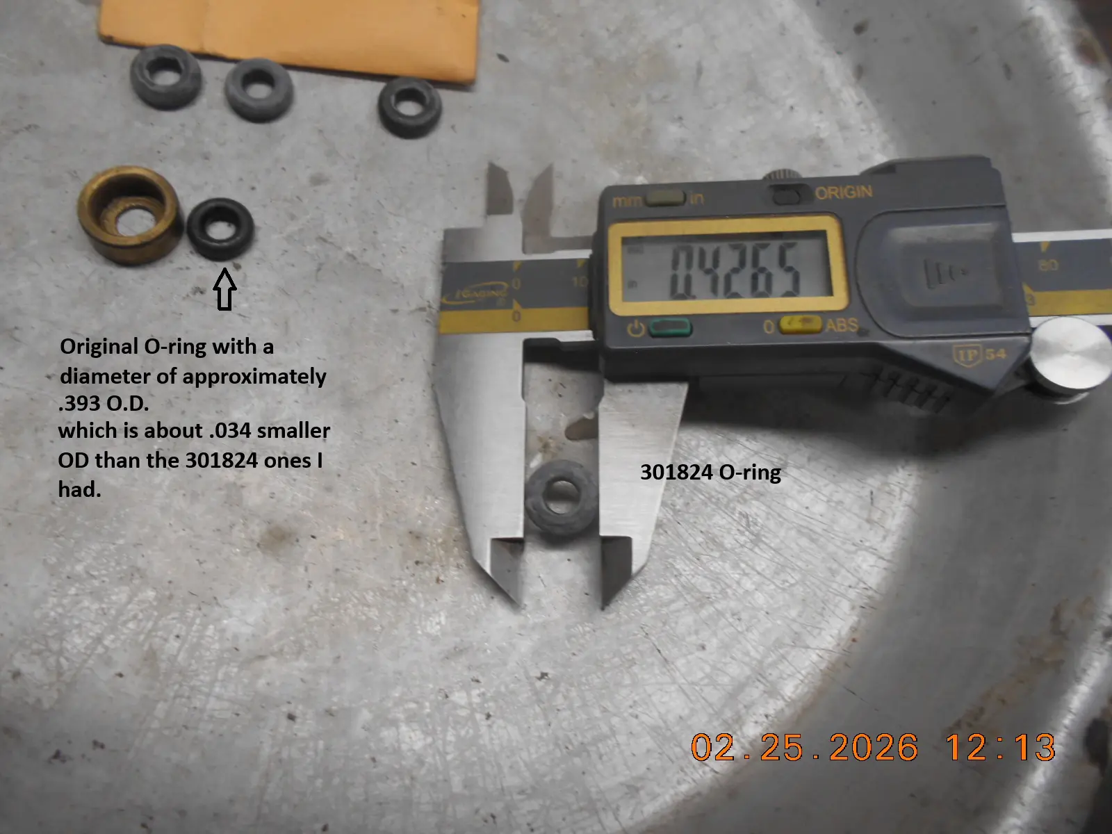

I had some o-rings in an envelope, marked as 301824.
When I went to replace the originals in the fuel hose
connector, I noticed the ones I had in the envelope
had about .034 larger outside O.D.

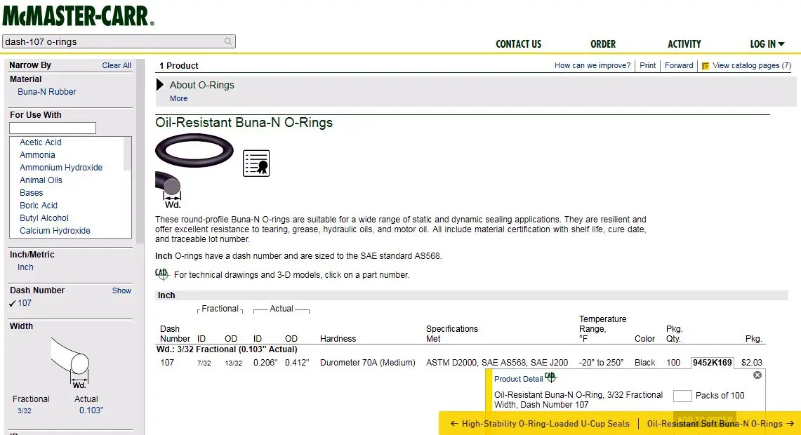

I bought these several years ago. I wonder if whoever sold them
used Sierra o-rings, or perhaps the McMaster-Carr #107 that
is supposed to work.
Anyway, I used the new, larger O-rings, and hooked up the connector
to a motor, and it seem to work fine.

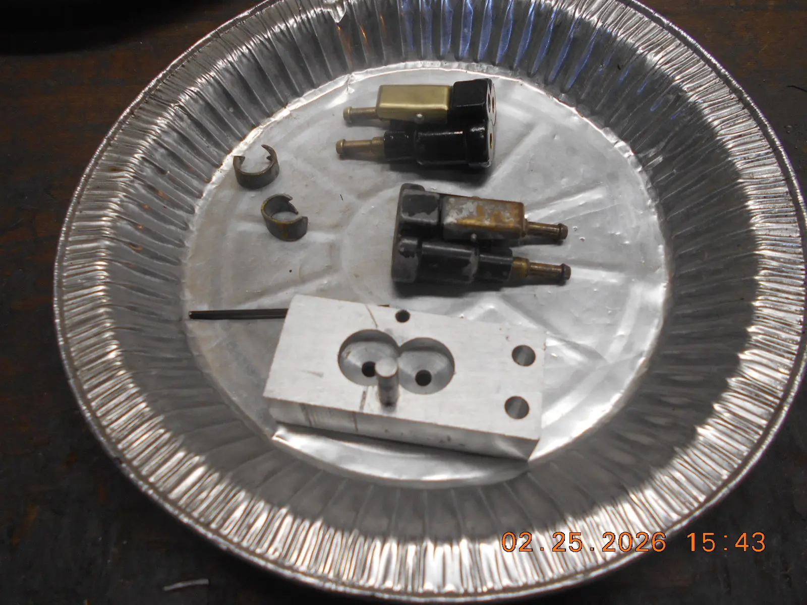

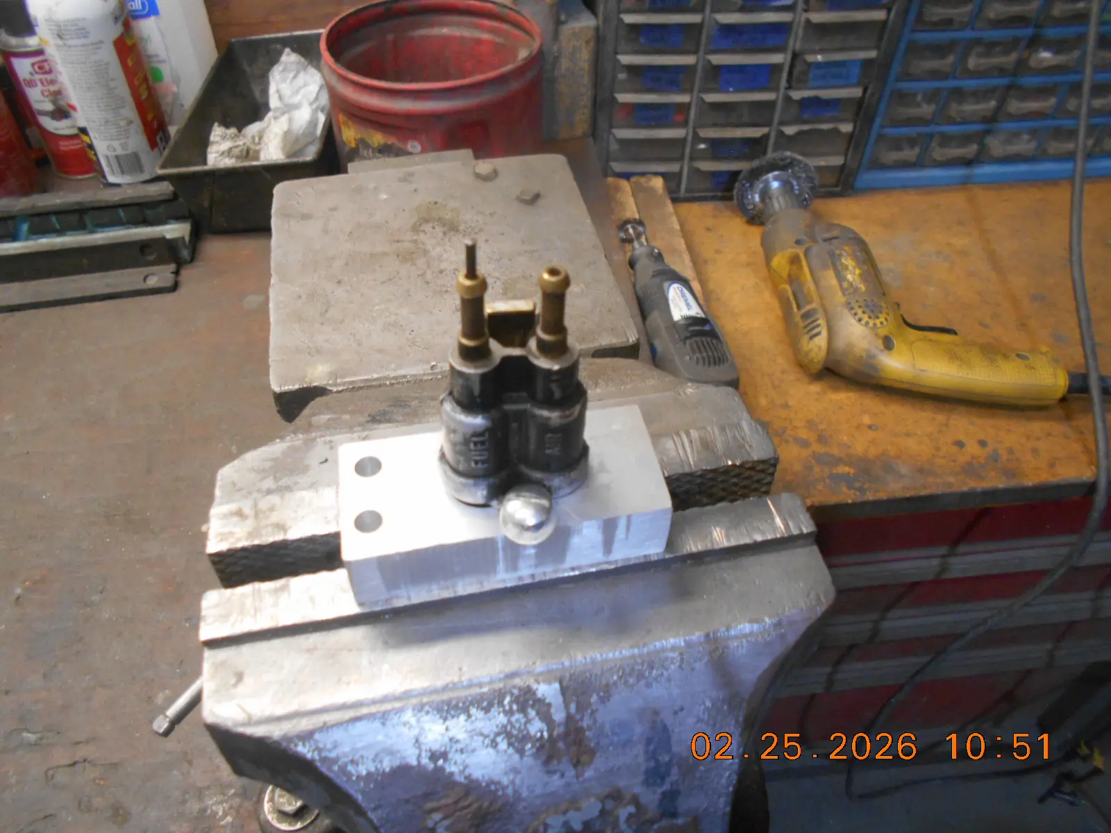

Anyone else run into this issue with “bigger” o-rings?I hadn’t changed any connector o-rings out for quite a few years, but
luckily found my bootleg fixture to take the guts apart.
Found out that a little heat from my bottle torch worked wonders.One finished, one to go

February 26, 2026 at 6:07 am #305039The 107 o-rings are “smaller” but still work, they just do not apply as much pressure to the pins as the original.
The cup that holds the ring, just imagine the original ring is four ounces in that cup, the #107 fills like 3 ounces and still works.Frank used them for one reason….cost
They fit, they perform by sealing things up.Cost of an original OMC ring: Currently $3.10
Cost of a bag of 100 pieces of the #107 o-ring from McMaster-Carr: $3That is why I include them with the tool.

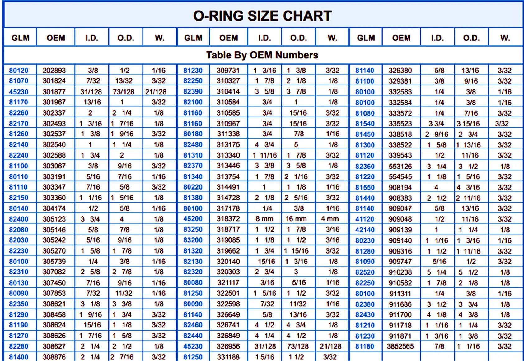

February 26, 2026 at 9:07 am #305041The other reason is that the 107’s are the exact same size as the original 301824’s.

February 26, 2026 at 9:33 am #305046Yeah I wondered the same thing Buc. That was one of the reasons Frank suggested using them, and the chart bears it out (which might have been originally posted by Garry). And if Frank said it, it was good enough for me. I’ve been using them for years since then and never had a problem.
