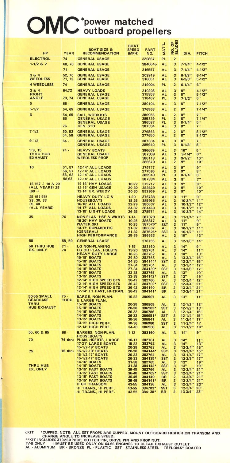

      I have this NOS prop, OMC #387334. It is shear pin drive, 8×7, three blade. I was kind of proud of myself, in that I looked at it and thought, “That looks like it belongs on a nine-and-a-half.” I looked up a 9.5, 1971 and sure enough, that was the stock prop listed. My question is, what ELSE will it fit, if anything? I assume it will physically fit a LOT of things; but as an actual, recommended application, I don’t know. I know we have a Michigan prop data base, but what about OMC props? I am particularly wondering if it might be a good prop for my ’56 Fleetwin 7.5, on my very light boat?
      EDIT: I am too lazy to go look right now, but it occurs to me that the Fleetwin shear pin is probably more near the prop NUT; so this prop is out for that. But I still wonder what else it fits?

        Maybe this chart will help….
        Propeller-Chart

          ’58 – ’63 ten horse props are the same as ones used on the 9.5’s.
          #217902
            OK, well the 7″ pitch three blade props will fit 6hp and 9.5hp models. It will fit older small gearcase 10hps also. This 7″ pitch prop is probably that highest pitch that a 6hp can handle. The 9.5hps came with an 8″ prop, but the 7″ prop is a good alternative in many cases due to it’s low power output. The 10hps came with the 8″ prop, and can often use the 9″ pitch prop. The 7″ prop will usually cause the old 10hps to over rev.
            This prop won’t fit on the older 5.5/7.5hps models with the rubber prop nose cone due to different shear pin location like Bill says…
