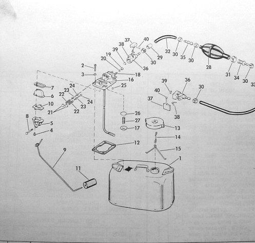

      I’m trying to get a metal single line tank usable.
      I got rid of the light rust inside, made new gaskets, etc.
      I was trying to confirm that the pick-up tube was
      not plugged, but I can’t seem to get flow either way.
      Is there a check valve in the system?
      Instead of un-soldering the screen, I taped a piece
      of vinyl tubing over the screen and tried blowing
      air thru. Did the same thing from the outlet end
      with now luck. Guess I’ll un-solder the screen and
      try rodding out the tube, unless someone has
      a better idea?
      I think mine is like this diagram.

        The two little pins that get pushed in when you connect the hose—-are they pushed in? They are vent & fuel shutoff valves

          Frank, I was just going to amend my post stating,
          "Never mind, I’m an idiot", then I see your post
          stating what it took me half an hour to learn, lol.
          Most of my collection is "pre 1960", and most have
          integral tanks!
          I had the pickup tube in a can of gas, and put
          suction to the outlet fitting, via my sand blaster gun……
          nothing……… then I got the bright idea to push
          in one of those pins!
          I thought they were just spring loaded pins to keep
          tension on the hose connector.
