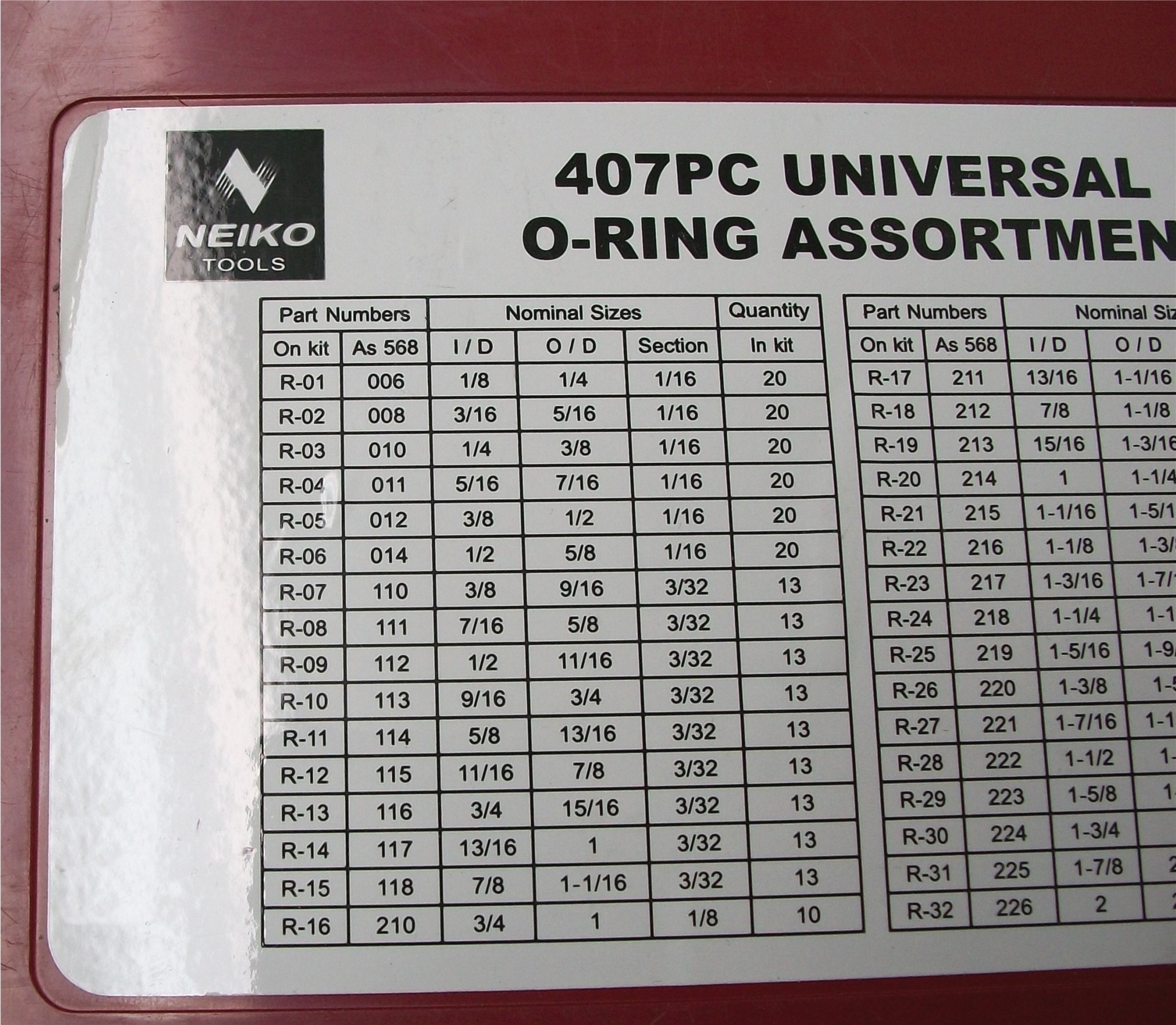

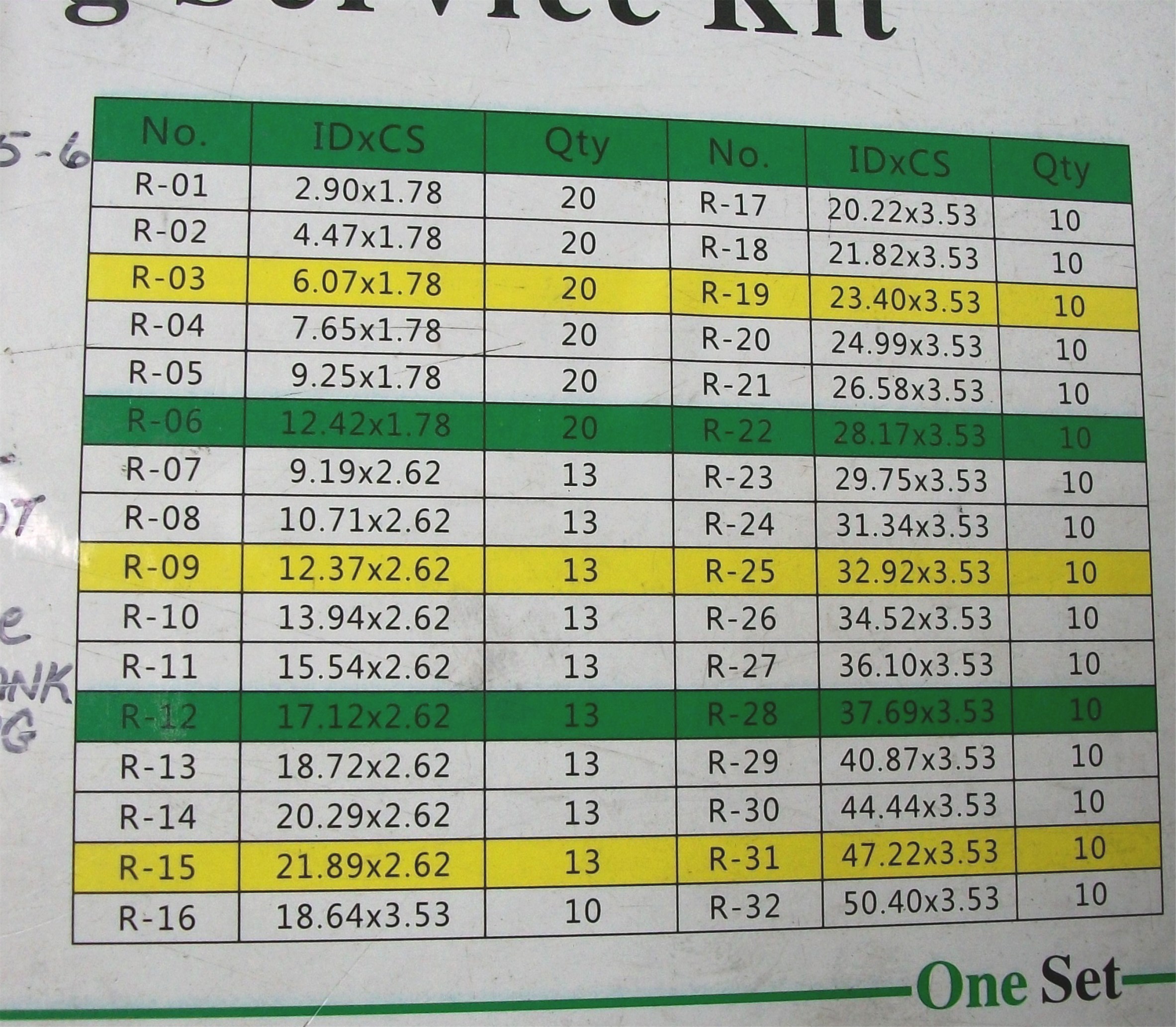

              Hey Buc, these are the 2 different kits I have…
              #77528
                quote Steve D:
                Thanks Steve, looks like your kit actually shows the sizes!
                I wonder why I couldn’t find that information on the Net? 😕
                I ordered a bunch of different sized small o-rings yesterday.
                Will have to look at my order and see if any of them are actually
                R-2 and R-3 sized. Printing off your chart, and sticking it in
                my o-ring kit!
