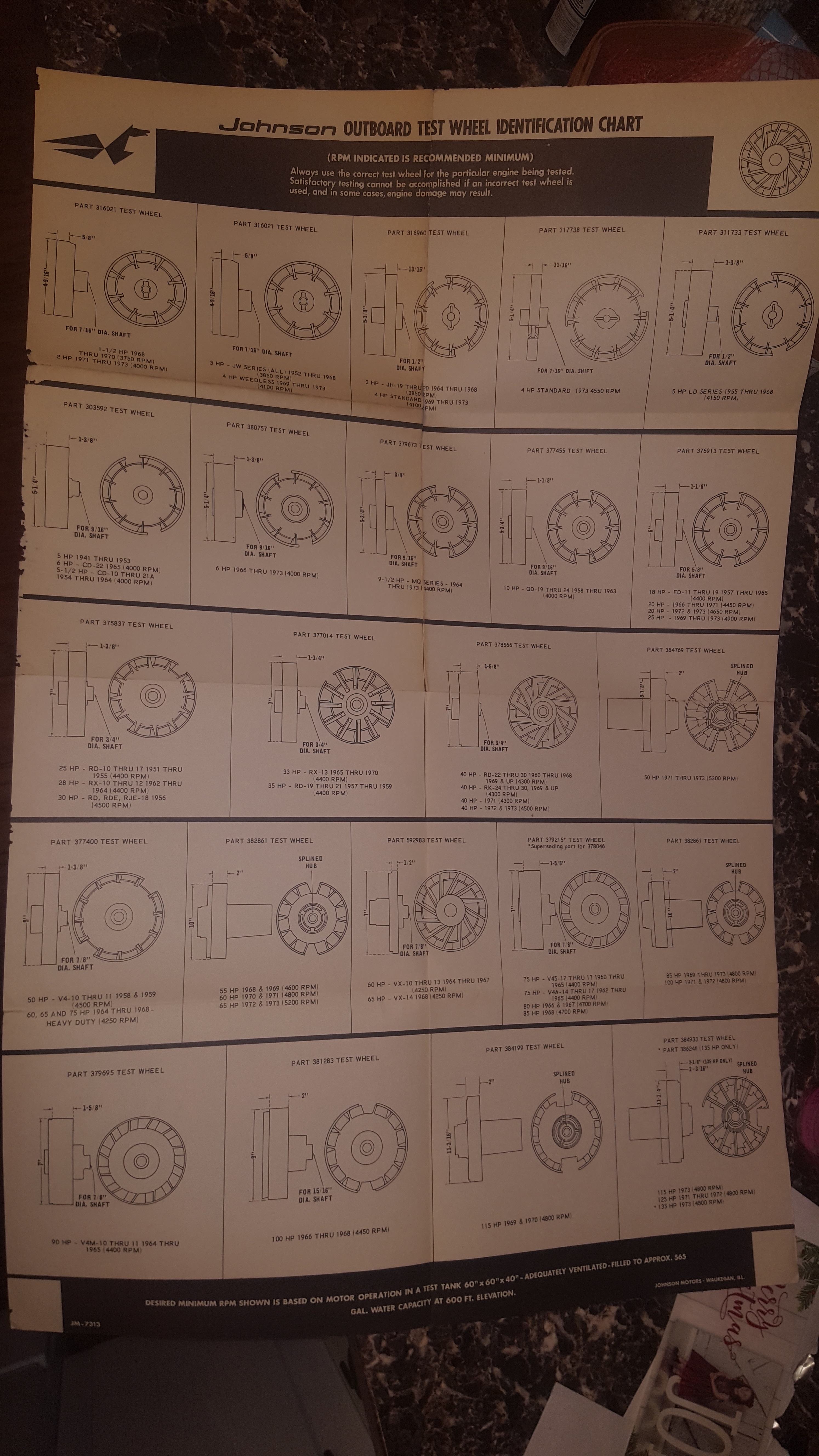

        Yeah, I have a fold out chart listing tons of them, Let me dig it out this afternoon..

          Yes, I have an older one around here too somewhere. It has the cast numbers & dimintions on it for various horsepower motors by models. Yes, Richard they simulate running conditions, but nothing is the same as a lake test! You need a good test tank for it to work well at all.

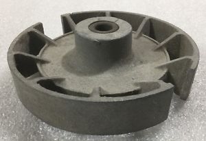

            The QDs changed to the small 4-bolt gearcase in 1958 so that’s where the difference is for the QDs. 1949-1957 will use one and 1958-1963 will use the other one. I use the 15-18hp test wheel (5-bolt gearcase) for my 1949-1957 QDs. It isn’t perfect but is fine for my purposes. I have the right test wheel for the 1958-1963 QDs. I currently use a 55-gallon plastic drum. This works fine for the 5.5-7.5hp motors, but 10 and over will still ventilate some at WOT. It does let me get them quite close in the tank before dialing in on the lake. I dont have the part numbers handy, but I’m sure Dan will have them.

                  Here’s the P/N’s for the test wheels and the RPM’s the motor should be run at.
                  P/N 277278 ’49 – ’57 QD @ 4050 RPM and also ’56 FD @ 4500 RPM
                  P/N 377455 ’58 – ’63 QD @ 4050 RPM

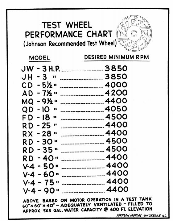

                      Here is what I have, it is a LARGE picture because the "poster" is large….
                      Notice the note t the bottom of the page describing the tank that they used, conditions and elevation..interesting
                      Copy as you wish, and I hope it can help someone.

                        Yeah, I don’t think a 55 gallon test tank is sufficient for WOT test runs with a test prop. I may be wrong.
