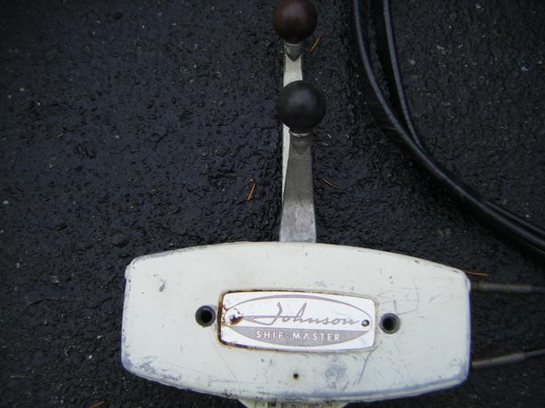

          That makes sense as the smooth ones here have ’58 style lettering on them. What year did they change over to the boxy controls?
          #48147
            I am fairly sure the "boxy" ones, as you call them, came out in 1961. A far better control, if you don’t insist on correctness on earlier motors. The "Snap-in" cables came out in 1979.

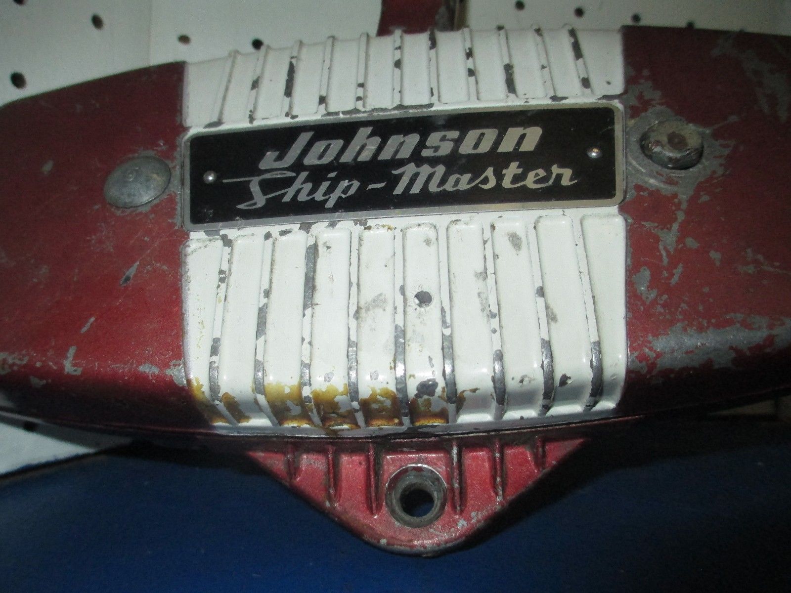

              Here’s one I’m trying to ID. It came with a c.1960 boat, and the "boxed" letters and the "winged" E were both used in 1960, but it’s ribbed…
              Could that green have been the original color, or was it just worn down to (chromate) primer??
              #48165
                Zinc Chromate primer.
                #48181
                Leon
                  I would guess 1958 – 59, Phil

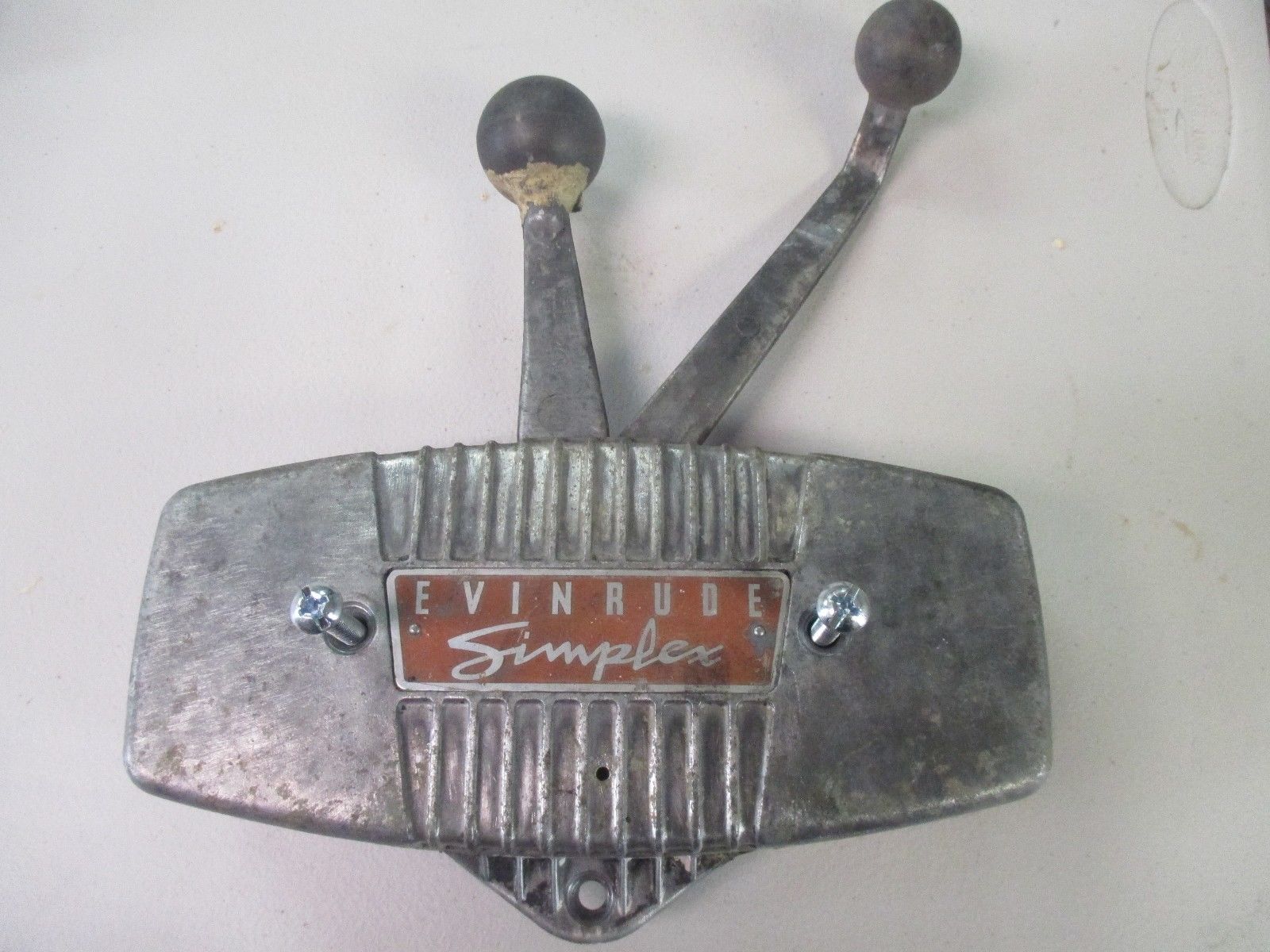

                      While we are on the subject does anyone have or know of where I can get the shorter lever for one of these? mine has been repaired at some point in its life. Also a source for the shifter cable motor end would be great if someone has a source.
                      Mine is black with a red riveted on plate with Evinrude Simplex on it. It is also a ribbed version. About what year is this one from?
                      #48197
                      Steve D
                        That style lettering was ’57.
