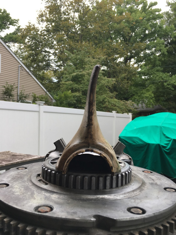

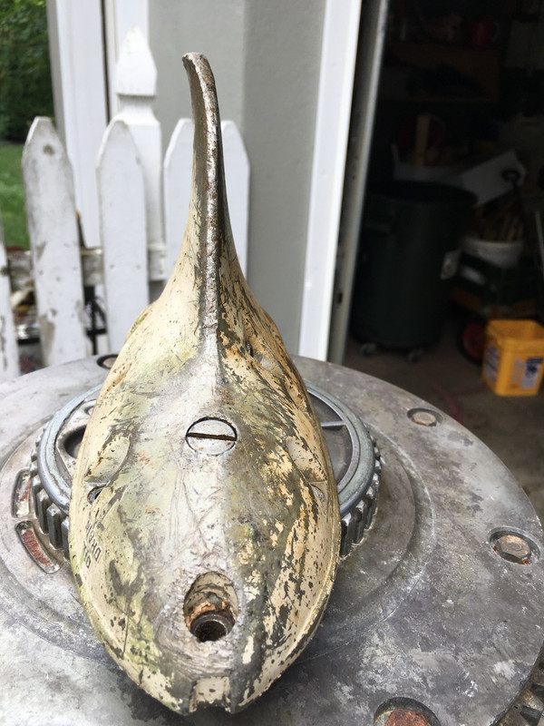

      And then there’s this on the Johnson. Bad, right? 🙂 More importantly, can it be straightened?
      I could:
      a.) fix up this lower completely & have a spare, complete lower (bent skeg notwithstanding)
      b.) provided the gears are compatible, keep the gearset & pieces as spares for my existing lower, and just keep the housing as a spare as well; toss the skeg.
      Or if anyone has another idea, I’m all ears.

                The official answer is you are not supposed to swap skegs. The unofficial answer is I have done it 1, 2, maybe 50 times. The motors don’t really seem to notice I promise. Swap the skeg, don’t bother with that one, and away you go.

                    I’ll keep my eyes open for a skeg; once found, I’ll rebuild the Johnson as a spare, complete lower and keep it for a rainy day….

                        I’m by no means an expert, so I appreciate the advice. But Chris_P, in his post above, says that he’s swapped skegs often.
                        The notion that I can straighten the existing skeg doesn’t seem realistic.
