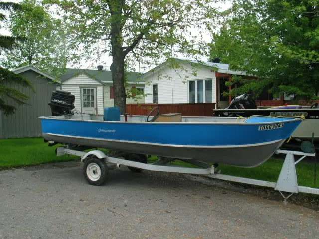

        Best engine I ever had till my ETEC 75  had 2  of them one was a Classic 50. (see pic)
        As always the critical part is testing compression, look for near equal+/-10%   evaluating overall  level of TLC received since 1964, (picture shows a really nice  well kept engine )    salty or fresh water engine ?. …actual test run result if possble by seller .  if auto oiler (added on  a 1964)    I would get rid of it and go premix 50/1  check wiring for  crumbling  wiring (possible easy fix  if handy  and good barganing chip to lower price.)
        they do love fuel being carbed but smooth idling all day on 5 gal.
        if you buy….do usual stuff like, change impeller  check GC oil for leaks   try a pressure-vacum test, refill  , clean the carbs , check ignition etc… Princecraft
        and a Mercury Black spray can will make it like new  but your’s probably just needs a touch up on the GC !!

            To properly test a GC  it must meet two measurements  one involves pressurizing the GC  with an air pump. ( this confirms oil will not leak out during operation .. egress)    The drained of oil  GC should retain about 10-12  PSI for a few minutes.  IF the pressure drops spray soapy water on the drive, shift and prop  seal areas to identify the culprit.   Prop shaft seal are the usual bad ones  due to monofilament spooling in the GC and destroying  the seal.   Pull the propr and check!!
            The  second test is a vacum test to measure the GC capacity NOT TO LET IN any water when   the GC cools off after long runs. Cooling  reduces  the inside  pressure and tends to suck in water  (ingress)
            Here is a good  video explaining  it.    But don’t let that discourage you.. That Ob looks pristine.   JUst check out the wiring in case it is brittle and  crumbling… it may not be of course
            worst case scenario some folks just dump the  GC oil  mid season  and refill with fresh. ….saving the cost of a reseal job.. Oil is cheap!
