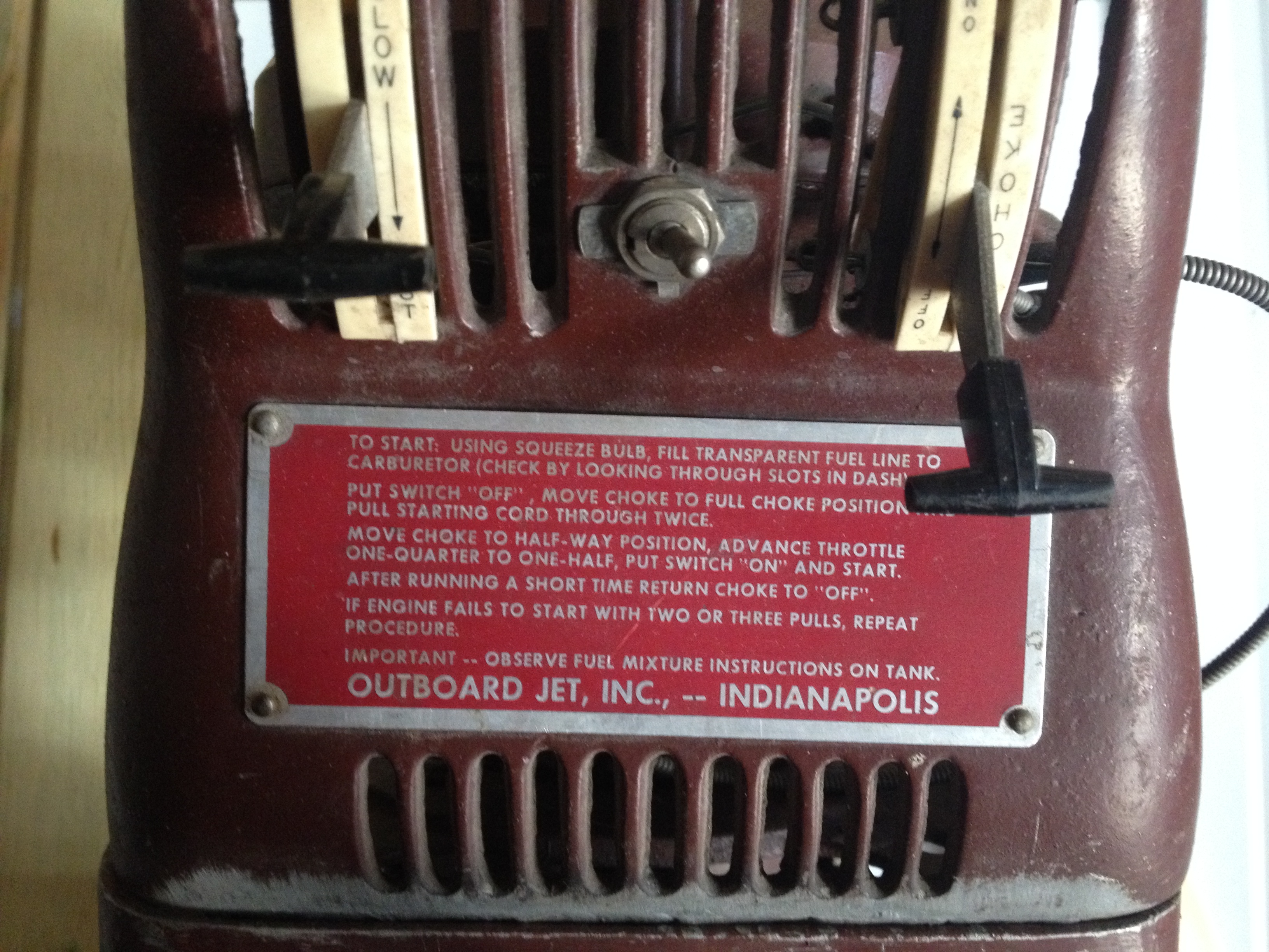

16:1 mix, uses a Tecumseh powerhead. 5 1/2 hp.

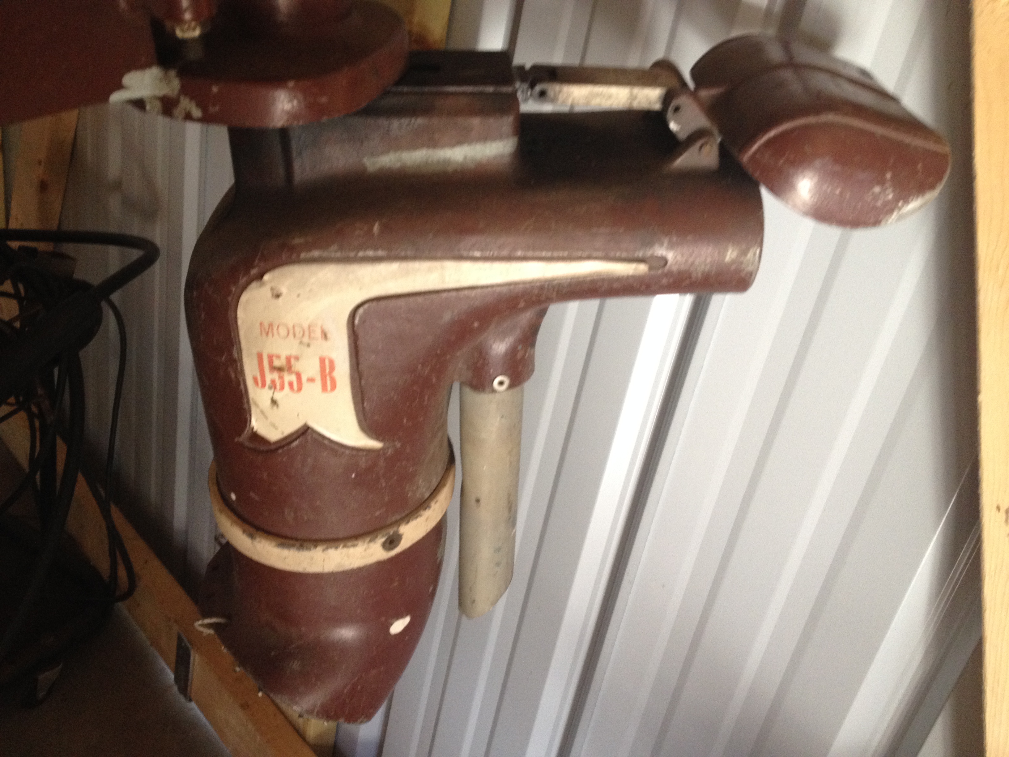

January 30, 2016 at 3:13 pm #31066Hi vidaliaman – welcome back! Looks like you’ve found an Outboard Jet J-55B. This is the earlier brother to the OJ200s that several members have – many folks feel they are more reliable than the later unit! I looked through the OJ material and a couple of Abos Guides I have handy and nowhere can I find a note on the mix. However, as I recall, the 55 uses a Tecumseh/Power Products powerhead – at that time they almost all called for 16:1 (save really heavy duty ones like on the Dragonfly that need 10:1) using air-cooled 2-cycle oil. I’m sure 16:1 will be fine especially using modern oil. I’ll keep my eyes open and see if I can dig up confirmation, I also have a paper file on these motors I can dig up and look through.
The brochure for the 55 is posted over on my OddJob Motors site on the OJ-200 page, you may find it interesting if you haven’t already got it: http://www.oddjobmotors.com/images/outboard_jet_200/oj_j55b_brochure.pdf Unfortunatly I don’t see the gas/oil mix mentioned. There’s other miscellaneous OJ stuff there too, though most pertains to the 200.

January 31, 2016 at 3:40 pm #31107holy cow lotec that is great info, wonder how tough it will be to find the cowl, i would have defaulted to 16:1 just to be safe, i’ll keep updating on this project and others
thanks again all for all the help and glad to be backJanuary 31, 2016 at 4:50 pm #31113quote vidaliaman:Wonder how tough it will be to find the cowl
I think finding a cowl is going to be a real challenge…. I’d send a postcard with a WANTED ad into the Editor of the printed AOMCI newsletter so it goes out to the whole membership. You can try the Webvertize too but I doubt that will bring results, it’s a pretty esoteric part. And I guess you should set up an eBay search, you just never know…Keep us posted – a very cool and unusual motor!
