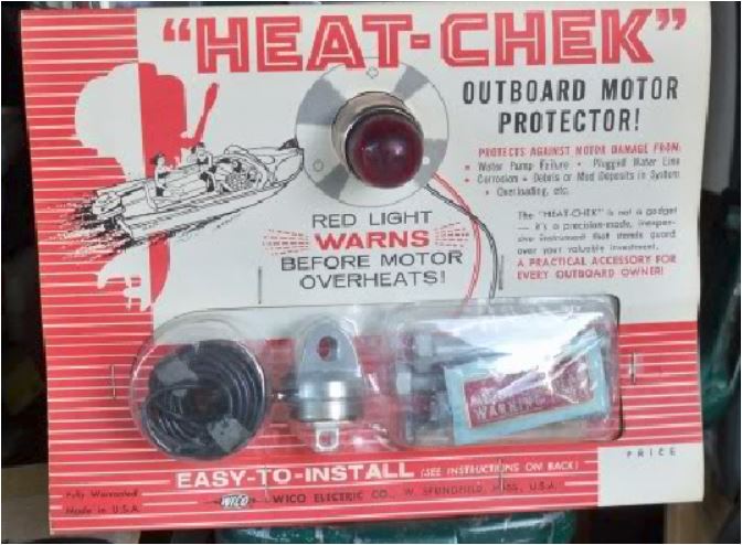

My boat came with an old Engine Overheat indicator mounted in the dash. I have no idea what make or model motor the indicator is for. Its just a metal plate with a red light but I like the way it looks and thought it’d be great if it were functional.
However, I’m now running a ’66 Evinrude 33 hp Ski Twin.So my question is, is there a way to connect a sensor of some type to my Ski Twin that would turn on the indicator lamp if the motor overheated?
Thanks,
WillieJuly 24, 2016 at 12:43 am #40780July 24, 2016 at 2:07 am #40786I’m not sure what temperature you need but a switch like one of these under a head bolt would turn on a light. Guessing 160°F is a guess. A single wire shorting to ground at the switch to complete the circut should work.

July 24, 2016 at 2:37 am #40790Great ideas. The indicator that I have consists solely of a painted red light bulb and a pigtail lead. I like the ideas presented here and appreciate every one of them. I’ll do some searching and see what I can find that is small enough to mount properly.
Thanks.July 24, 2016 at 5:28 am #40797July 24, 2016 at 8:08 am #40801That looks like the one that came with the OMC Temperature Gauge Kit. We used to sell quite a few of those kits back in the day. Whenever possible, I tried to mount the sender under a head bolt on the exhaust side where it is the hottest. Not much point in monitoring the temp on the cool side. On some motors, you could screw it right into the cylinder block water jacket.
