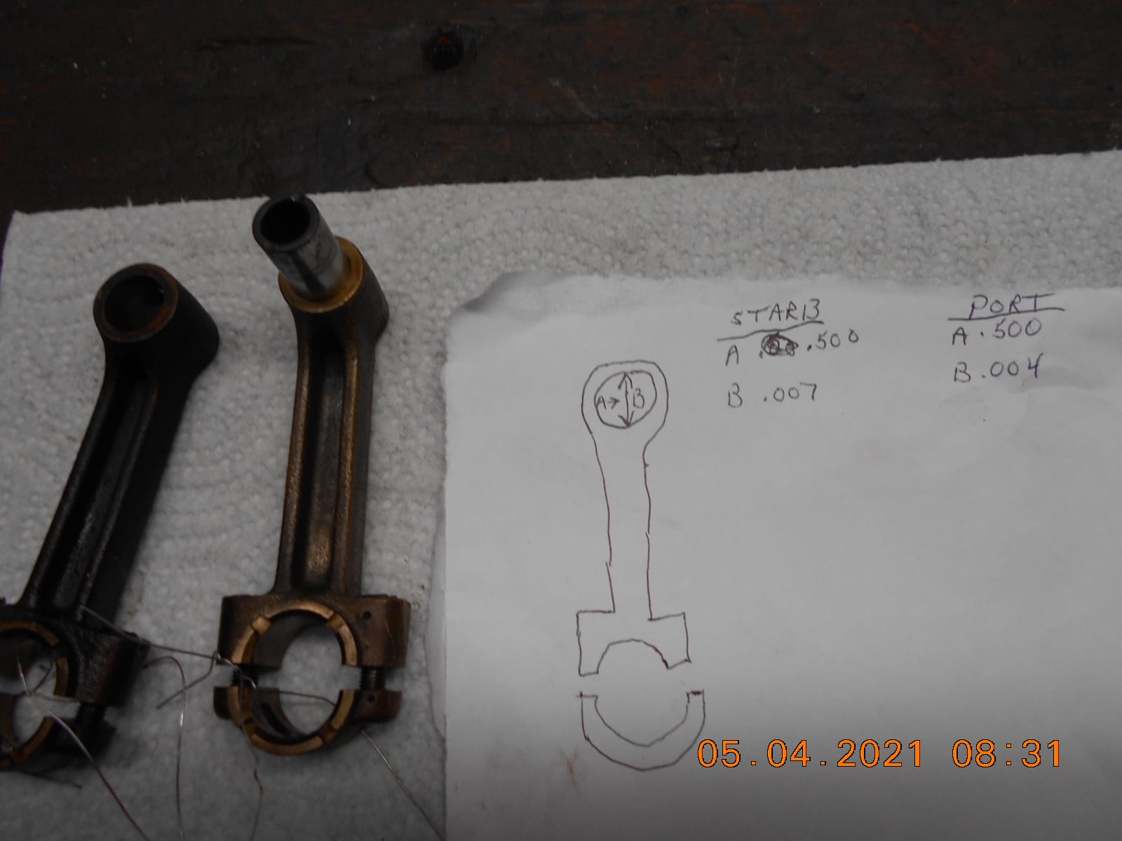

      Is there a “Wrist Pins R’Us” store where a person can
      order oversize wrist pins as needed?
      It seems engine machine shops are few and far away
      in this neck of the woods.
      The little 4 hp, 1937 Viking, Opposed Twin I’m working on could
      use oversized wrist pins, as the bronze rods are worn
      elliptical where the pins go thru. Not a ton of meat
      in the rods to bore them out and insert a bushing,
      unless it was a very thin one, and then I’m not sure
      what would be suitable.
      I haven’t found a resource online as of yet.
      Thoughts? Thanks.

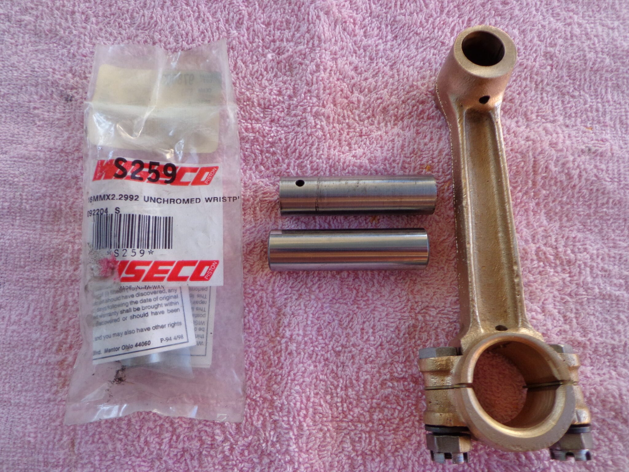

      #238555
        I had the same wear problem with my Koban rods but I did find slightly larger O. D. wrist pins and had both the rods and pistons honed to fit. Can’t remember how I found them but I probably Googled the size of the originals.

        #238575
          Mumbles, it seems I have a least three options, different rods, wrist pin bushings installed
          in the rod, or oversized wrist pins.
          My wrist pins are .500. I Googled until I was blue in the face trying to find oversized pins
          that might work, then last night I thought “metric”.
          There are some 13 mm wrist pins “out there”, and the conversion tells me they about .012 oversized,
          which would rid the .007 “out of round” in my worst rod.
          (13mm= 0.5118110in)
          Only problem is if I can find someone to perform the honing. I have some adjustable reamers,
          but not sure satisfactory results would be obtained.
          I’m still pursuing all three options.
          I ended up ordering some rings from “Greece”…….. gave up on Dave in Pennsylvania after
          trying to contact him three times.
