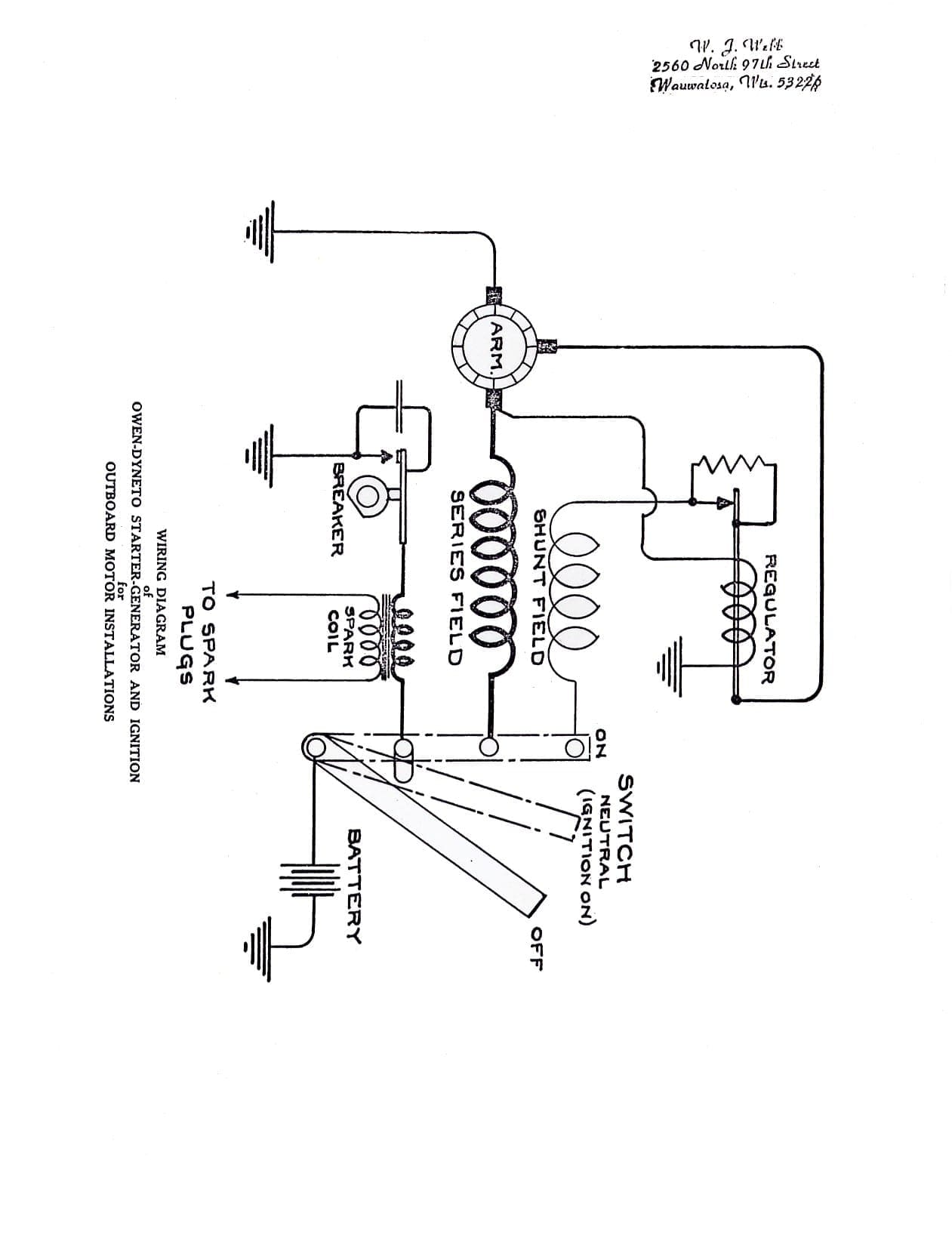

        Also need the actual wiring diagram for battery and switch. PO bypassed the switch for some reason and I’d like to hook it back up. Not sure why they did this because it’s just a simple slide type 3 position switch (I think) nothing to really break or go bad. I just touched the battery cables to a lawn mower battery and it turned over. (After spraying penetrating oil in the cylinders)

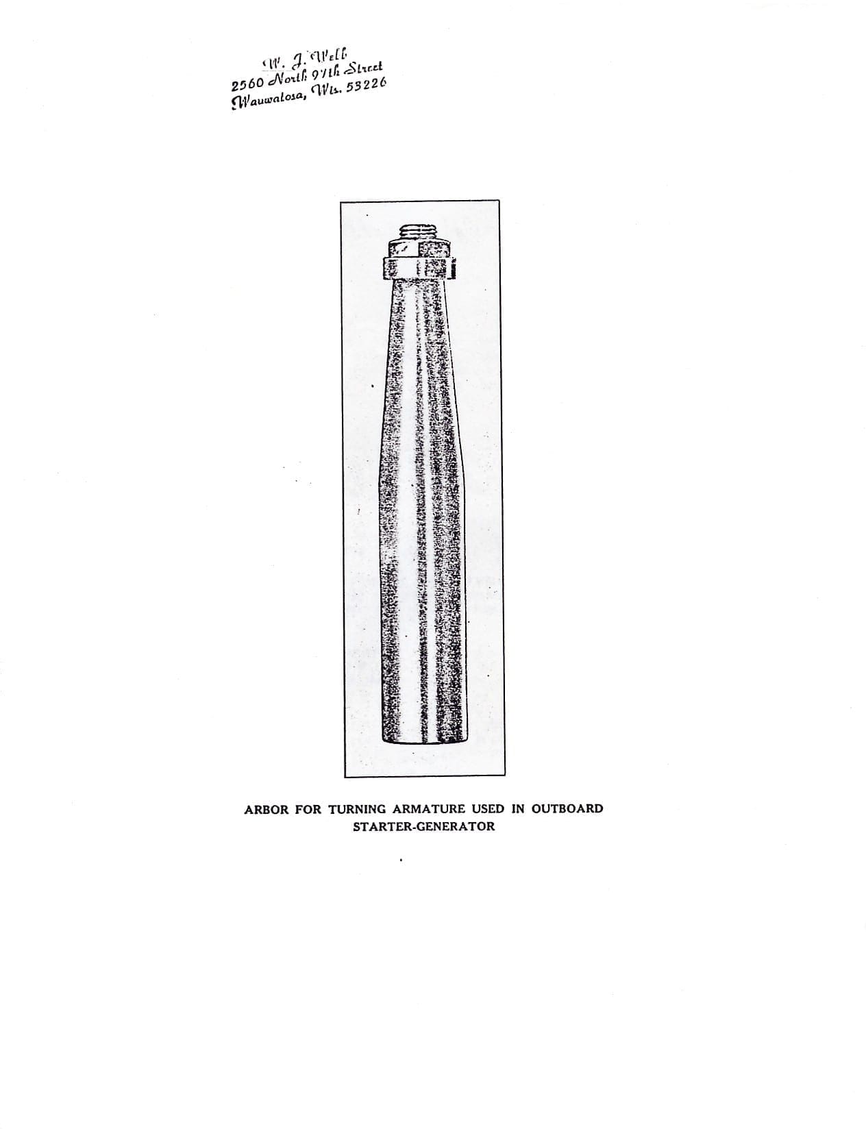

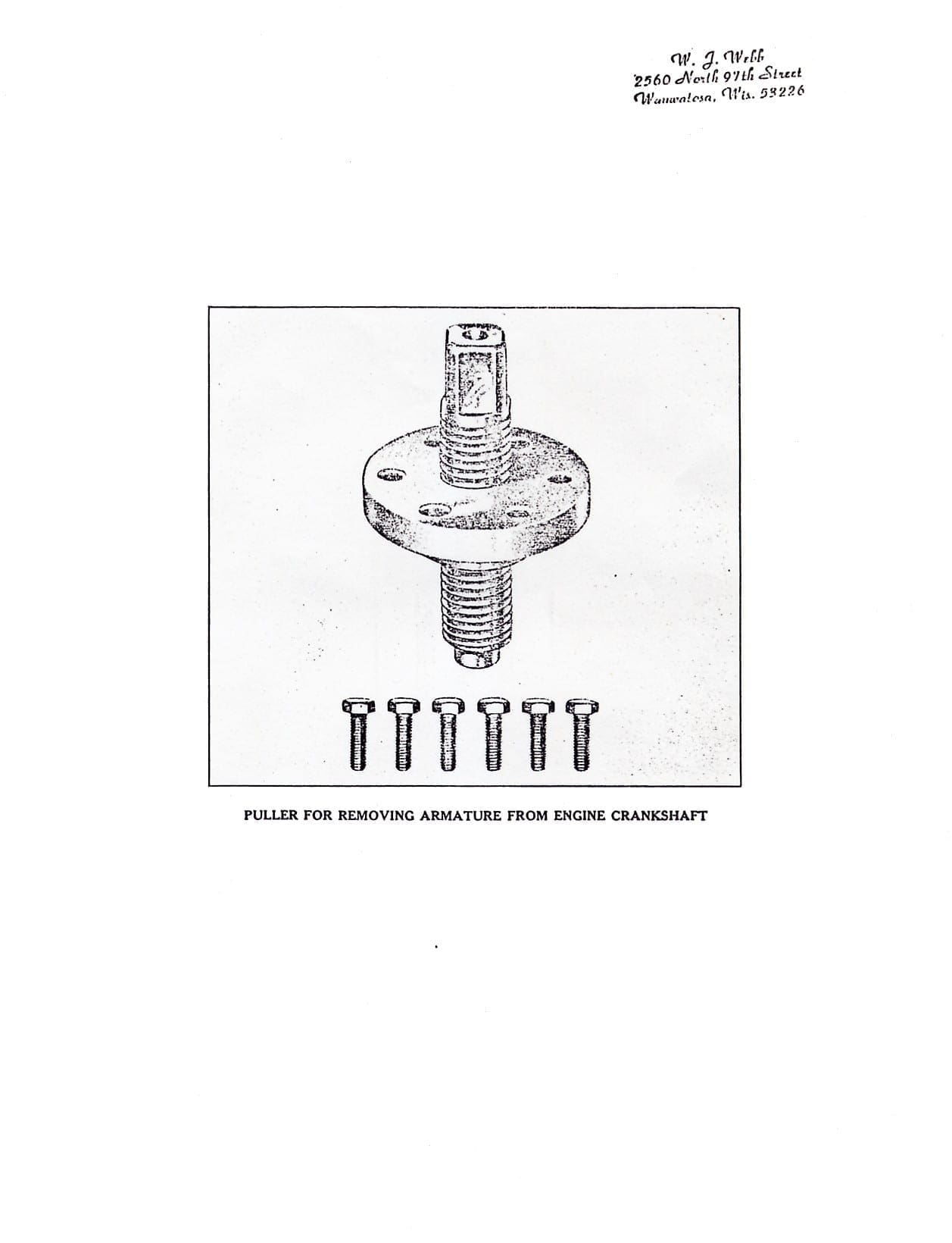

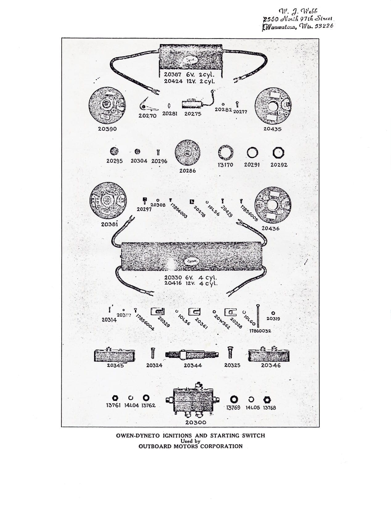

        #181168
        outboardnut

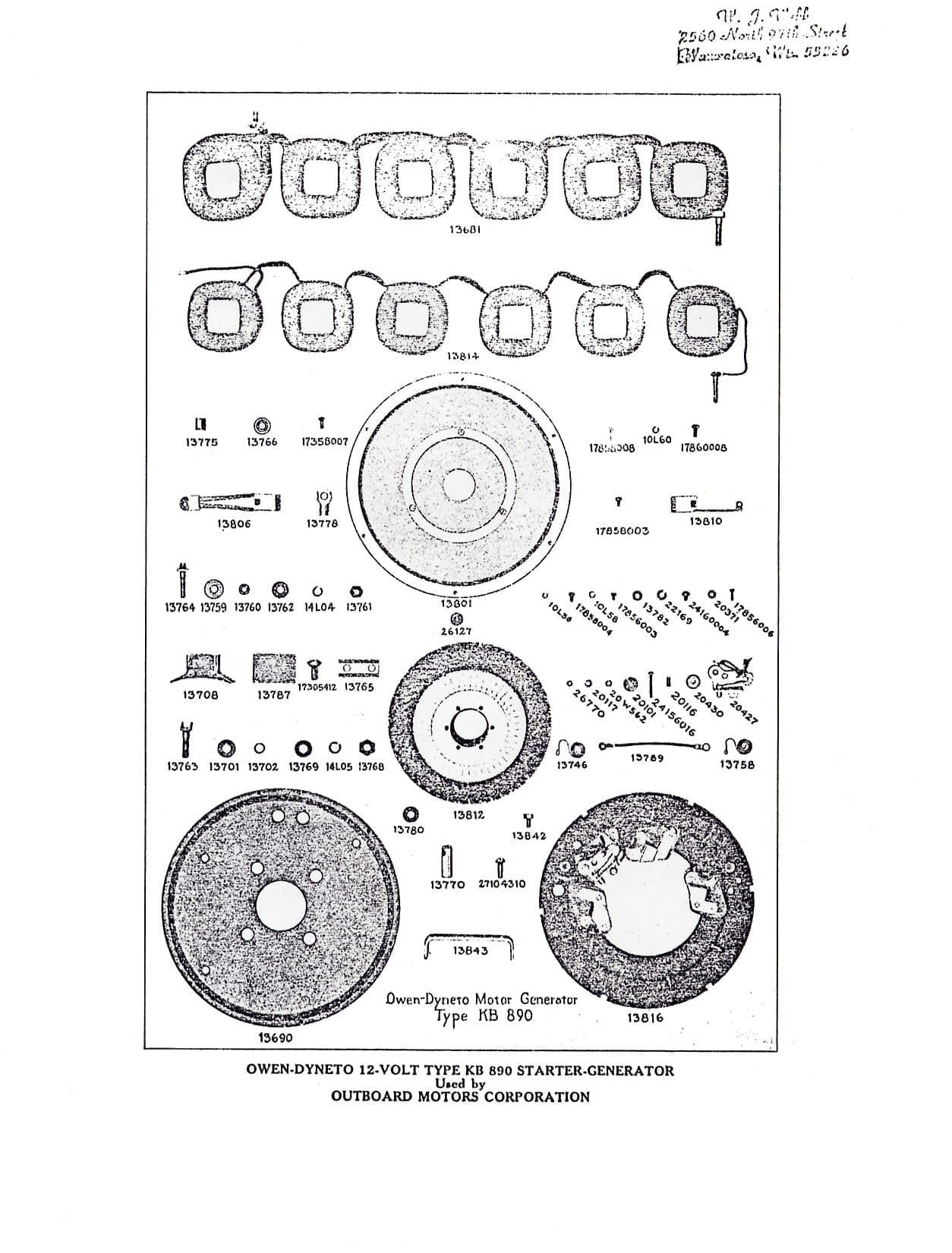

          does this help?
          p1
          p2
          p3

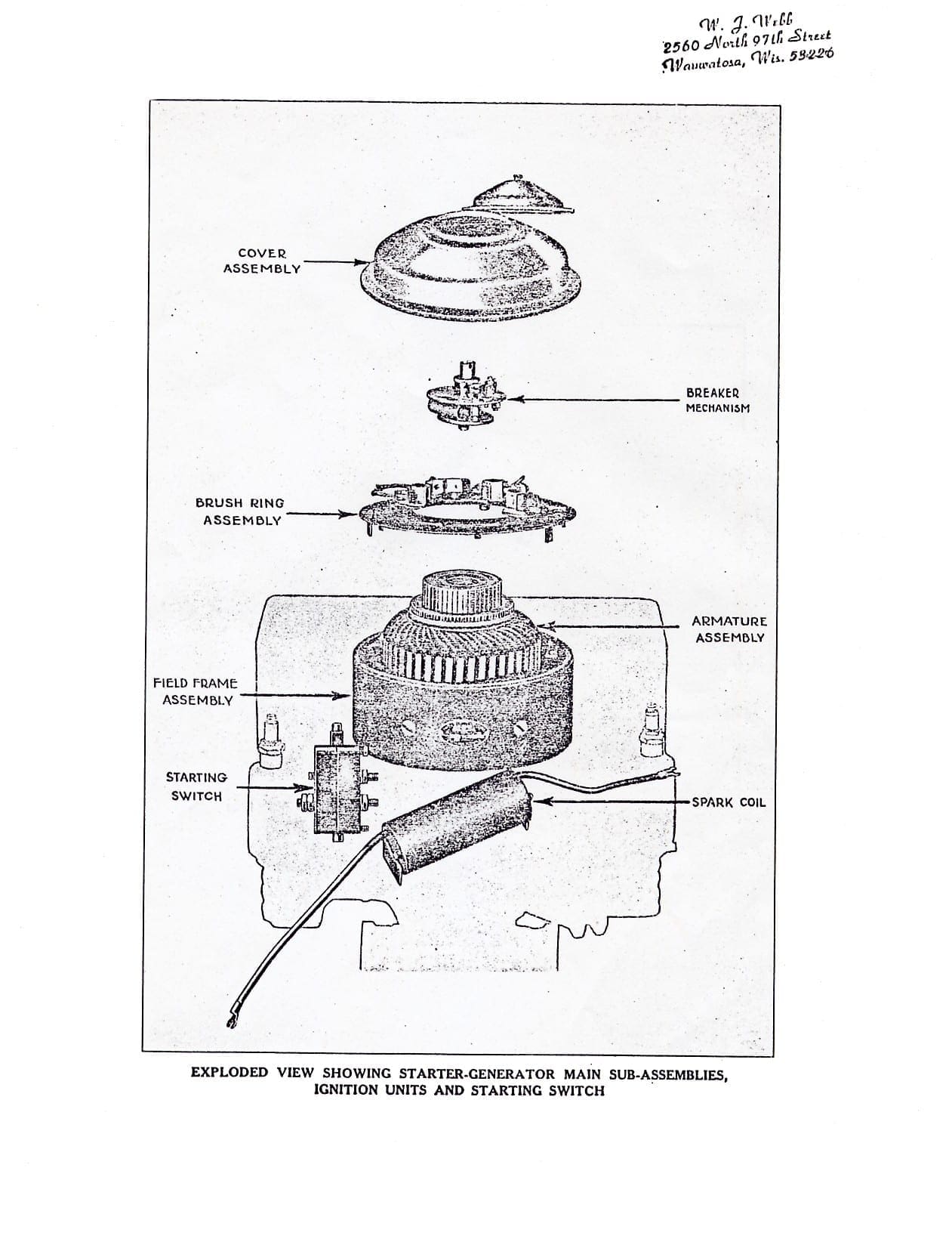

          #181173
          outboardnut
            p04
            p05
            p06

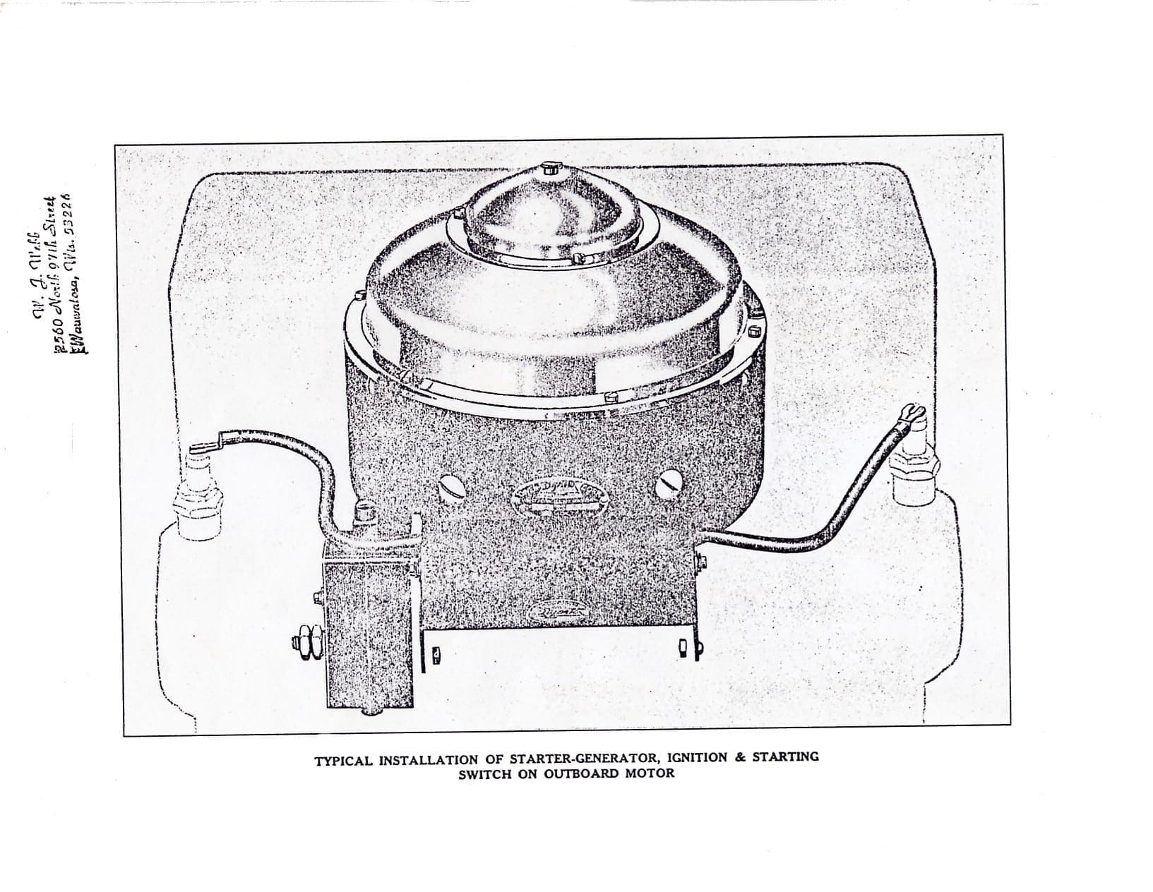

            #181178
            outboardnut
              p07
              p08
              p09

                  tinkerman
                    It’s definitely a starting point. The naked wires I was referring to are on the brush ring assembly. as I said I ordered a military coil to rebuild the coil what is difference in 6 volt-12 volt? The parts list shows one for 6 volt and one for 12 volt application Once I get home I’m hoping I can look at the wiring diagram and make heads or tails of it. It IS a 3 position switch so…… OFF- ON and START so another question, could I start the engine then move switch to ON and eliminate the starter motor turning all the time at low rpm’s (seems it would last a LOT longer if this wasnt happening)
