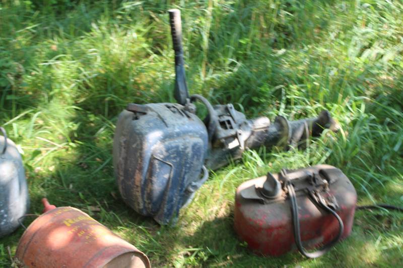

      Hi everyone, I am new to this forum
      I’m trying source color and availability of paint for a Fleetwin 1955 7518
      I recently inherited a this little gem.
      Seems mechanically sound but will need so cosmetic work to be presentable
      Thanks for your help

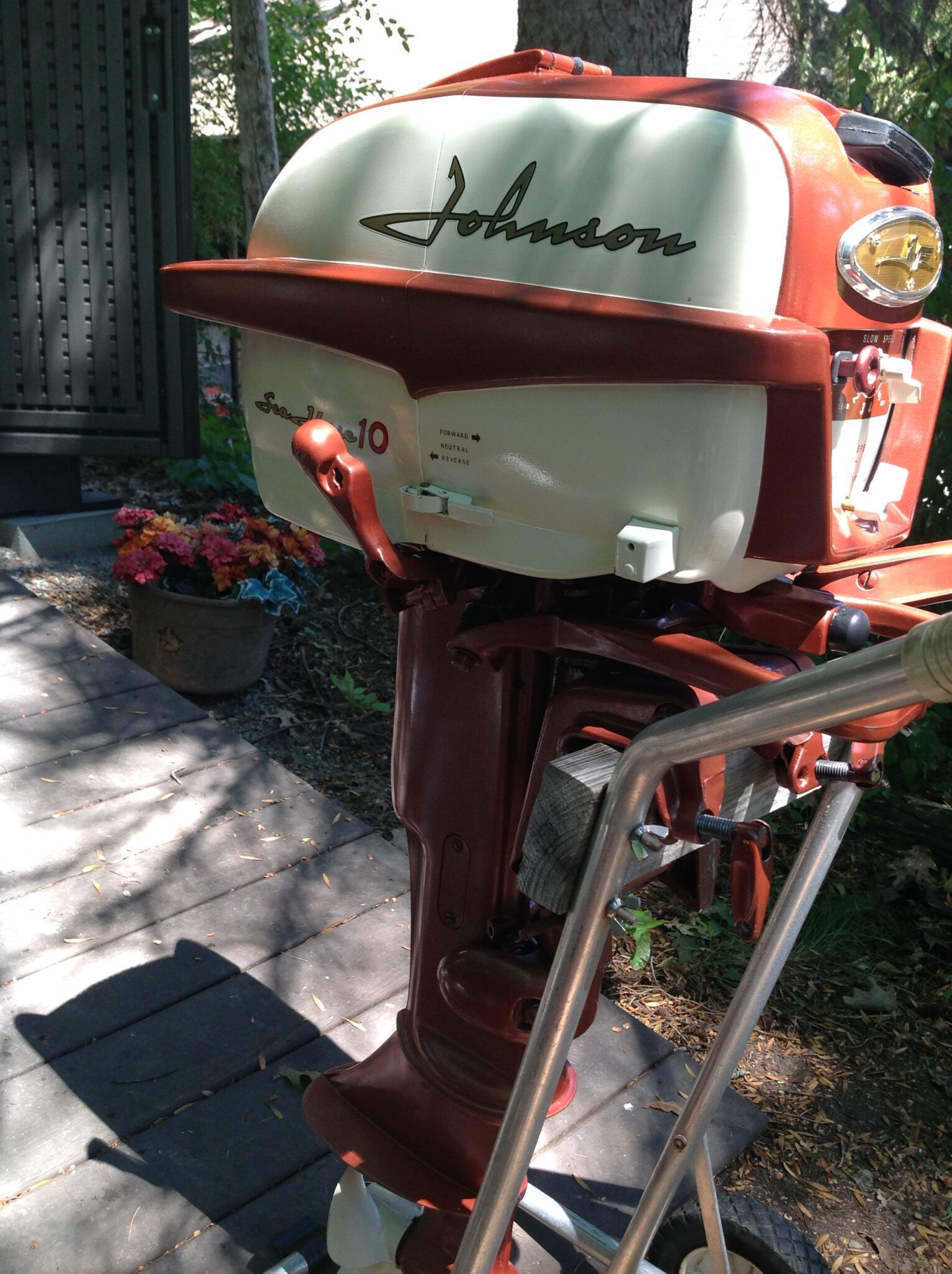

              Here is a picture of a 1958 Johnson 10HP that I restored using the above method.
              Hope this helps,
              Bob D

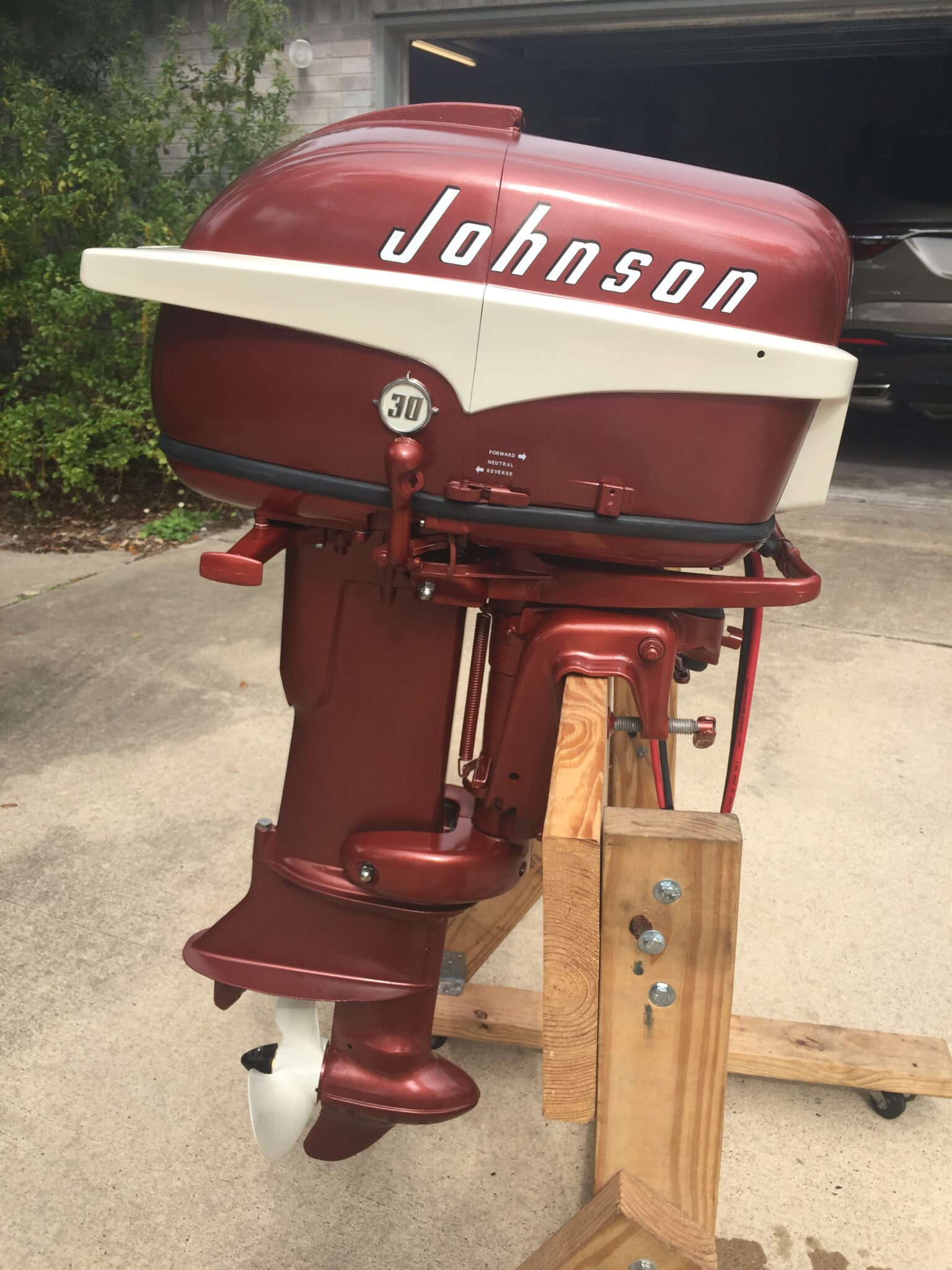

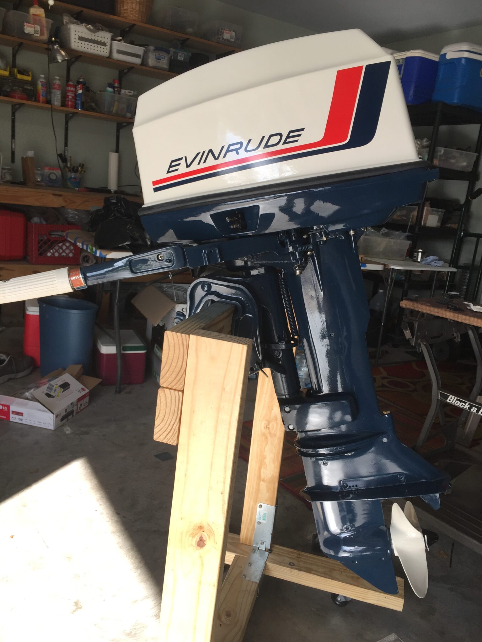

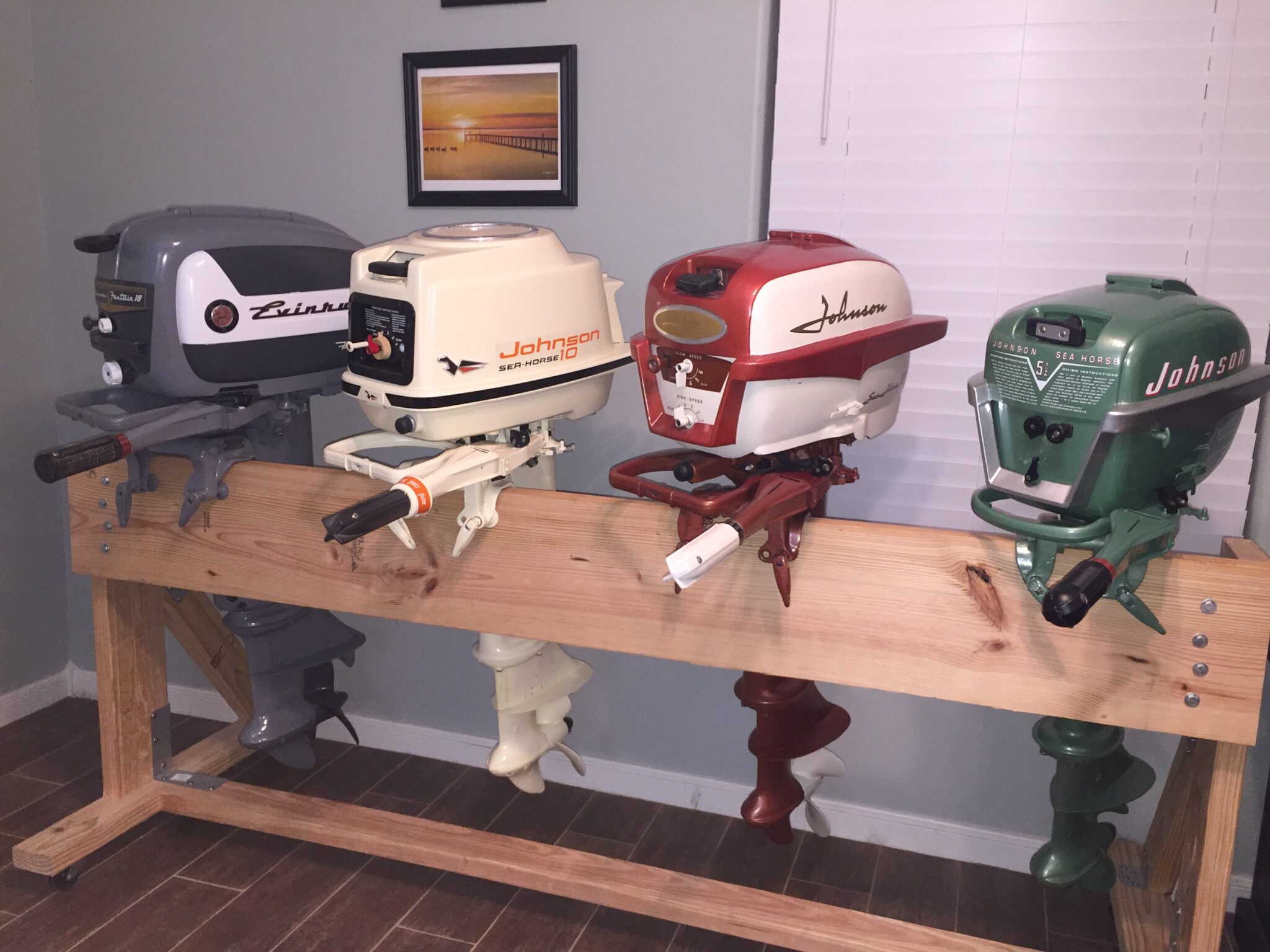

                I typically do complete mechanical and cosmetic restorations and tear the motor down into pieces as part of that process. While torn down in pieces, I’ll strip the old paint to bare metal using glass bead or soda blasting, which doesn’t etch the metal like sandblasting. Never done it myself, but others have used walnut shells for blasting with good results. After blasting and a thorough cleaning, I’ll use a good quality self etching primer followed by color coats.
                I have typically used paint and decals from North York Marine on my projects. As Bob D noted, I also use the 3M fine line tape for masking edges between different colors and I don’t use a clear coat over the final color coat. As Bob D also noted, 95% of the job is in the prep work.
                Here’s some pics of my projects. Note on one of my Evinrude restorations, I chose my own gray color scheme rather than the original factory blue.

                        they all look great!
                        That green Johnson is striking.
                        Struggling how far I want to take this project its a slippery slope in the end I will probably bite the bullet or regret it
