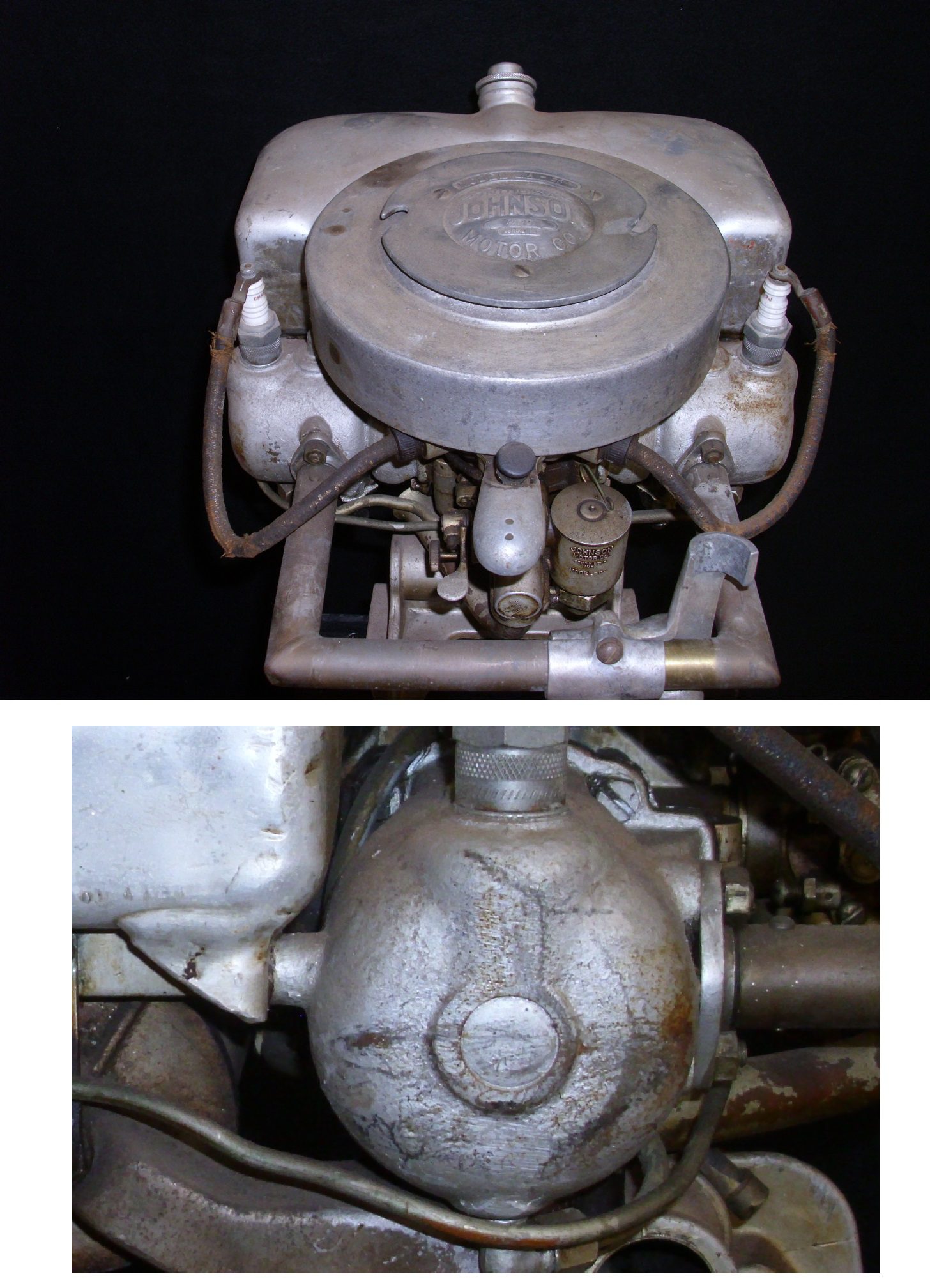

      #290197
      GARY
        That’s a good question!I always thought all of  the early A models had nickel plated cylinders.However,this picture of a unrestored 1926 A25 shows painted cylinders.I’ve never seen any with painted water tubes.They are either plated or plain aluminum.

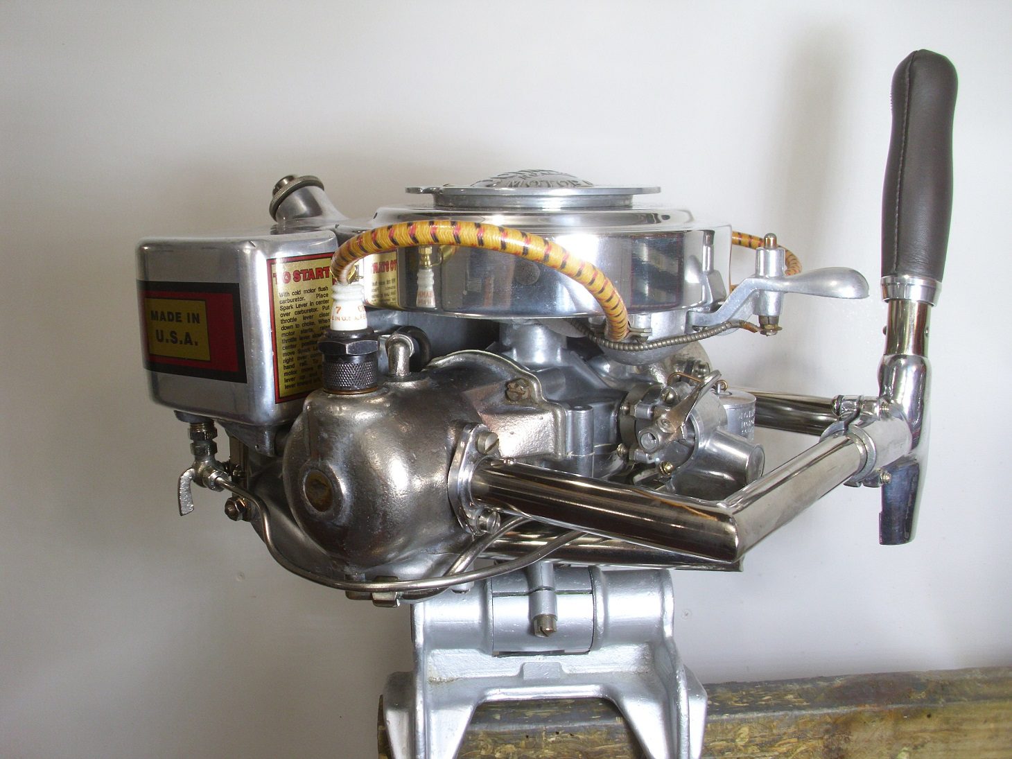

        #290201
          Not even close to being an authority. My experience with the ones I’ve had – if its brass, (screws – nuts – bolts) it was nickel plated. Copper water lines, fuel line’s, and brass fittings, were nickel plated. Water pump nickel plated. This 1923 I had, that I believe was original, still having the original plug wires,  had nickel plated cylinders. Nothing painted. Although I’m struggling with it, search you tube for nickel plating. I have only tried to do small (brass)  stuff. No cylinders.   Tubs.

          #290208
          GARY
            Your 1924 model should have plated cylinders.I mentioned the 1925-26 models having some with painted cylinders because it was unexpected to see on an original motor with them.(Also with original 9mm grey rubber plug wires and original AC “G” spark plugs)If the color on yours matches,it’s possible it was “restored “ with factory paint.

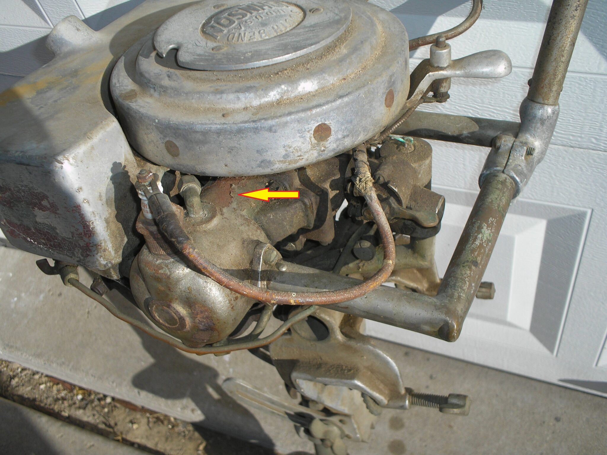

            #290217
              I had a 25 that also look like it was mostly original. I don’t have a lot of pictures of it. The cylinders don’t look plated in the pictures I have. Again, I’m no expert. Only what I have experienced.    Tubs

              #290224
              eltoquad
                I have heard of dealers cleaning up and repainting trade in motors. Even painting them the green Johnson started  using in the early 40’s.
