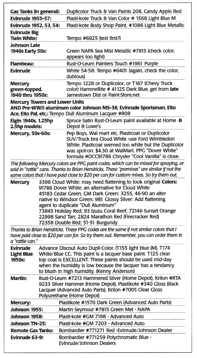

            This was posted here years and years ago but I can’t remember who did it.
            Spray-Bomb-Paint-Codes
