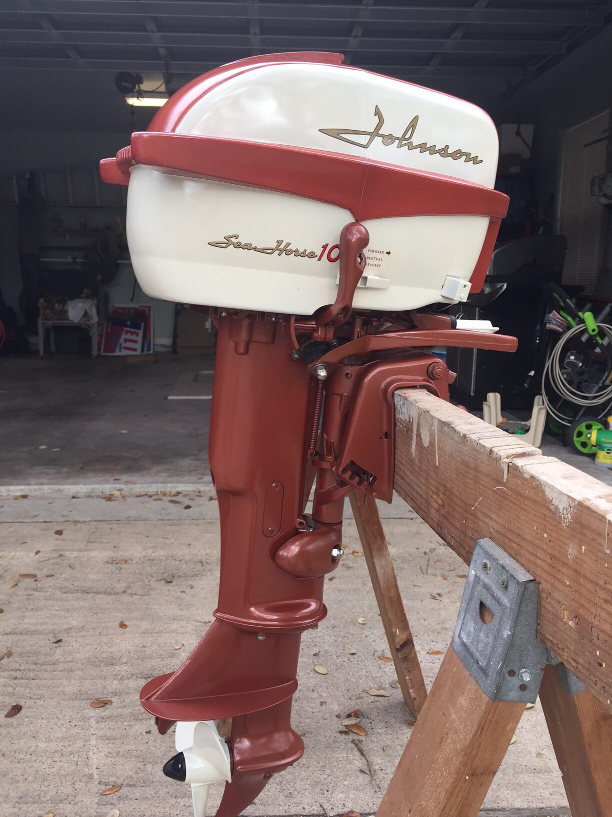

'53 Sea King 3hpMarch 8, 2023 at 1:29 pm #273576North York Marine and Vintage Outboard Paint both have the original factory colors available. Both place offer high quality paint. Here’s my 1958 QD-19 done with NY Marine paint – they also have the original factory decal sets.

"Every time you remove a broken or seized bolt an angel gets his wings."March 8, 2023 at 1:47 pm #273578Thanks! That is one great looking machine! Did you use a clear coat of some type on top of the decals?

'53 Sea King 3hpMarch 8, 2023 at 1:48 pm #273579Also- Did you use a primer, and if so what kind?

'53 Sea King 3hpMarch 8, 2023 at 1:55 pm #273580I bead blasted everything down to bare metal, then applied a self-etching primer followed by the color coats. I typically let the paint cure about a week before applying the decals. No clear coat over the color coats or decals.

'53 Sea King 3hpMarch 8, 2023 at 9:56 pm #273625Bobs- nice job on the paint. Did you use rattle can or spray gun?
March 9, 2023 at 12:01 am #273627I typically use rattle cans from Peter McDowell at NY Marine. Here’s a shot of a 1956 30hp I did with the his paint.
