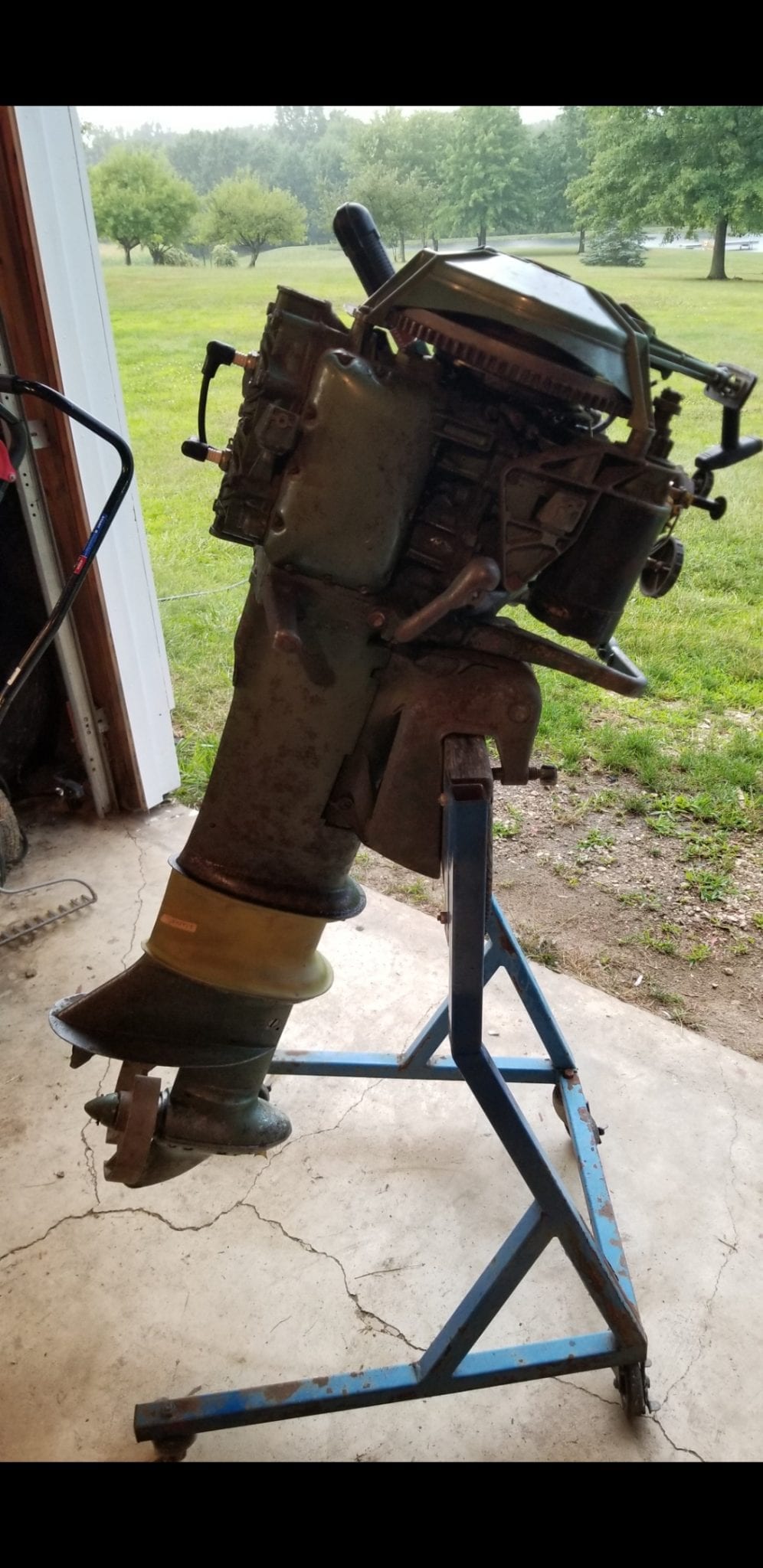

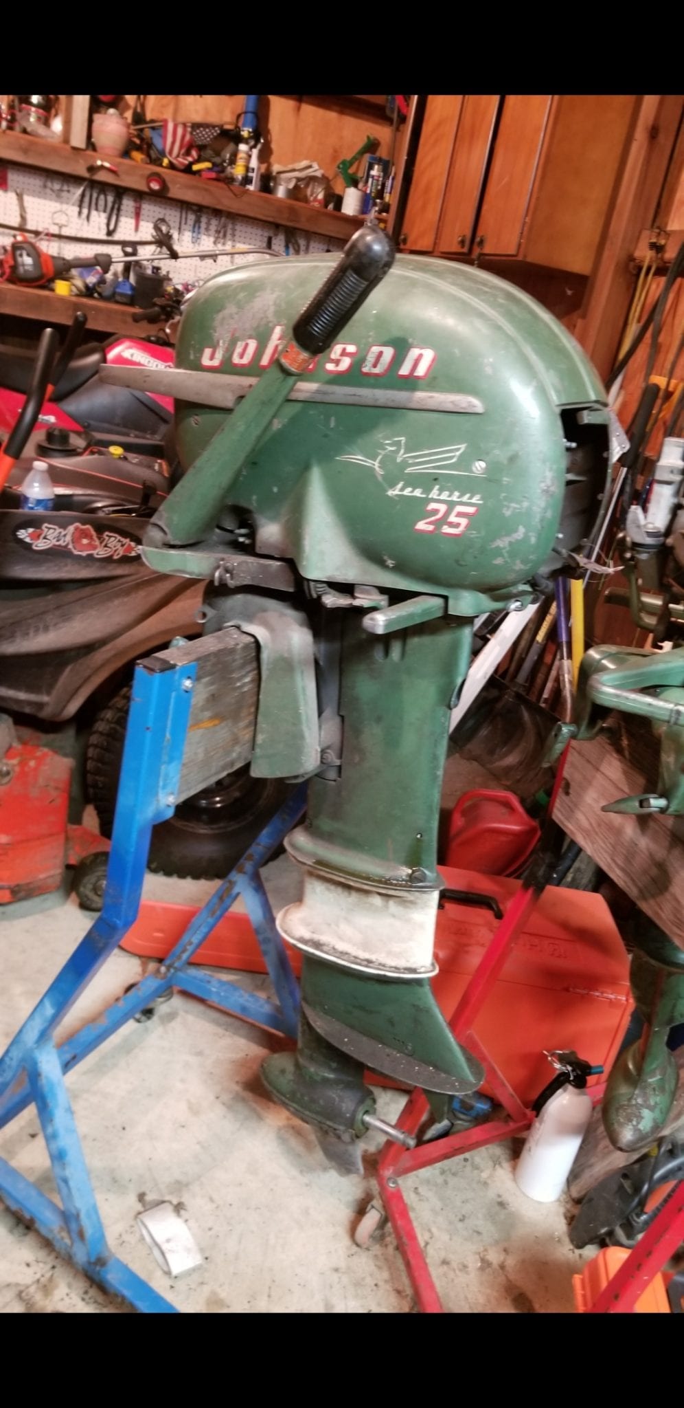

      I am slowly progressing in restoring 3 RDEL-16’S and 3 RDEL-17’s and my next step is to strip the paint off all of them and I have a couple of questions.
      1. I plan on using a soda blaster, how do I clean the surface after blasting so no soda is left?
      2. Should I cover all the openings of the powerhead very very well? I was thinking of making an aluminum plate to cover the powerhead base and carburetor opening and using the old gaskets to seal since they will be replaced anyways.
      3. I know sand blasting is bad for aluminum but are there any better options than soda? I know soda works but it is cheapest near me and wonder if paying a little more for nut shells would give better results.
      As always, I appreciate the help and here’s a few pictures of my RDEL-16s, the one with the covers still on is going to be left original and cleaned thoroughly.

        1. After blasting, I typically wash thoroughly with warm water and Dawn dish wash soap, followed by a thorough water rinse. Before painting, I then thoroughly clean all surfaces with acetone or spray gun cleaner.
        2. I usually just hand clean the powerhead as I don’t want to risk getting blast media inside the engine. I suppose putting a piece of plate material and a gasket over the base and carb openings would work.
        3. I’ve used both soda and glass bead for blasting but walnut shells also work very well.

            I first clean the powerhead with a degreaser, then go over the whole thing with small wire wheels in a dremel tool to remove any loose paint. Then do a thorough clean with aerosol brake cleaner. The aerosol spray works well at getting into all the small nooks and crevices for a final clean. Somewhat tedious work with the dremel tool but it works for me.

              Awhile ago, I had an ’88 15 Johnson power head that was really badly corroded from a mouse nest. I made block off plates out of 3/4″ King Starboard, the white plastic material , for the carb inlet, base gasket area, etc., to keep out the sand. It is easy to machine and you then get to keep it for the next time…..
