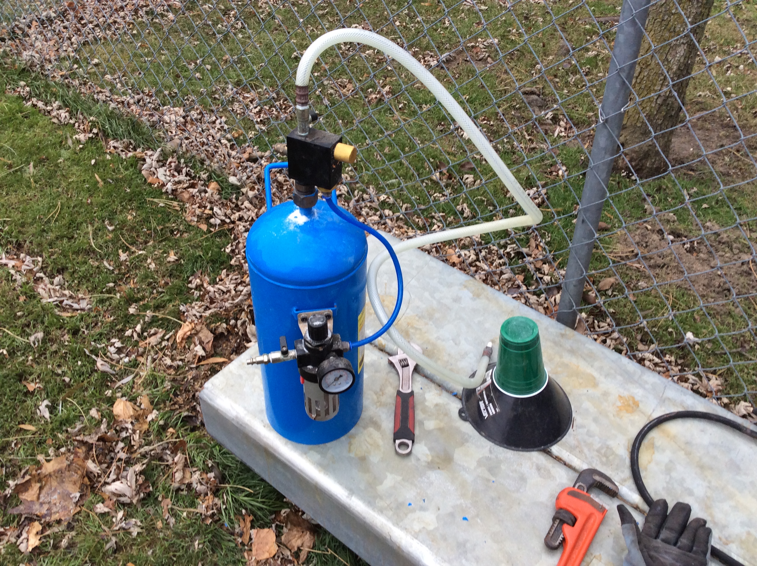

Not sure if this should be a separate thread but what about the equipment you all are using along with equipment specifics(40 psi cfm, 90 psi cfm), oil less or oil, and minimum pressure required for the different medium. The reason I ask is that harbor freight has an oil type compressor(10 gallon tank, 2 or 2.5 HP, 5.5 CFM @ 90 PSI, 6.2 CFM @ 40 CFM) for sub $200 without coupons. HF also carries 10 and 40 lb media tanks plus the 100 lbs. The question is. Can or does anybody use this size equipment to media blast outboards successfully? I figure that with coupons that I might be able to set up the compressor,10 or 40lb tank (what do you recommend for best pressure control), and a cabinet. Plus there is a soda valve that can be put on the sand,etc tank for an all in one media tank. Cost estimate is $400 versus $1000 for high CFM (8 and above ) compressors. As a side note, I also plan on learning the spray painting after I perfect paint stripping. Thank you for your feed back on this.

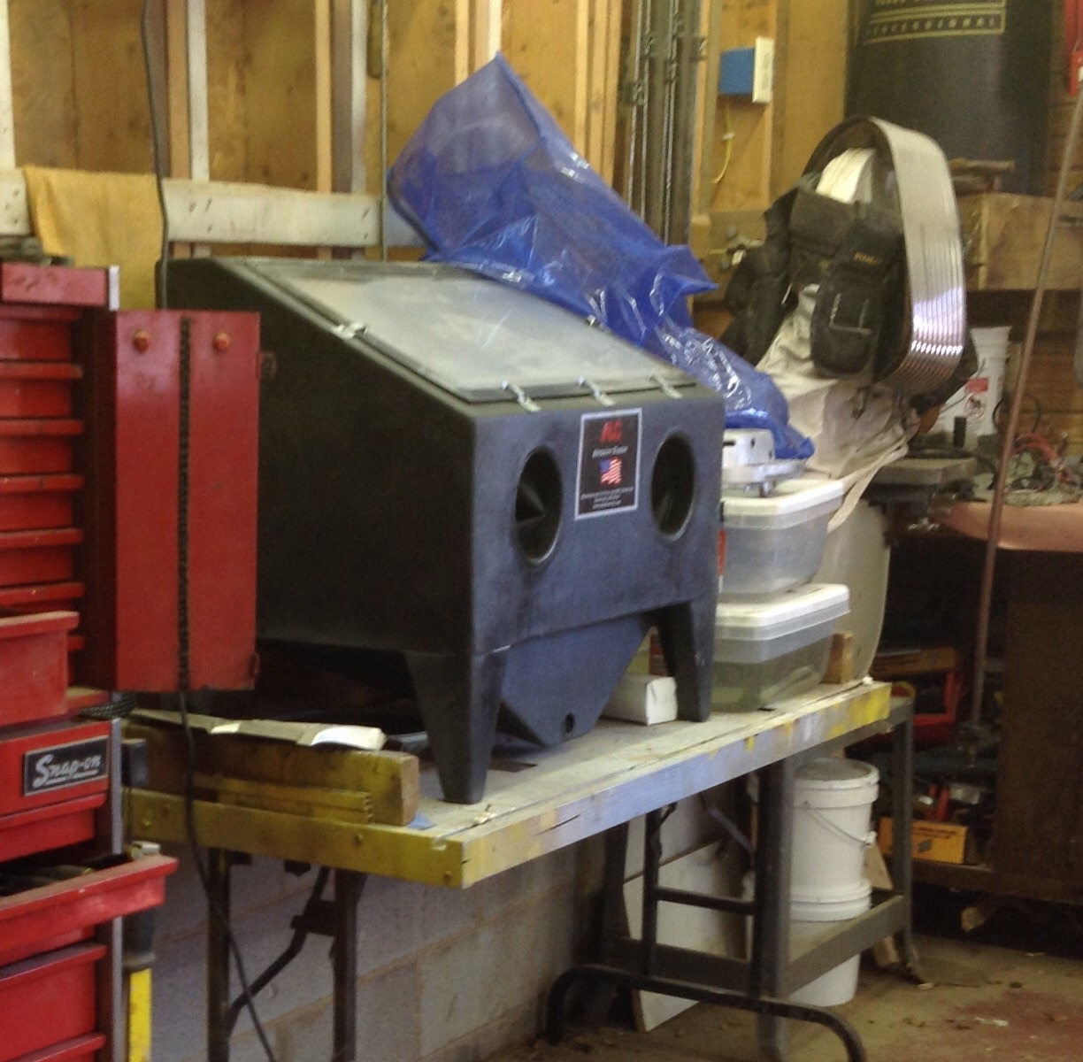

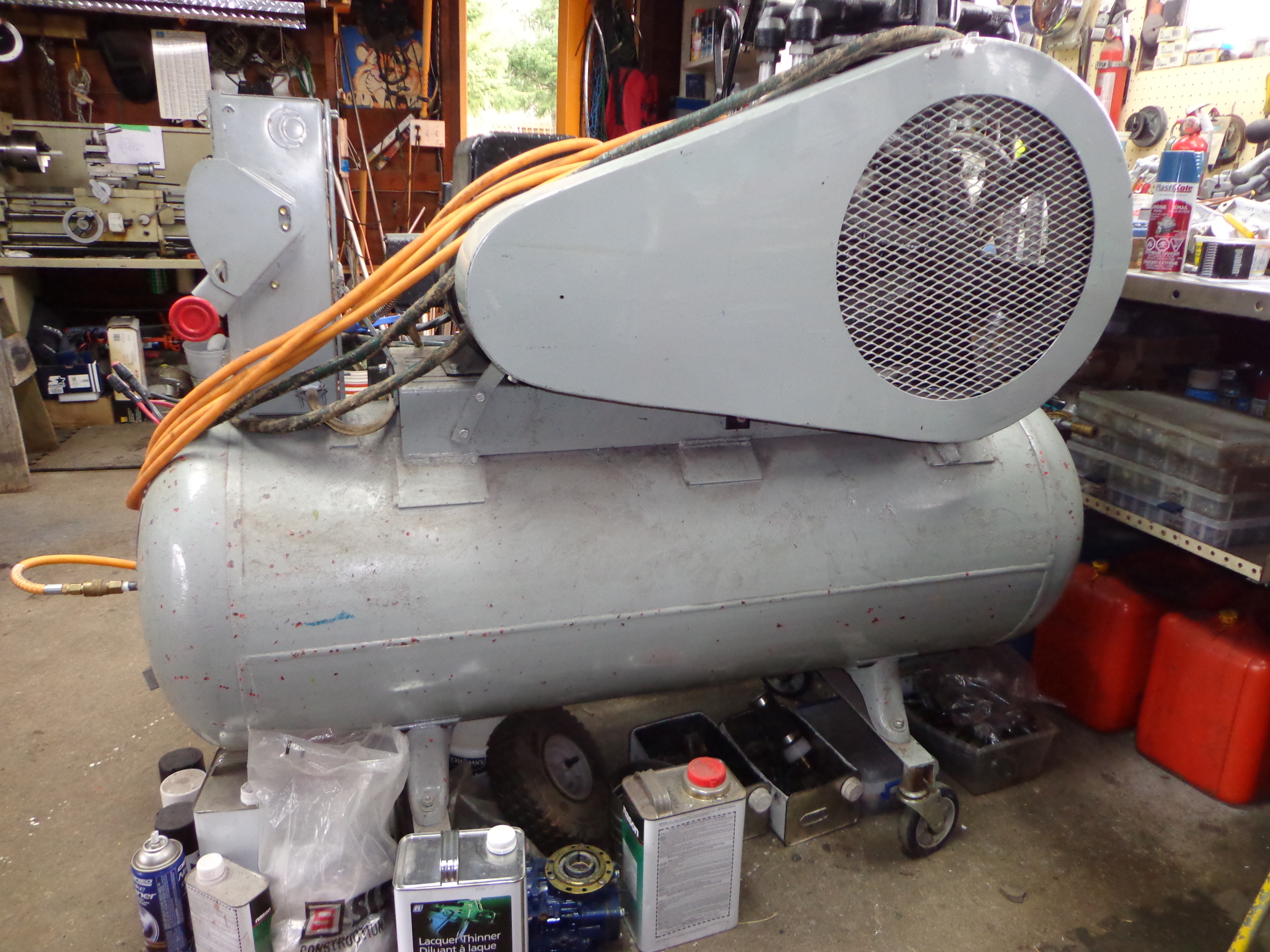

February 13, 2016 at 4:10 pm #31885February 13, 2016 at 4:36 pm #31887I use a blasting cabinet and plastic media to clean my Merc aluminum parts. With lines, hoses, air dryer, etc the media blasting cabinet ran about $400.00. I have an 80 gallon compressor and it can’t keep up with constant blasting.
As I understand it you can’t use soda in a blasting cabinet, ergo the soda material is a one time use.
February 13, 2016 at 5:43 pm #31900Blasting, Painting, etc… you cannot ever have enough air! The important thing is the CFM at about 90 psi. Ideally, that will be over 10.
I have used my blasting cabinet with small compressors, but it just takes forever. You are constantly waiting for the compressor to catch up so you can blast another couple inches. Its frustrating. But can be done. IF it works in your budget, at least a 60 gallon tank, with enough hp to make 10 cfm at 90 psi is best.

This is similar to what I have, but not the exact same model, note 11 CFM requirement, I got mine at Tractor Supply Compnayhttp://www.jegs.com/i/JEGS/555/81500/10 … Ar6X8P8HAQ

I have the same cabinet as you. Same CFM rating, and I don’t think they make a 120V compressor that keeps up to it, you need to get into the 220V models like you posted. I was actually going to get the same compressor you posted as well, at our local Princess Auto (discount store similar to your Harbour Freight) but the sales reps there actually told me to stay away from it, that almost every one comes back broken. So, I stuck with a more common name compressor.
I like using the soda for the powerheads, for the reasons you mention. Afraid to have a piece left behind. Soda is water soluable, so after I blast them, I wash them in my laundry tub, and then there are no worries about media being left behind.
