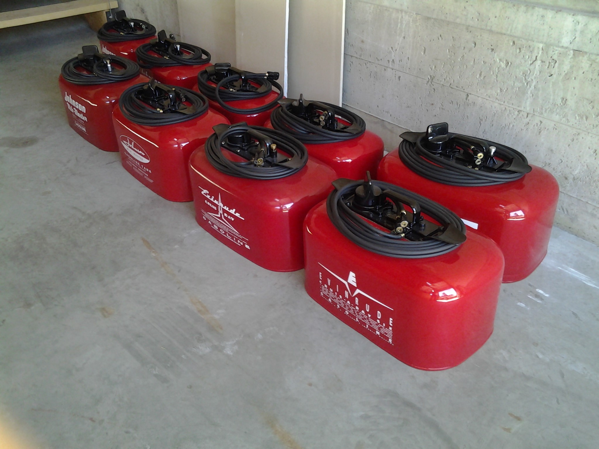

            #66463
              These tanks are painted with an automotive base/clear system. The red was matched from some rattle can paint I had and is close enough to the original Gas Tank Red for my liking. OMC ’59 and later tanks were painted Cavalier Red and is more of an orange color the the earlier Gas Tank Red.
              #66464
              twostroke
                Looks NICE. Got any sort of a formula number for the red you used? Looks dead-on. Did you clear over decals?
