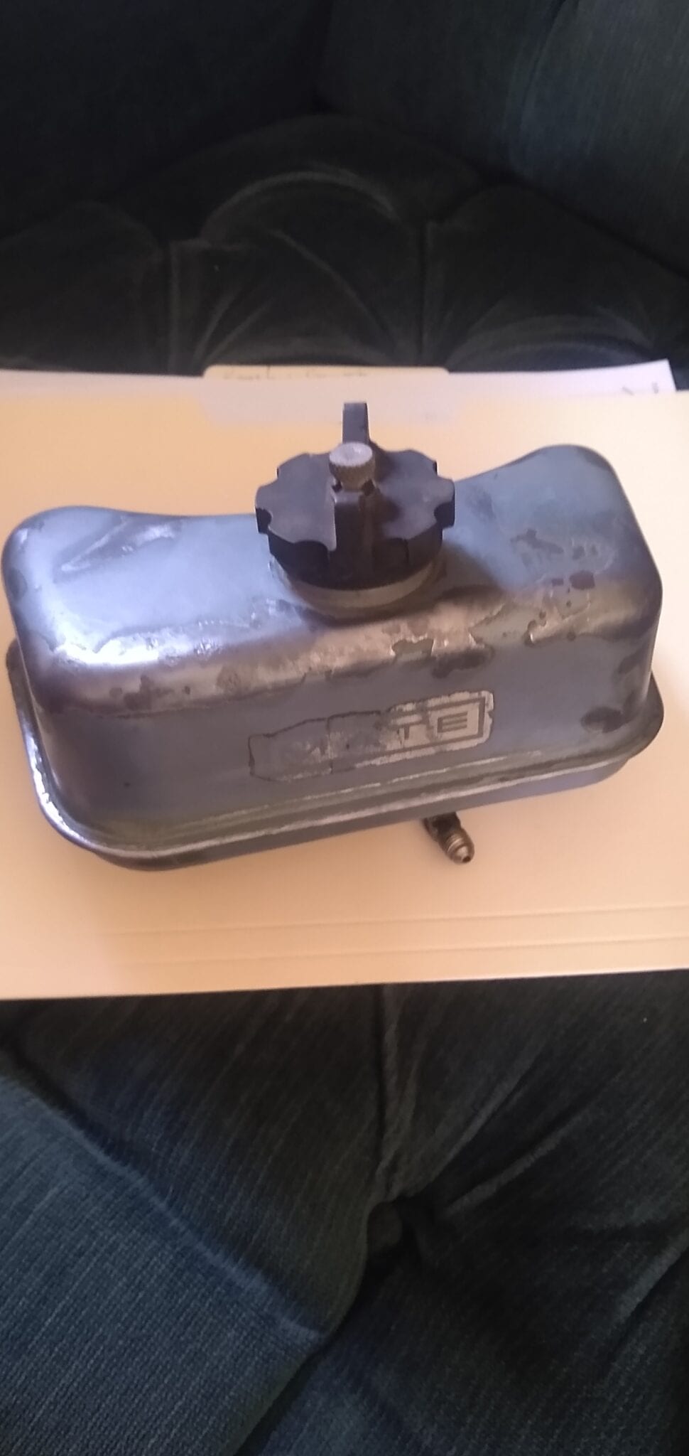

      Below the cap is the gas tank. This a ’68 Evinrude 1.5 HP. I cleaned the inside with gunk, shaken rocks, and a brush. The outside I used a wire wheel. Rustoleum paints the outside, does anyone paint the inside?
      #233214
      Timothy McDonald
        Outside paint is “dusty”

          I would not trust paint to stand up against the gas inside then clogging everything up. I have used gas tank sealer on several tanks and never had a problem
          #233220
          David Stanton
            There are a lot of products for coating the inside of the tank, most are targeted to the old motorcycle hobby, but also work for outboards. Run a web search on “gas tank sealer” and several should come up. Eastwood and POR-15 are common popular brand names.

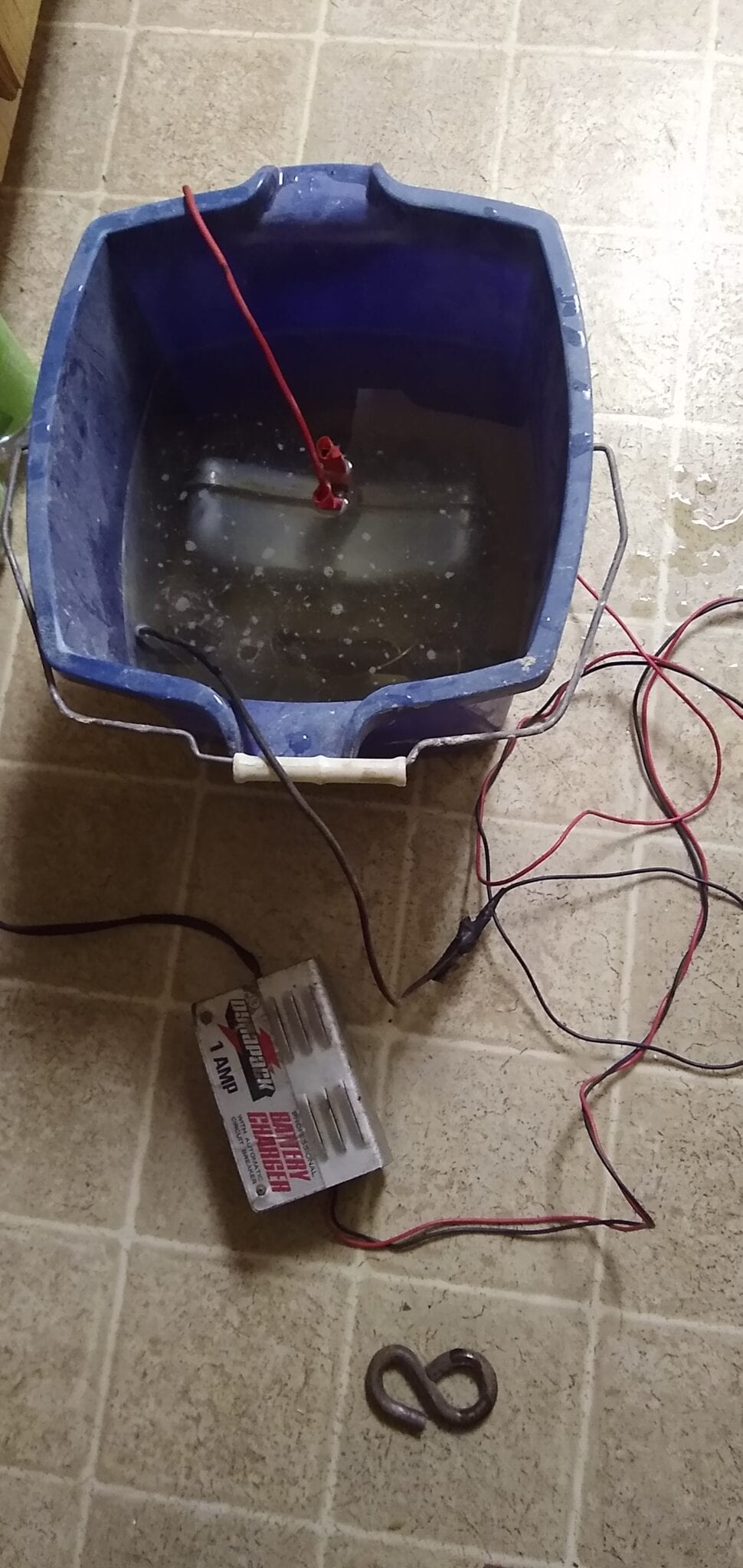

                      I’m using a 1 amp battery charger. Piece of iron pipe.. not galvanized. I’ll tell you in a few hours.
                      It’s been ten minutes. I had the battery leads backward. the positive is now on the iron rod. the negative now on the Evinrude tank. In just ten minutes the water was dirty and the tank was peeling paint.

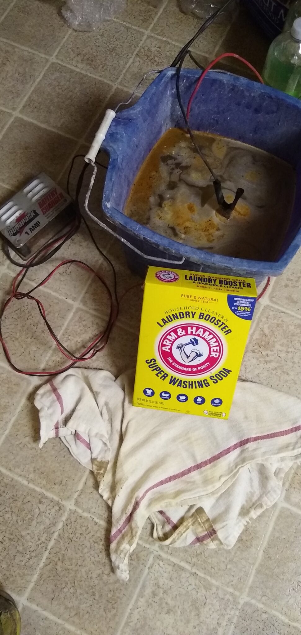

                        $4.12 at Walmart. Washing soda.
                        online: http://www.secondchancegarage.com/public4/gas-tank-cleaning-1.cfm
