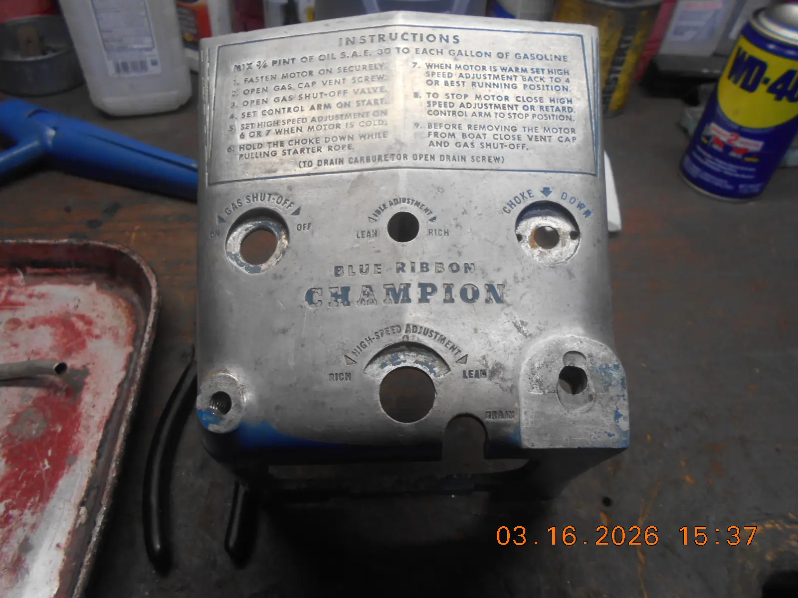

What would be your favorite method to redo this piece, and
repaint all those tiny words in “blue” paint?
Perhaps liquid paint would be better than aerosol spray paint?I was thinking maybe dab the paint in, then wipe off the surface quick with a sponge?
Then clean it all up with fine sandpaper.Prepare to be boarded!

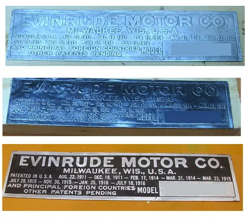

March 17, 2026 at 7:25 am #309927So, previously I would paint the whole dang thing, wait for it to cure completely then sand off the offending paint. Gets you a highly changed finish on the main part which may NOT be what you want.
Here is the challenge…If the lettering is not stamped with clean clear edges… the sanding of the part you don’t want paint on will show them and boy will it show them… I have also used a toothpick to “dab” paint into lettering such as that, VERY tedious and prone to mistakes…http://www.richardsoutboardtools.com

Richards method, as stated, works well with sharp edges(below) and should work on most of the lower part of your cover. Going by your picture, the letters look to be sunken in on the S&O instructions. Because of that I would approach it differently. First I’d want the part to be cold, to slow the paints drying time. I’d spray one section. Then, using a body filler spreader, I’d make a pass over the paint, wipe the spreader of on a paper towel, and repeat till I got as much paint off the surface around the letters as I could. At this point it should be evident how well this is going to come out, and if it is worth continuing. If it is, let the cover sit overnight. The paint will be dry, but not cured. Ball up a rag, tight, and adding just enough polish so its surface is just slightly damp, gently go over a section. It should be dissolving the remaining paint around the lettering but shouldn’t bother the letters. Then let the polish dry and buff it off. The polish with the paint should come off together. Remember Richards tooth pick trick.
March 17, 2026 at 10:54 pm #310096I would avoid sandpaper. Try putting a chemical that removes unprotected paint (like carburetor cleaner or WD-40) on a piece of paper towel and scrub with that to remove the new top layer of paint.

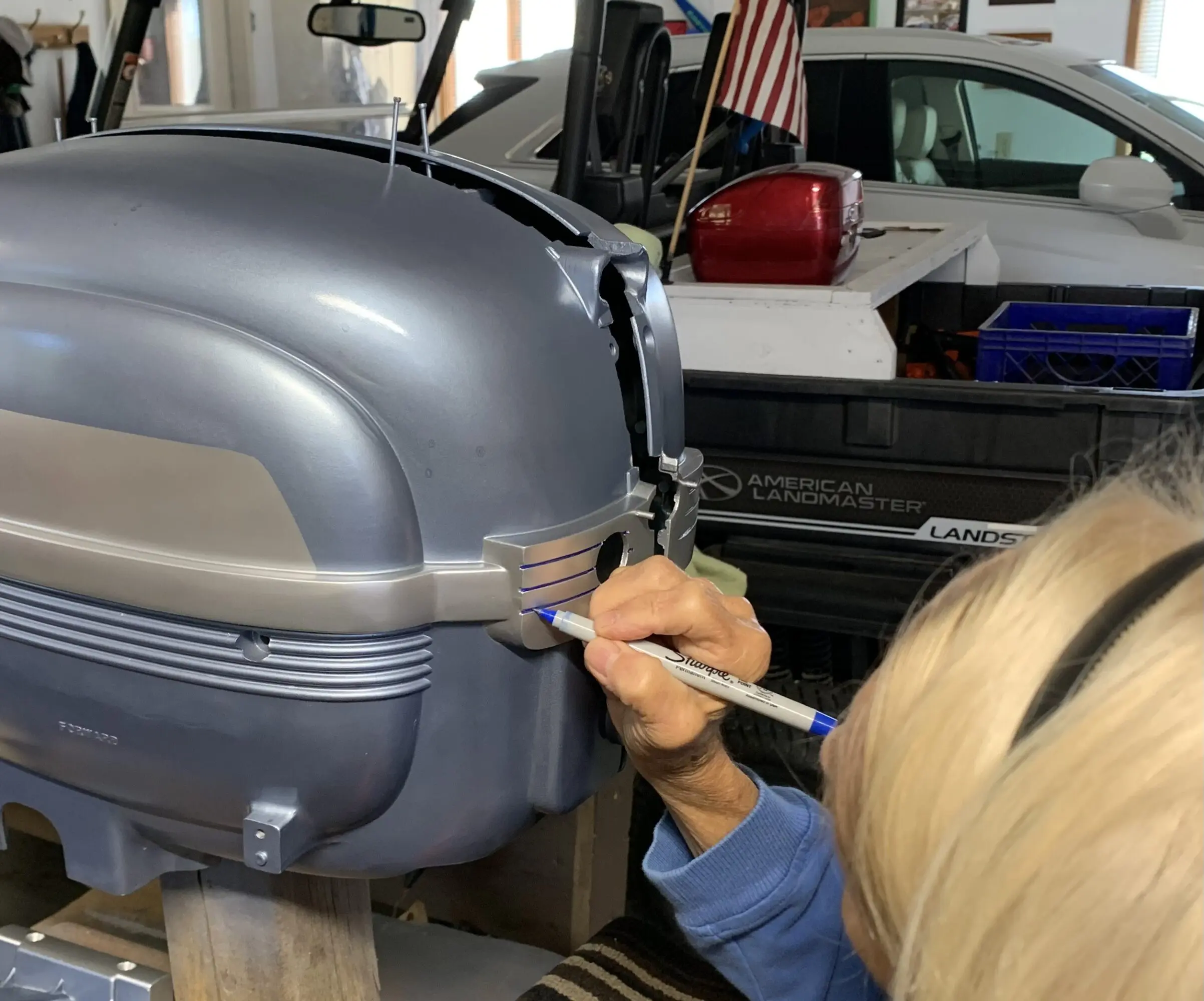

Thanks for the tips!I had my sticky fingers on a set of Ultra Fine sharpies today! They even had your blue color.
