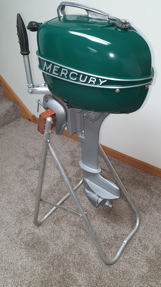

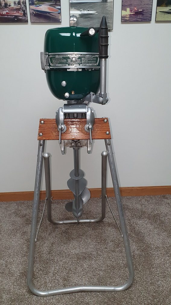

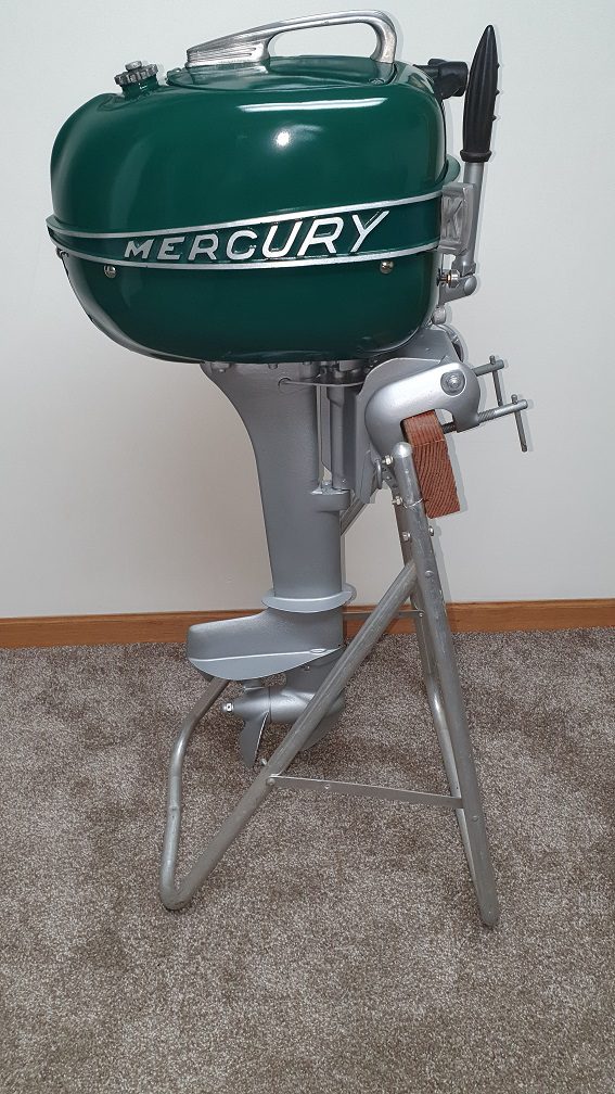

                  I finished my KE4 project…except for a couple very minor things to finish. I’m very happy with the way this paint job turned out. I used the Dupli Color for both the green and the cast aluminum and an etching primer for the whole engine. Nice and shiny..no need for clear coat.Dans-KE4-5-1

                  #257851
                    Very nice job!
                    1982 Evinrude 25hp
                    #257862
                      Dan, looks great! That paint flowed out nice!
                      When’s the test run video?
                      #257866
                        Teaching yourself how to achieve a good finish is a process of understand
                        the flaws and making adjustments. There is more to it than just applying the
                        paint. Some people never figure it out while others do rather quickly. I’d say,
                        by looking at your pictures, you have developing a good understanding of
                        each step as you have produced an excellent result.
