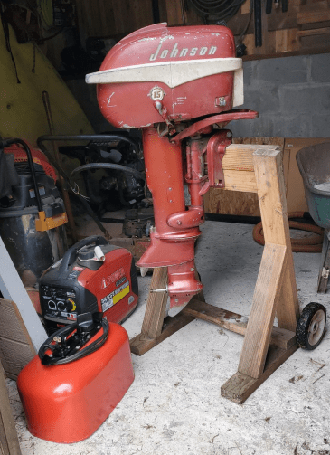

          LARRY CATON
            When I made some welding repairs to a transom clamp and an exhaust port, I used a citrus-based paint stripper.  At first it didn’t seem like it was doing anything, so I covered the area with cling wrap and left it overnight.  I couldn’t believe what an awesome job it did at lifting the paint.
            I have a chronic illness that saps my energy, so I’m looking for an easy way to spruce up my motors.  I just got my 1st motor running after doing just about every “regular maintenance” operation I could think of.  I’m eager to go for a boat ride, but eventually I’d like to repaint the cover and replace the decals.
            You can see my FD-10 is scratched and paint worn off on the corners, etc.FD10-in-shed
            Thanks for your insights!

            #295511
            David Bartlett
              I think that one has great patina and would leave it as is!

              #295514
              LARRY CATON
                Thanks David.  It certainly matches the 1961 aluminum boat it’s going on.  Portland, OR is sunny from about July-Sept so this motor can probably go another 50 yrs without much color change!

                #295705
                bill-mcnamara
                  Nice looking motor you have there, a gently used classic for sure.
                  I have had great success with “Maguire’s Ultimate Compound” on many of my 50’s motors, to revive the colour of  good original paint like yours.
                  Its very satisfying to resurrect original paint!
