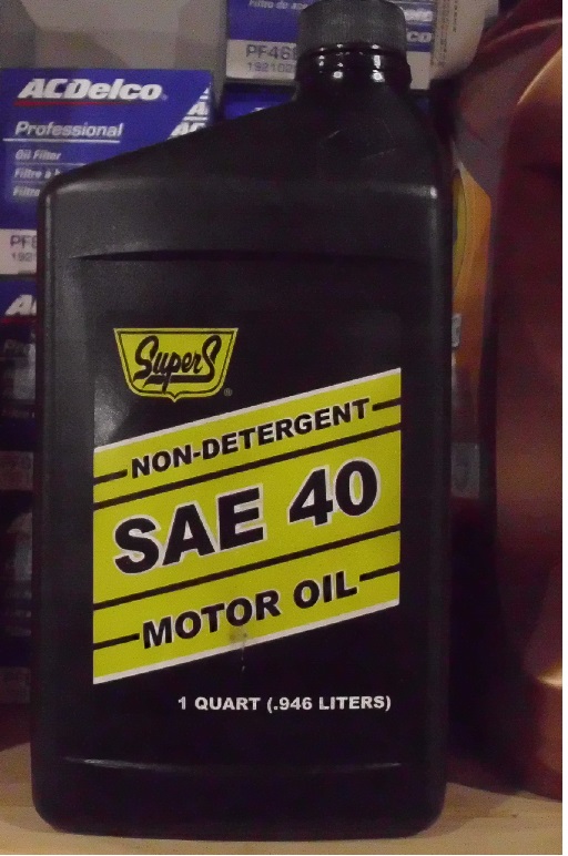

                https://www.agrisupply.com/premium-non- … l/p/28785/
                Only $2.99 per quart
                #77016
                amuller
                  Hmmmm 40 is different from 40W, meaning winter grade. The description doesn’t seem to match the pic.
                  i can envision that gear oil, with heavy anti-friction additives, might make those clutches slip. I think this arises with motor bikes with wet clutches.

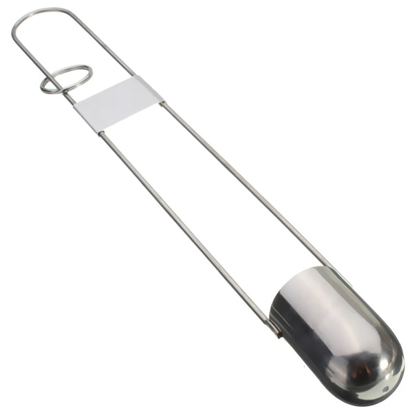

                      The number (Say 40) is the viscosity of
                      the oil. We needed to maintain it in some
                      of the coatings we ran using a Zhan cup.
                      I believe the weight of oil is (or was in the
                      beginning) measured the same the same
                      way. You time how long it would take for
                      the cup to empty. Using the same number
                      cup, 30W oil would take 30 seconds, 40W
                      oil will take 40 seconds, and so on. Multi
                      grade oils would be checked at different
                      temperatures.

                      #77038
                      amuller
                        quote Buccaneer:
                        I was thinking the “W” meant weight.
                        Either way, not a good idea to put 40 anything
                        in your car in January in Minnesota. 😮
                        I think the W is often taken that way, and oil is often sold as "40W."
                        But if you look at the specs W clearly means "winter grade." Thus 10W40, etc. I know I have never seen a real 40W oil, and it doesn’t appear in the tables of SAE oil specs I’ve looked at, such as https://wiki.anton-paar.com/en/sae-viscosity-grades.
                        So I incline to think that "40W" is just a marketing term meaning "fourty weight" and the oil we want for the Martins is just plain SAE40 single-viscosity oil, which should not be hard to get.
                        (Note that in aircraft engine oils, a W in front of the number means "ashless dispersant," not "winter" and has nothing to do with viscosity.)
