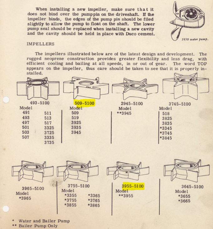

Disregard the Highlights. Looks like you need a 3755-5100 for the Model 3885.
