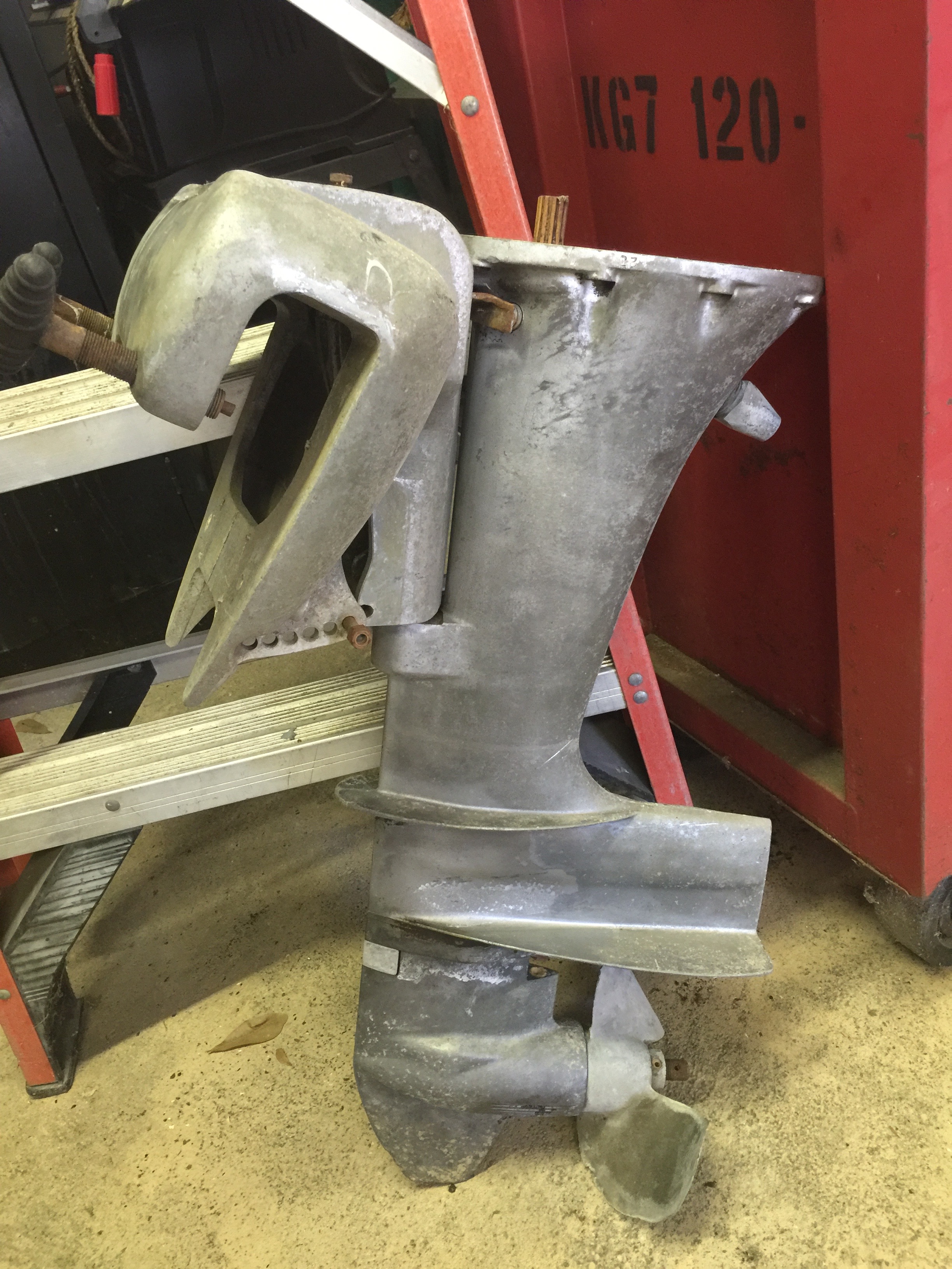

I have also seen the eBay sale and I can assure you that the seller is somewhat overpriced. It may help some of the members looking at your questions to know what model and serial number appear on the front of the motor hood. The matching serial number should appear on the side of the engine block as well. At first glance, the tower is not a standard fishing tower. It appears the tower may be a "Q" type race tower with a standard fishing gear case attached to it. Either that, or someone has cut off a piece of the exhaust.

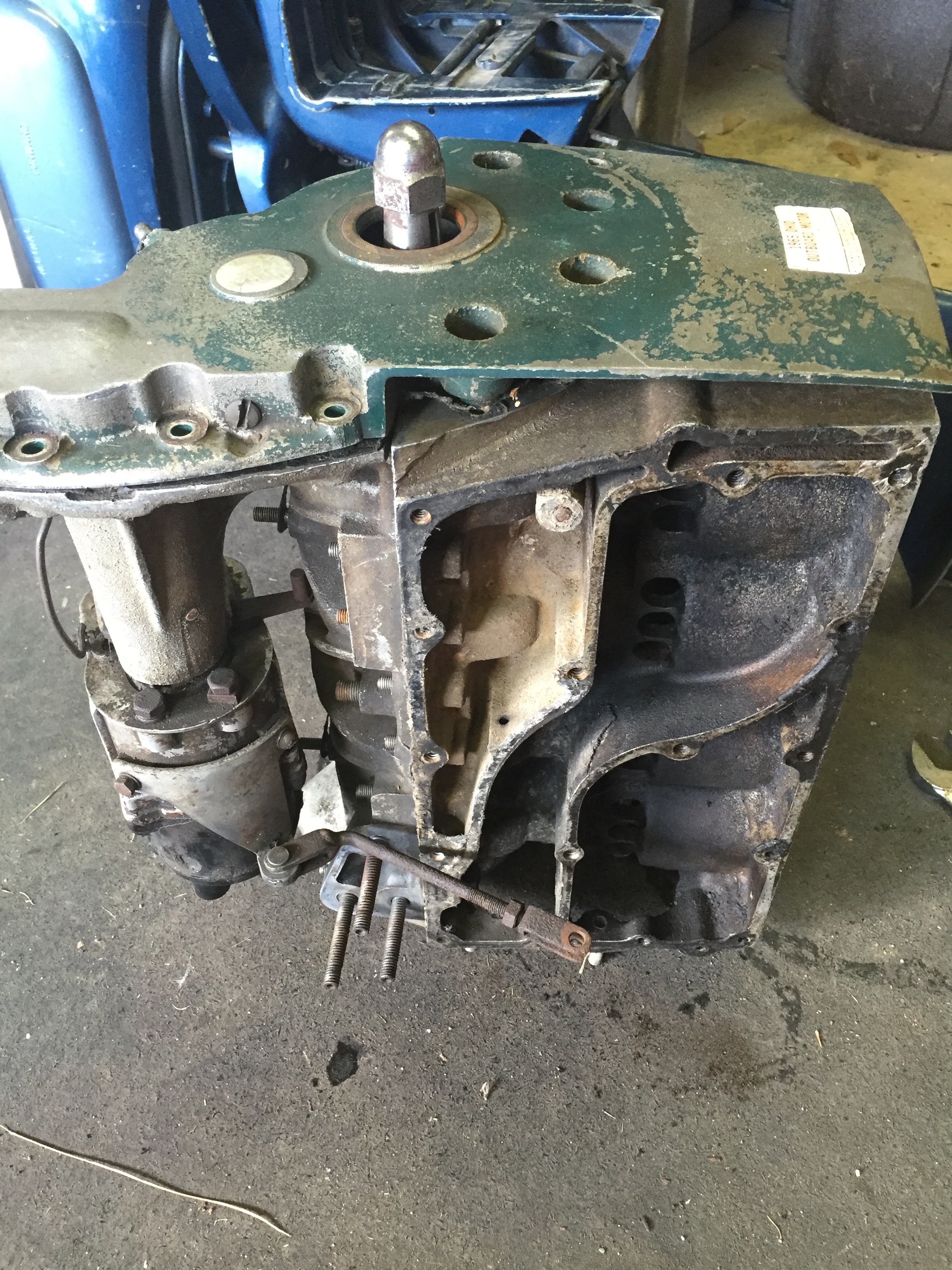

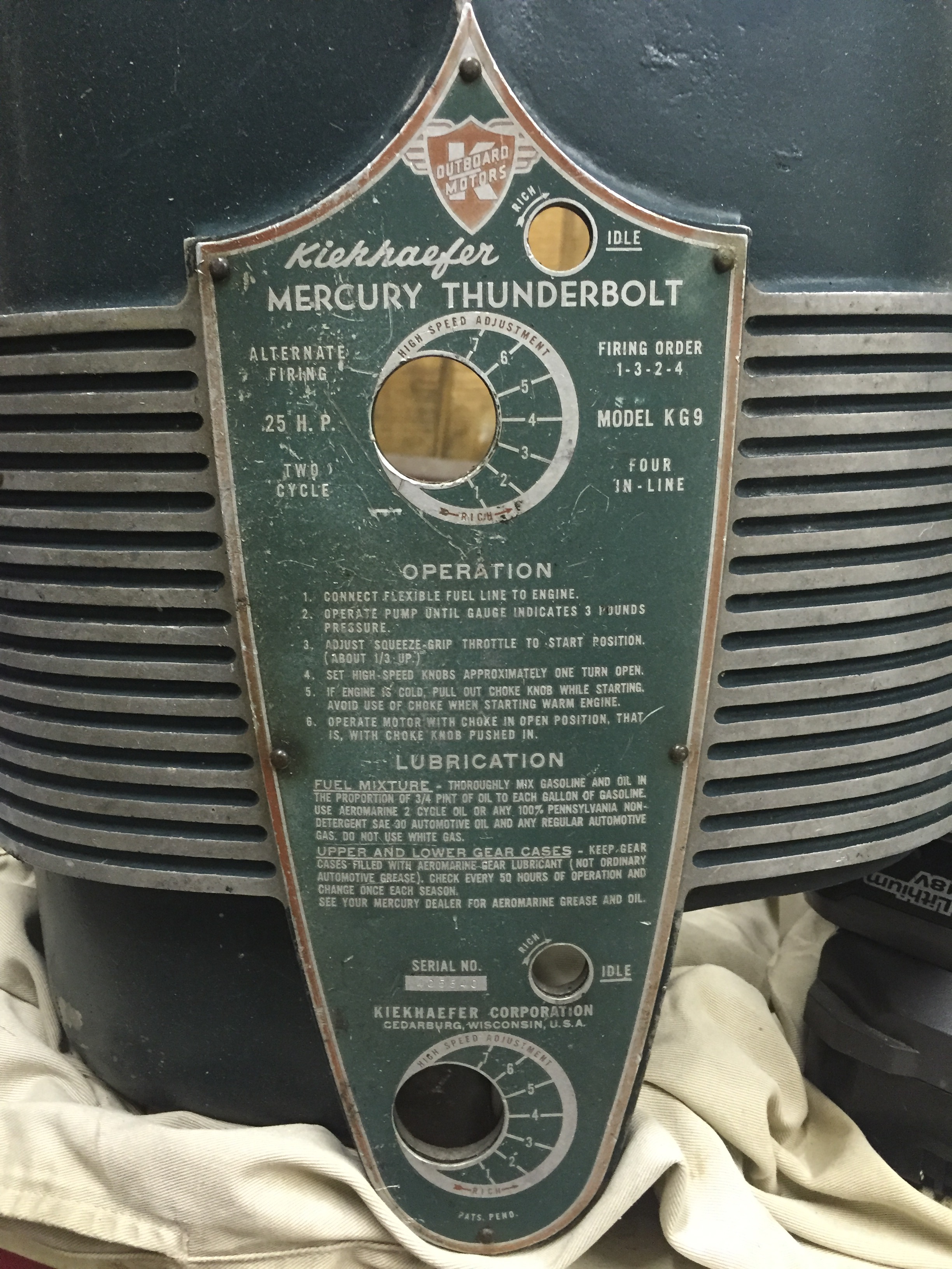

From all of my rading I know there are not a lot of these out there, and the ones that are are loved. I also learned that a lot of the handles went missing and they cut the part of the dash that secured the handle to it off. Crazy how things were done in the past.

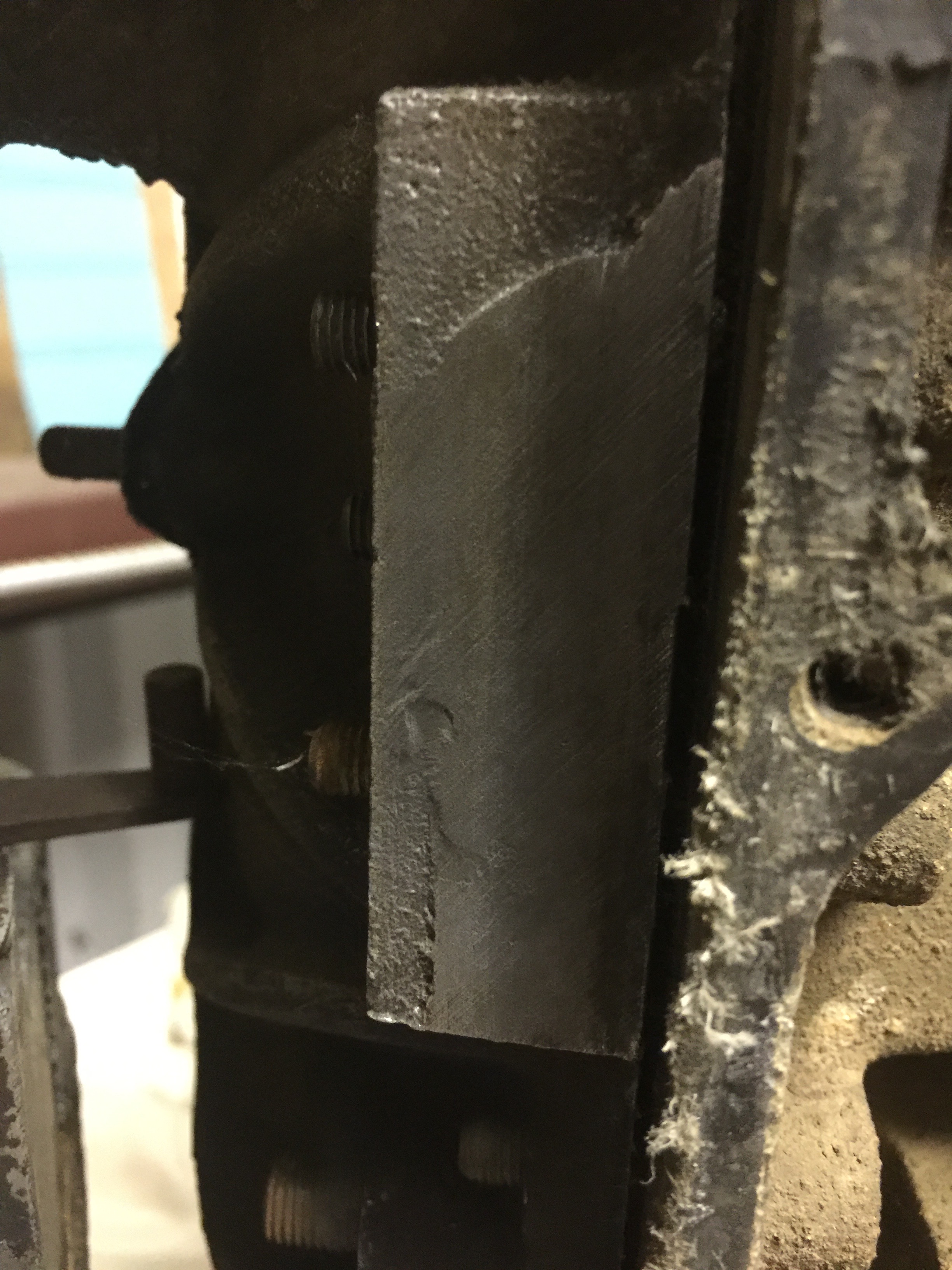

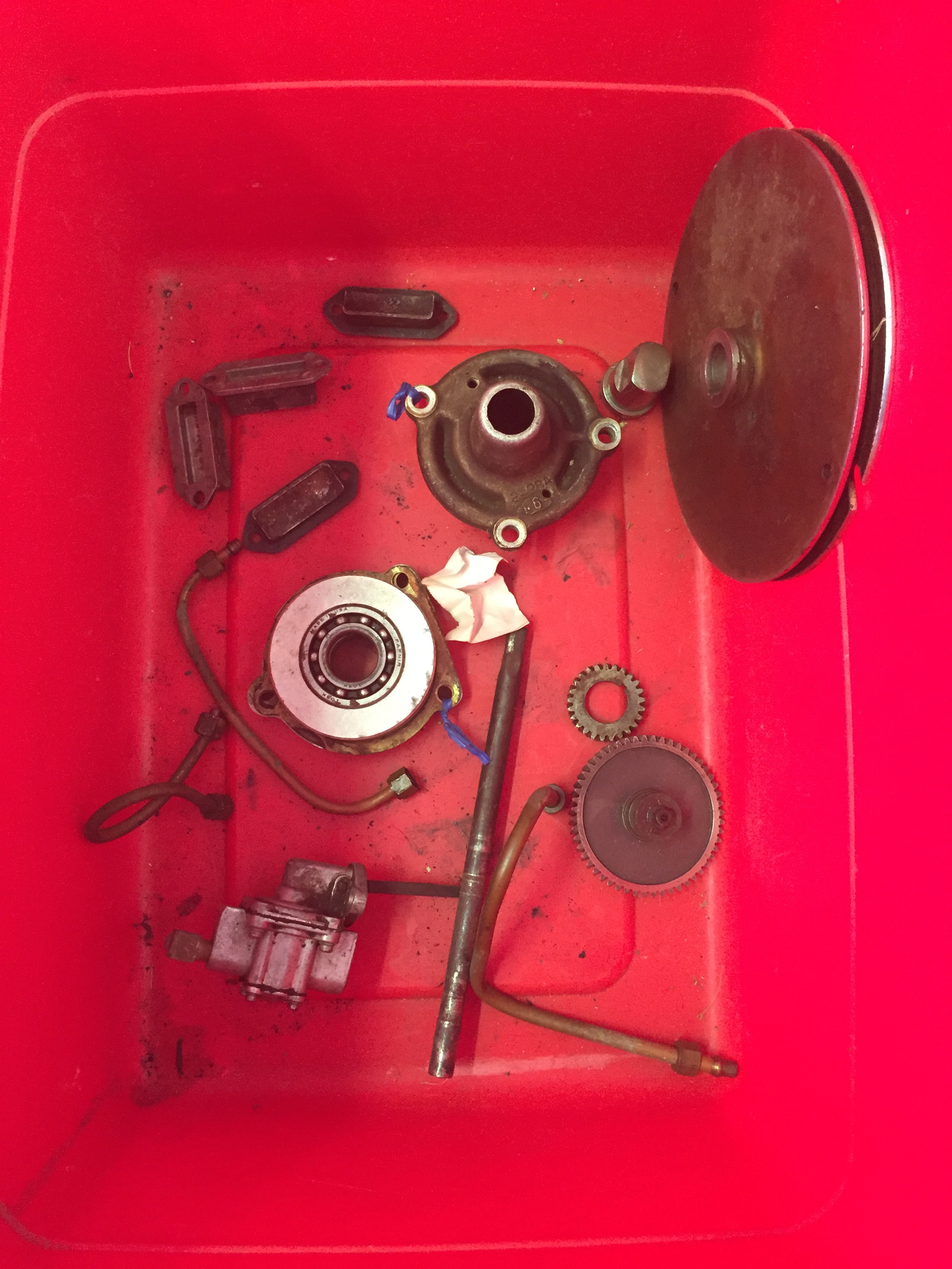

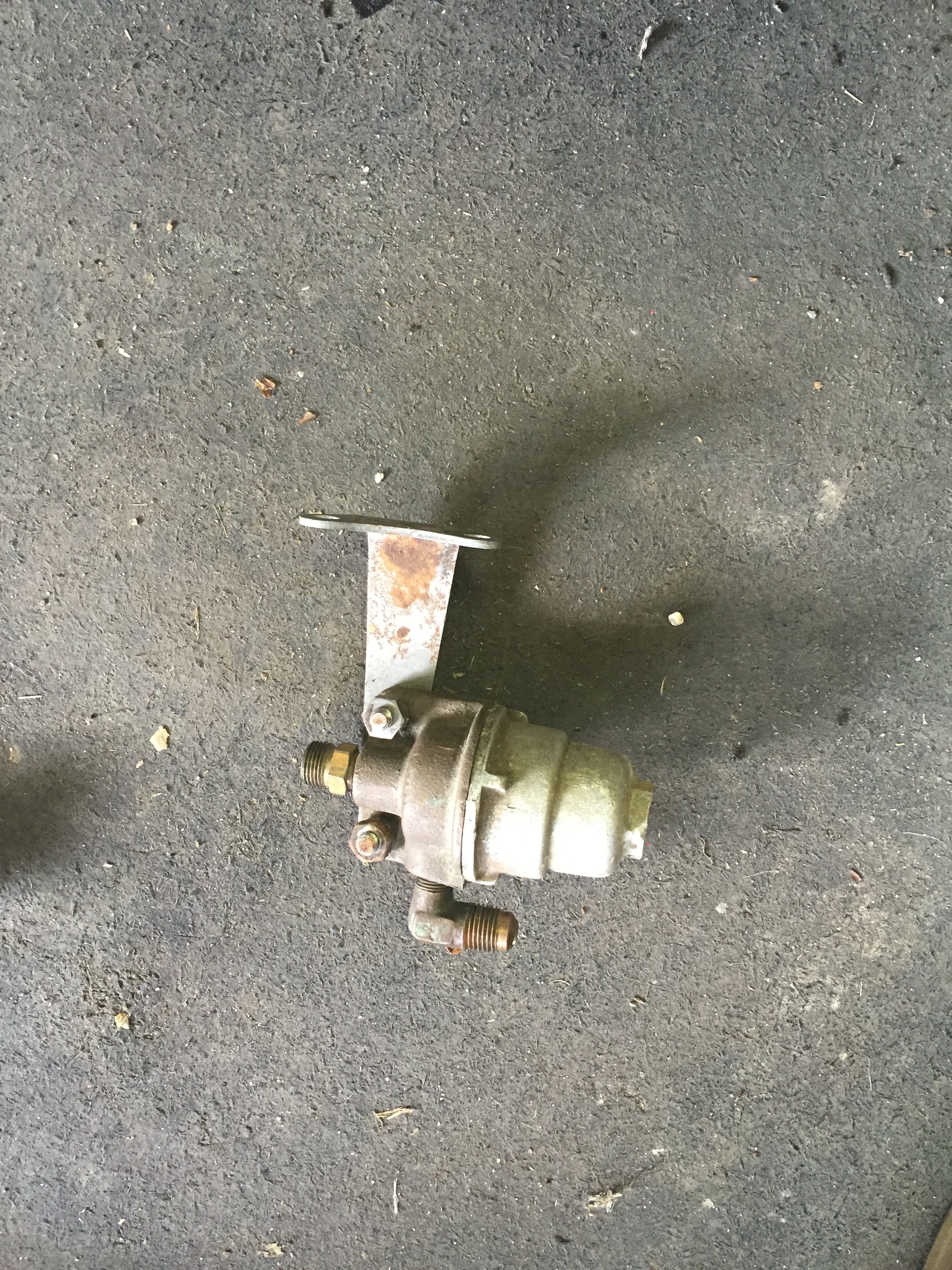

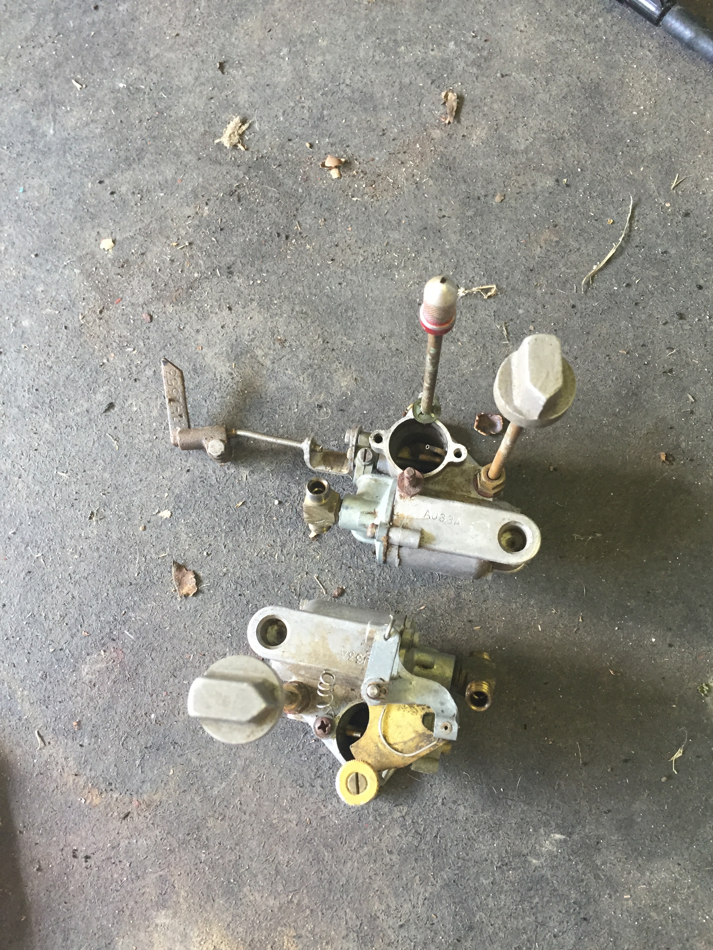

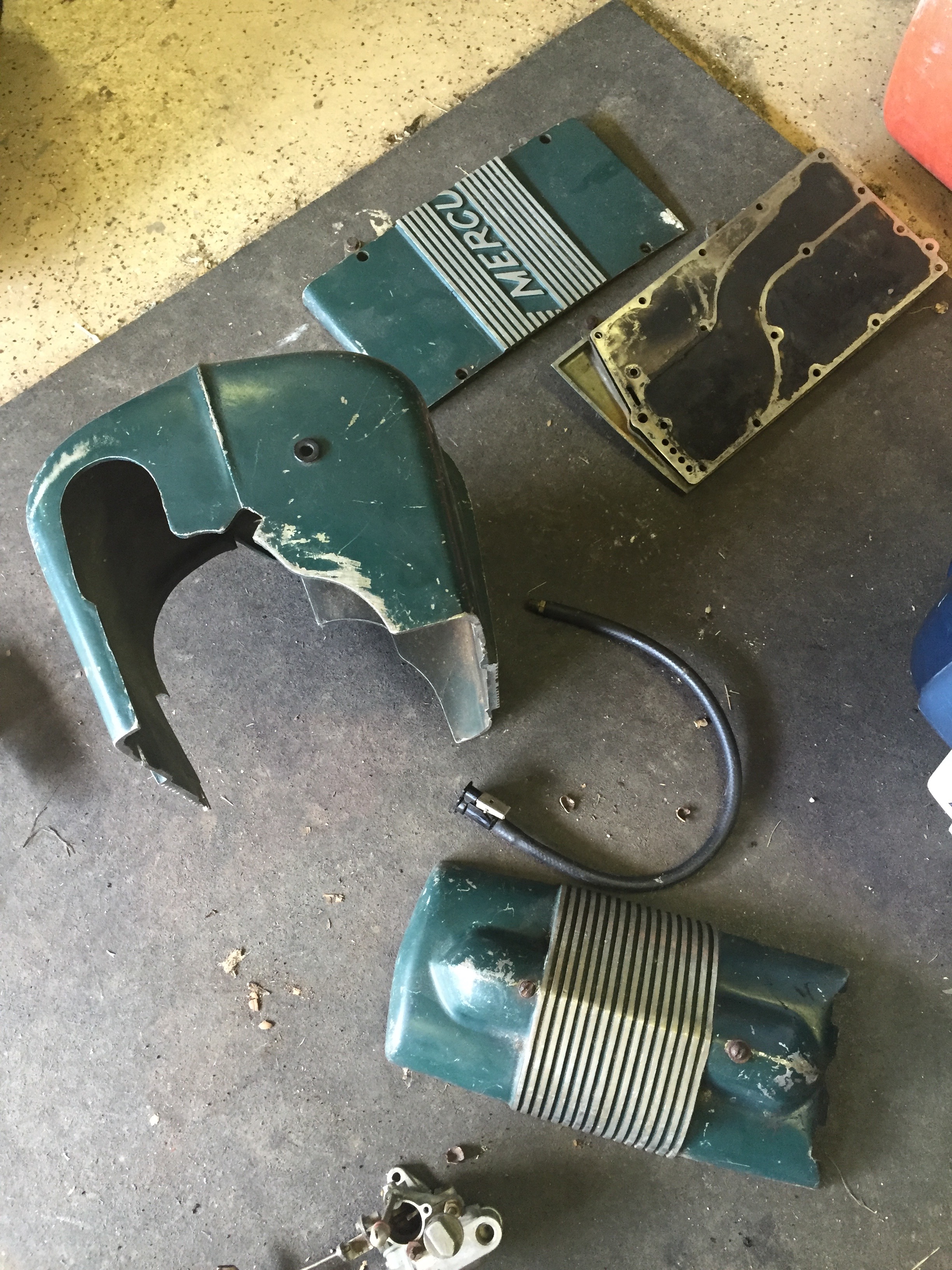

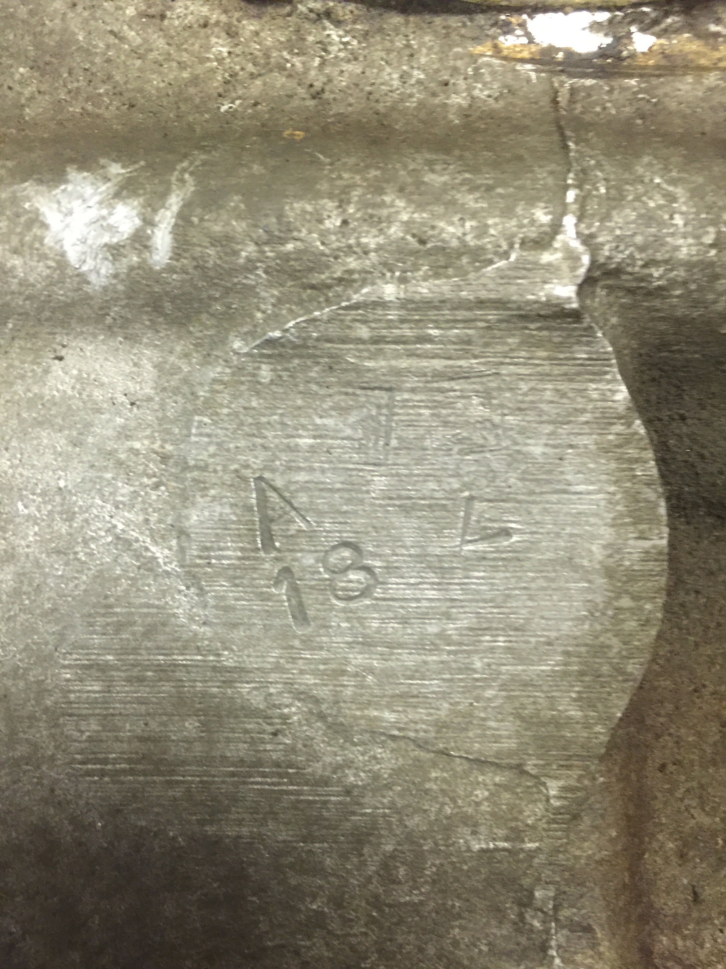

The Model is KG9 and the SN listed on the front panel is: 405540. I was not able to locate an SN on the block, just some numbers stamped on the top and a place where I would think the SN might be that is blank.
See pics.
