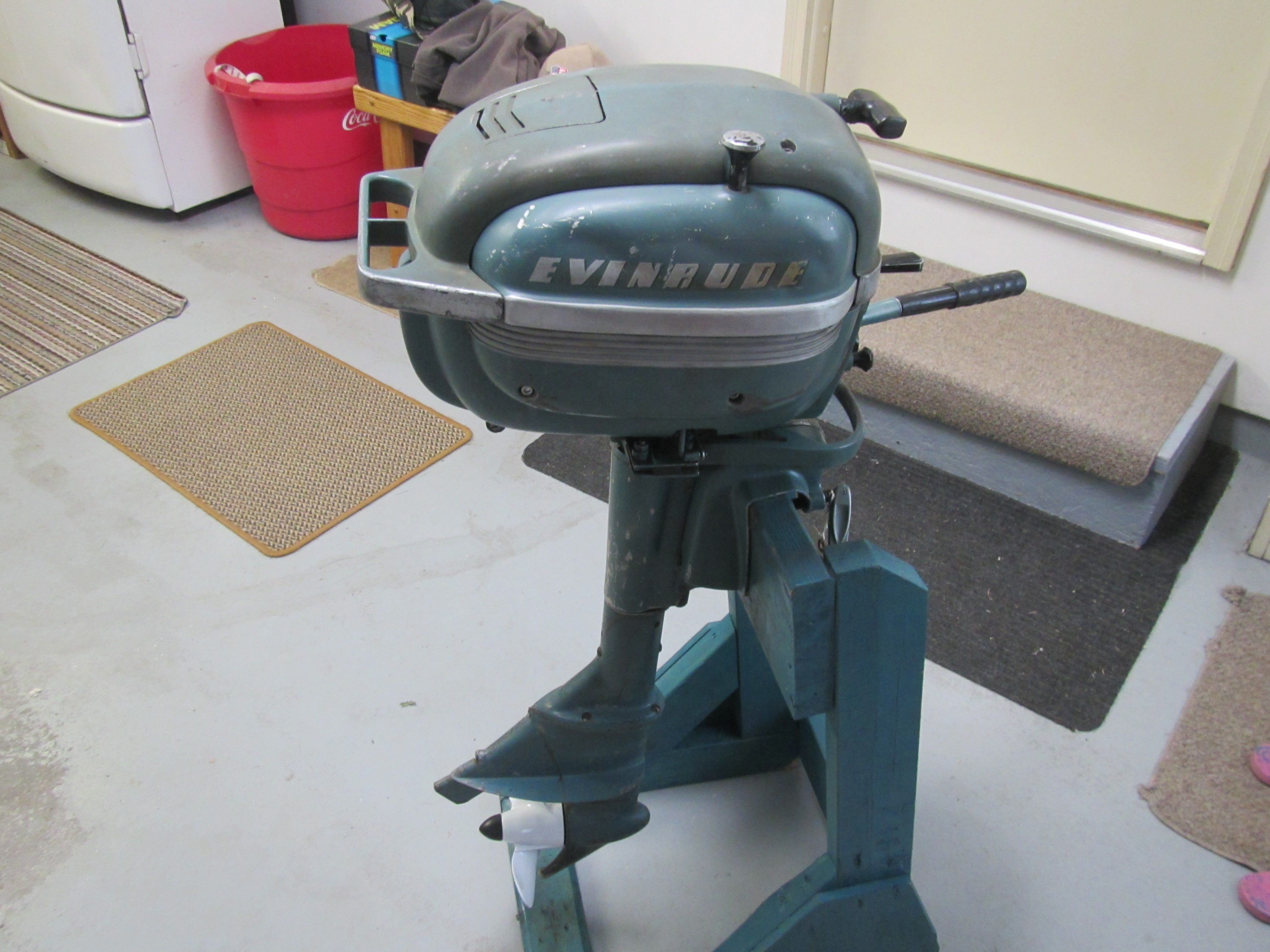

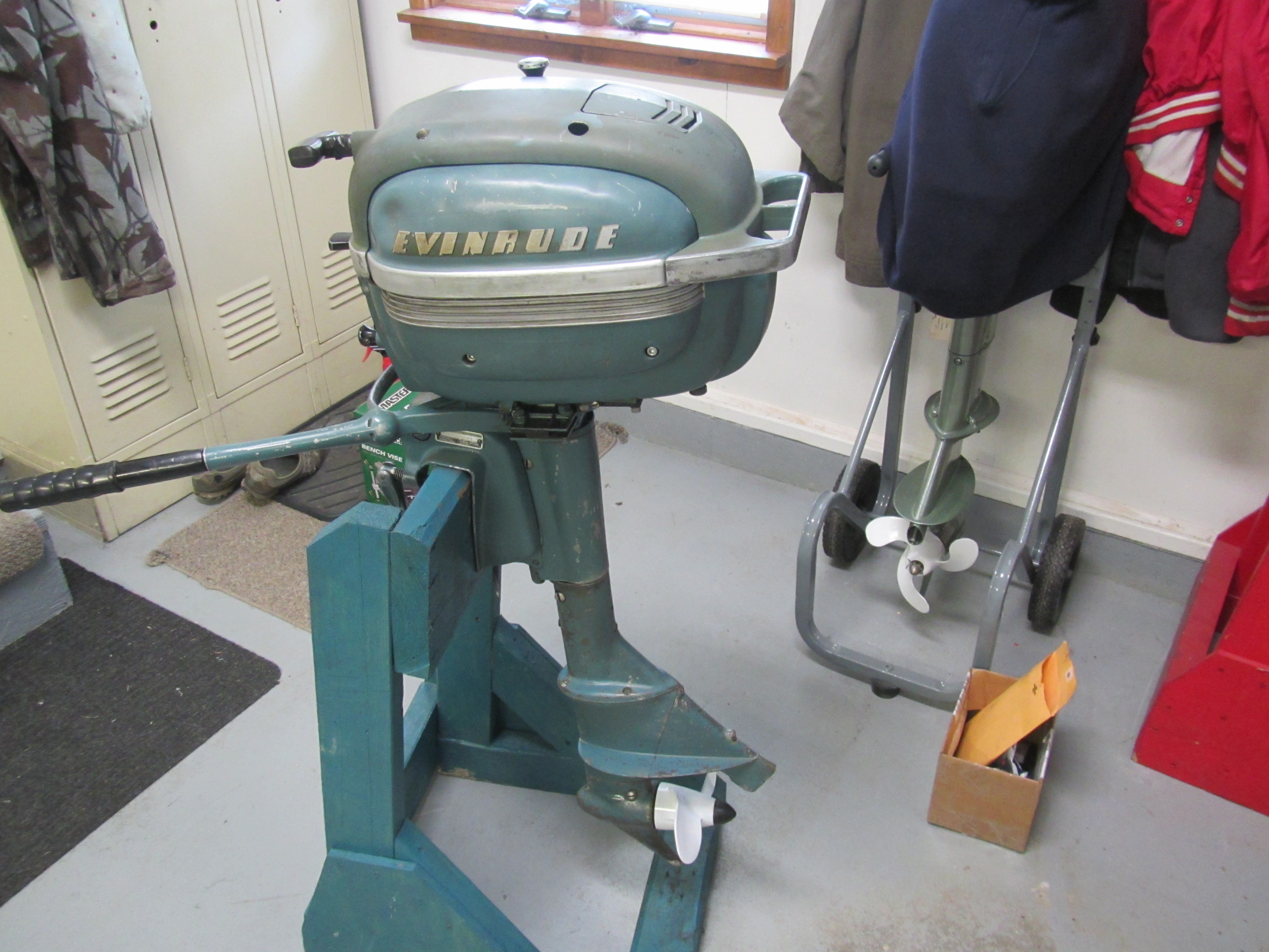

June 23, 2017 at 12:31 pm #60176Buc, it looks like you have a lot of work ahead of you. That tiller arm is a real mess! Here are a couple pictures of my project from last winter. The tiller arm on mine is missing the screw driver that screws in the end of the handle. I made an extension, it will work for now. The parts list has been posted several times on this site. Just do a search for fleetwin 7 1/2hp you should find it. A few of the parts are the same, head gasket and rings but most are different than the 54 and up 7 1/2’s motors. Impellers are expensive, I sanded a 5 1/2hp Impeller down and it works great. At least you bought it for a good price!
