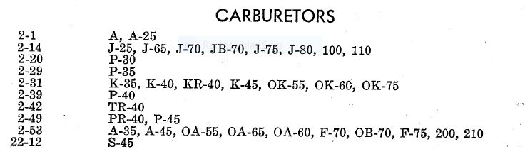

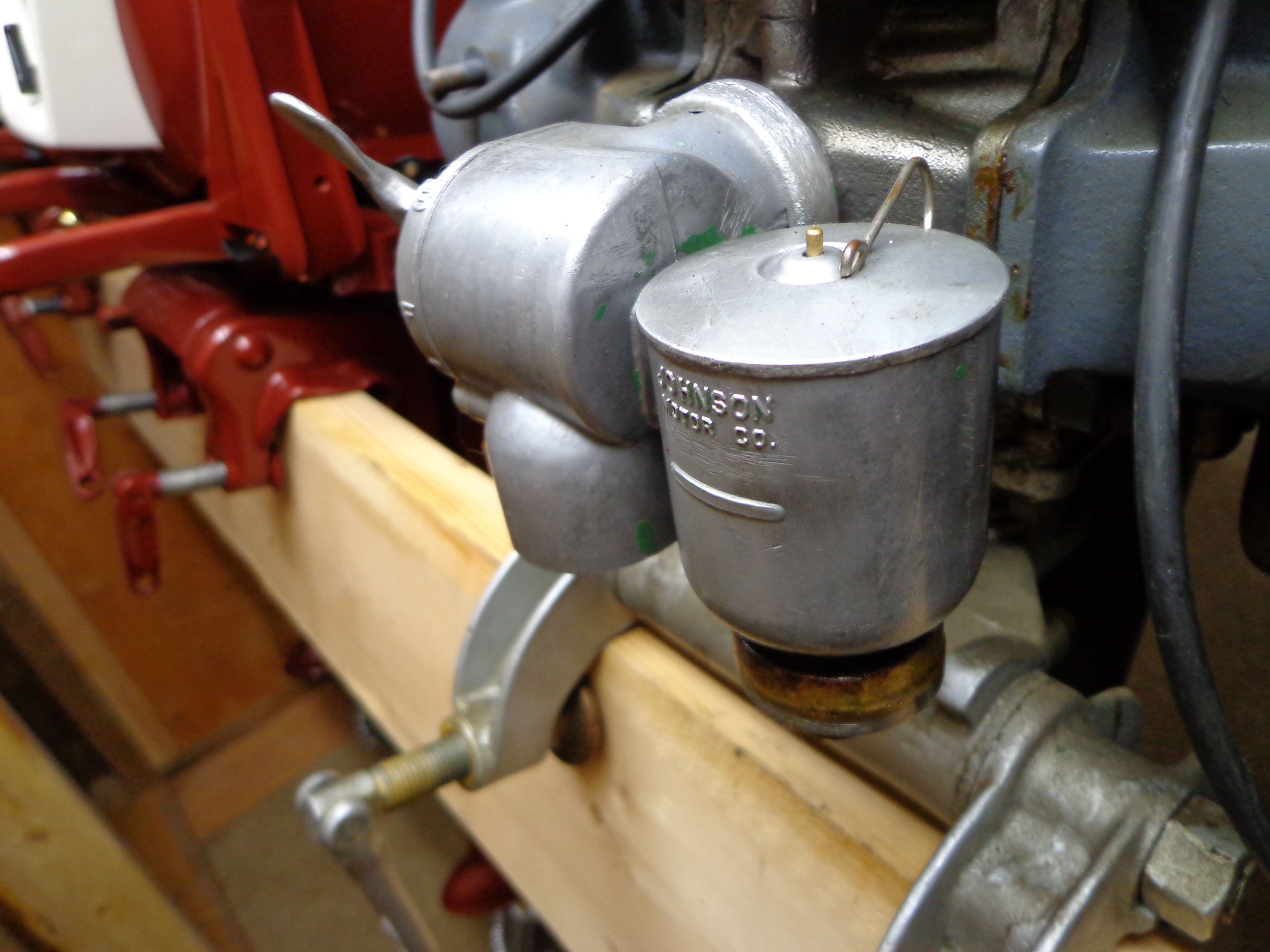

Carb. assy. part number for all OK motors was 2-31 and included the air intake air horn.
February 24, 2016 at 4:06 pm #32456XR,
is that in fact the same carb as the pre-war K series? The number makes me think that it is early.
AdamFebruary 24, 2016 at 4:44 pm #32457Anonymous
Hi Adam,I looked in a Feb 1954 where used list for US built motors and it shows 2-31 carb. assy. for all K & OK motors included K35 K40 KR40 K45 OK55 OK60 OK75. The OK10 OK15 OK20 Canada built motors show the same 2-31 number in an OK15 OK20 parts listing. So I would conclude that the opposed twin family of K&OK motors did use the same carb.

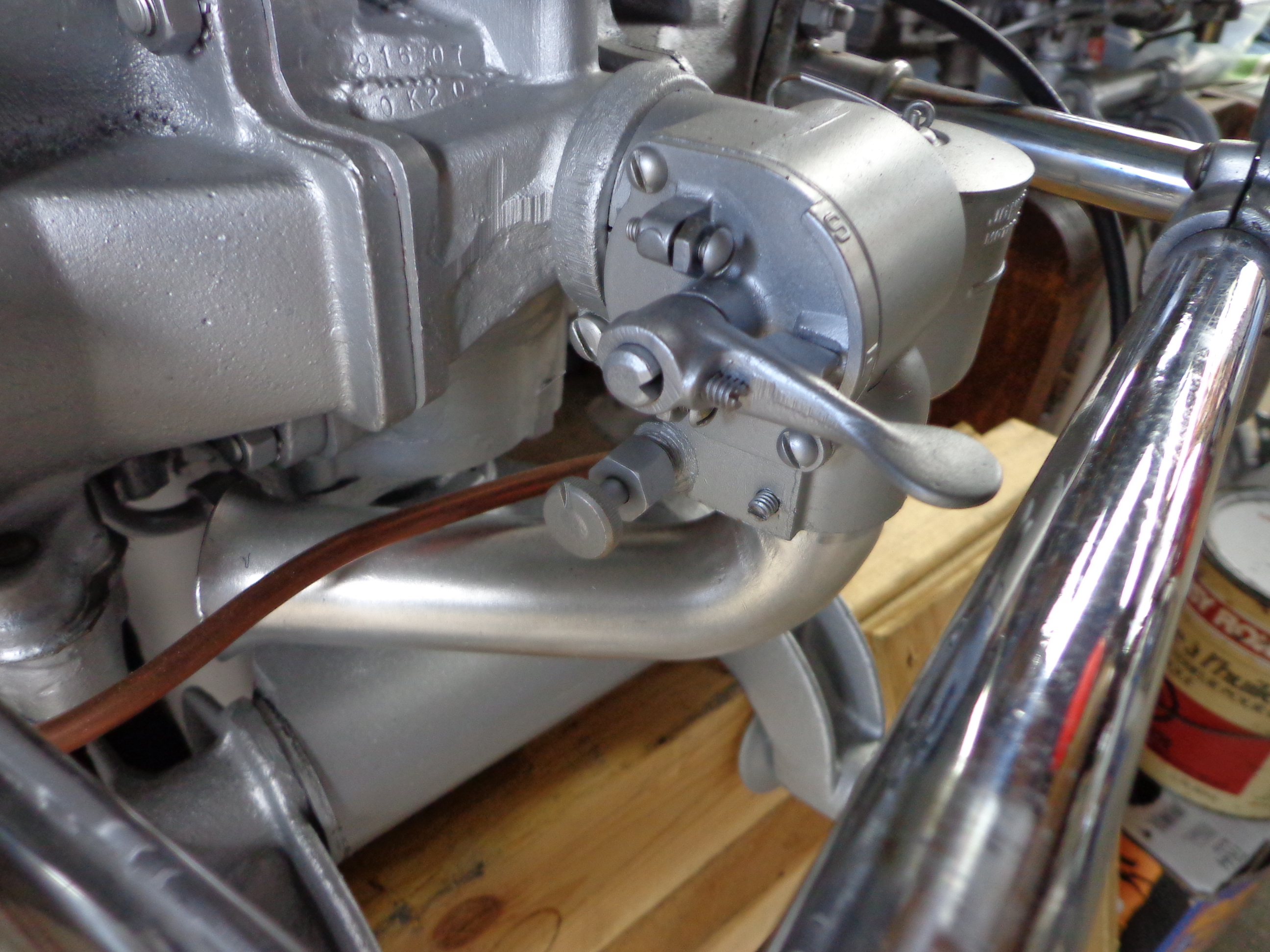

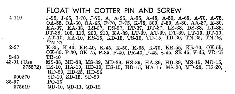

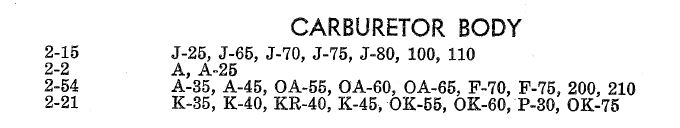

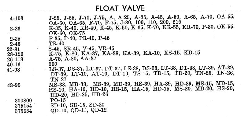

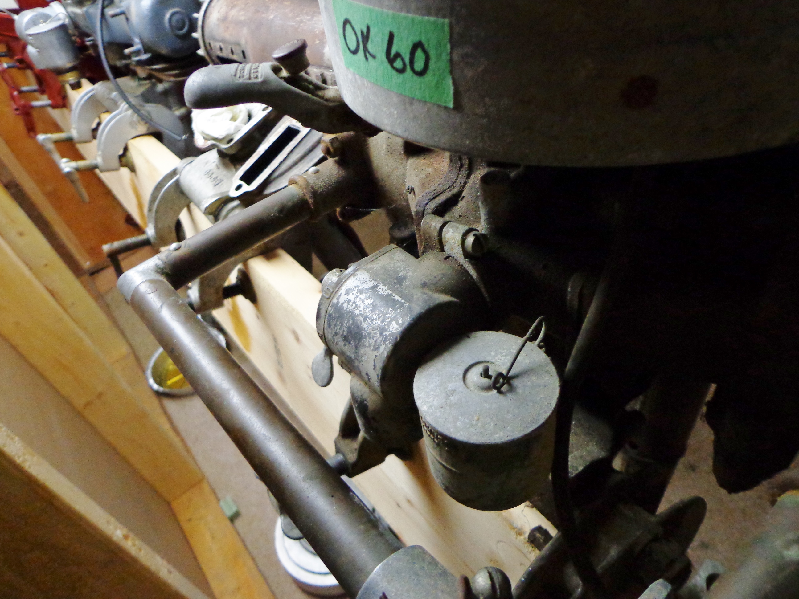

AdamI’ve been searching for ages and have never found a parts list specific to the Peterborough built OK series of motors and am starting to think they never printed one. I’ll compare the carbs on the OK 20, 15, 75 and 60 motors at the other shop when I go over later today. Meanwhile, here’s some snips from the 1950 Price List but they don’t mention the post-war OK 20 or 15 motors.

February 25, 2016 at 12:01 am #32476February 25, 2016 at 12:19 am #32480Thanks guys. This is very helpful. Now I just need to find a float valve for my motor. Thanks for posting the scan of the parts list mumbles, I was able to find the application of the needles that I have on hand. Unfortunately they fit the model 300 and the ft, at, TN motors.
