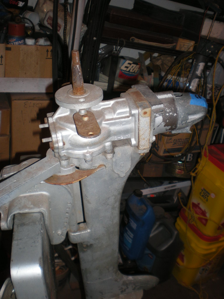

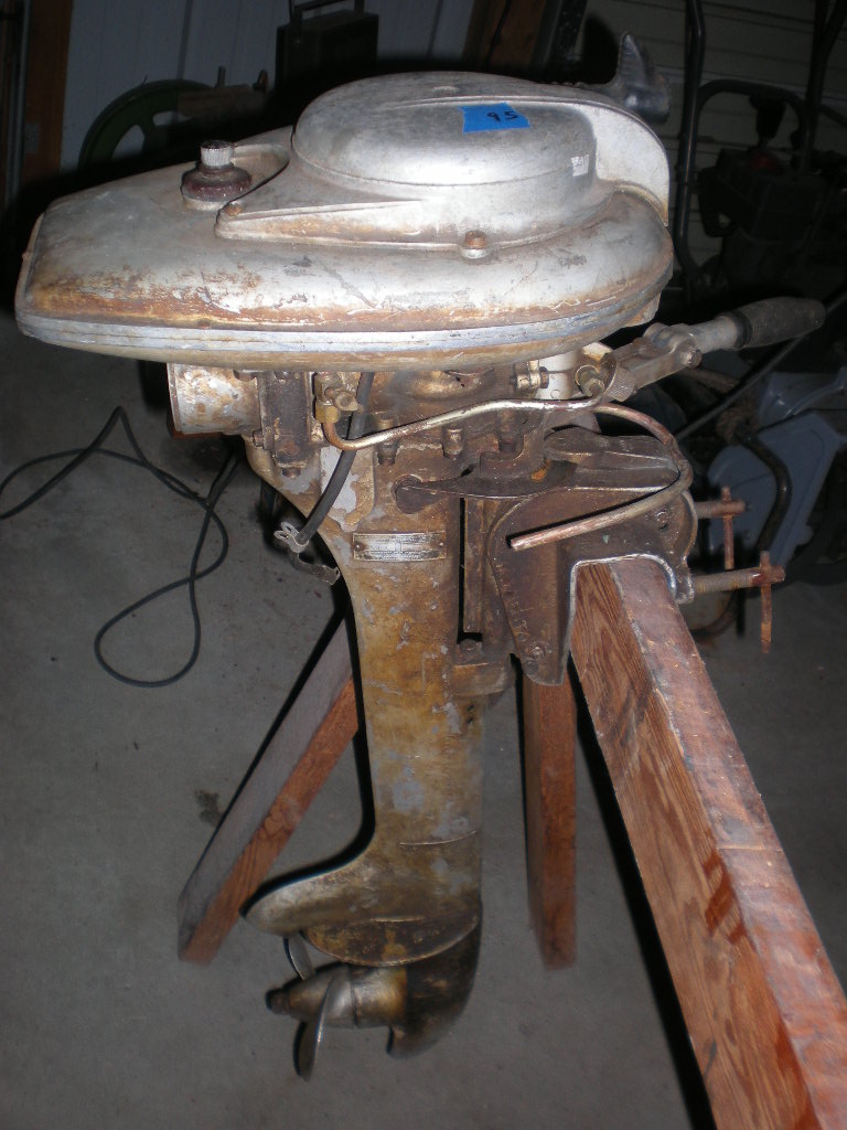

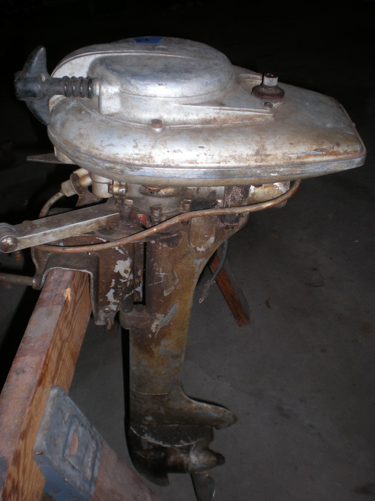

Mercury bloodlines in that one
November 16, 2015 at 2:17 am #27165Kd3 or kd3s…has spark plug cover and newer style mag mount
November 16, 2015 at 1:06 pm #27193Jason, looks like you’re spot on with the KD3S
naming. Looks like the same "bra" type spark
plug cover on this one….
http://store.oldmercs.com/category_s/86.htmPrepare to be boarded!
November 17, 2015 at 1:23 am #27219Crankshaft does not shine. May mean it had "wet" storage..corroded stuck
Value may be only in spark plug cover. Always nice to have a parts motor
just in case.
LouisNovember 17, 2015 at 3:33 am #27227November 17, 2015 at 3:36 pm #27243Might be able to make something from the two. At least from an external viewpoint, you now have a more or less complete motor between them.
November 17, 2015 at 6:04 pm #27248A good cleaning may be first order of business. After you can see what you have to work with
an orderly tear down may go easier. If my experience is any sort of guide…do not take apart more than one at a time. Focus on one until you get it back together! Do as I say not as I do advice.

Id tag on Starboard side ..are all KB3 so tagged? Not consistent with the prewar models
in my accumulation. I "ASSUMED" prewar Port postwar Starboard. Live and Learn. -
