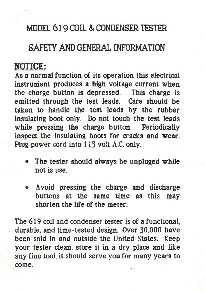

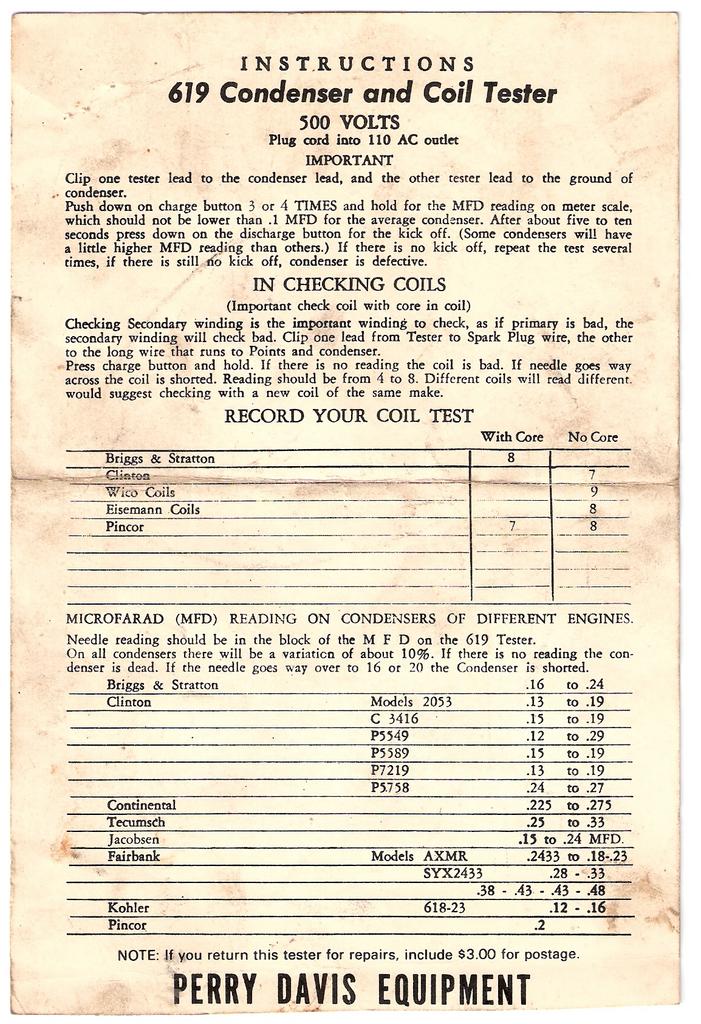

        Looks like it applies a charge to the coil based on the instructions below, found on the Smokstak.com forum.
