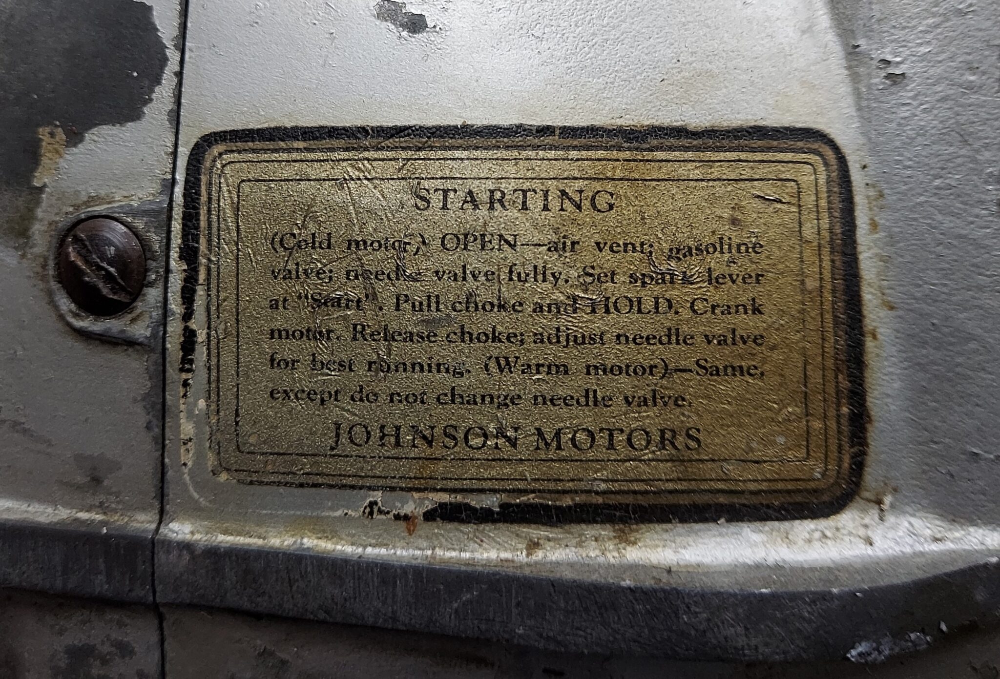

      Could someone please provide a photo of the starting instructions section, (as shown on the right hand side of the tank transfer) of a 1940 Johnson HA  2.5hp.
      I believe the same transfer was used on the MS,MD,HS  a HD models as well.
      If a photo isn’t available, a typed or printed instructions would be most helpful!
      Thanks very much for any help forth coming.

        ’40 Johnson MD15
        40-MD15-starting-inst-3
