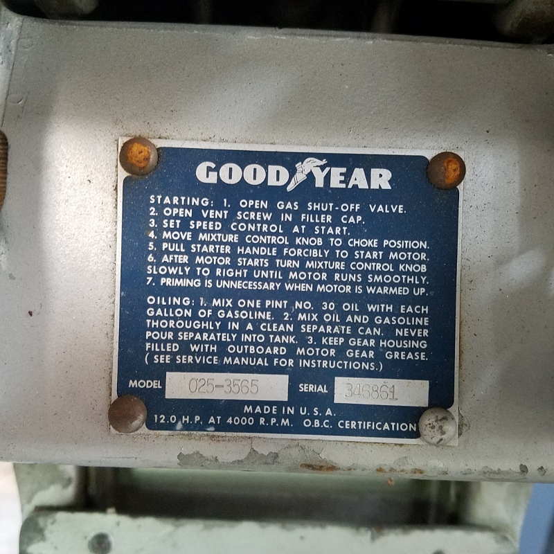

June 6, 2017 at 1:40 am #59087This guy is calling his a 12 horse also, so
I guess that’s what you have!

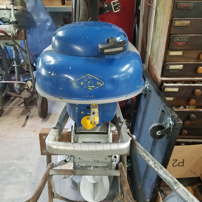

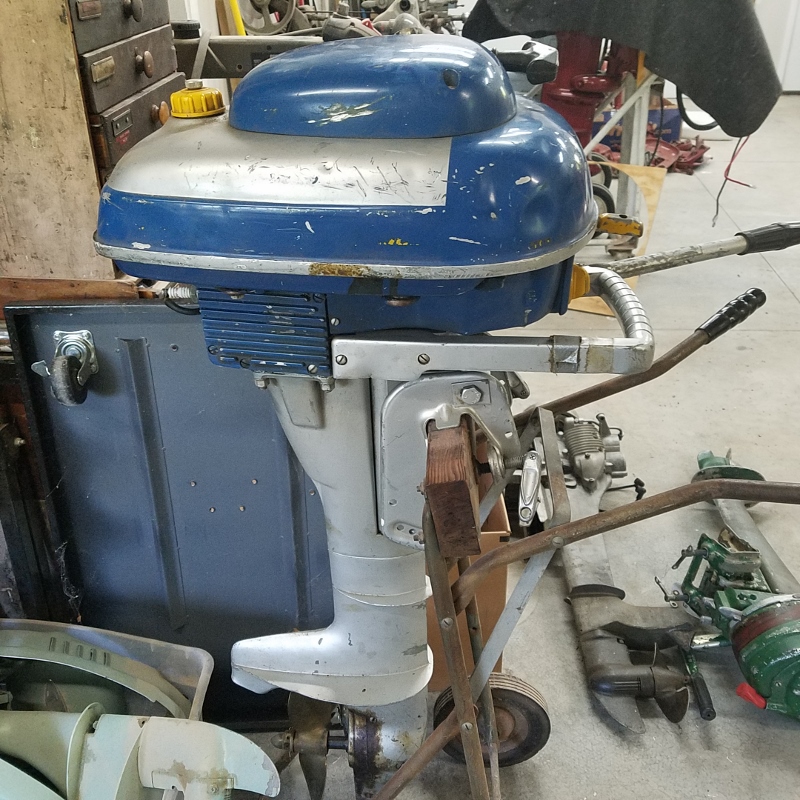

June 6, 2017 at 1:49 am #59091It has the Unobtanium coils. And check that propeller. I don’t see how it cools with that thing on there. It will keep you awake. Those things are loud
June 6, 2017 at 3:42 am #59101Clearly the prop is not right! The guy tried using the brass prop as a selling feature! I just laughed. One cylinder has spark. I’m hoping the other just needs the points cleaned. Do you think it is a Sea King?
Would they make a 12HP motor with no neutral or reverse? I see no shift lever on this motor.

It clearly is a Goodyear Sea Bee 12, made by Gale. But Gale also made the same motor for Wards, and labeled it Sea King. They also labeled the same motor as Buccaneer. And probably a couple more.
Yep, it is pull rope, hang on, and go.
June 6, 2017 at 1:40 pm #59122Doesn’t show up in the picture, but the prop has holes in it that force-feed water to the pump intake.

Next stop…classifieds. Unless you have those parts for sale???June 6, 2017 at 2:51 pm #59124Your motor looks awfully similar to a ’50 Elto Speedster under the paint and it should pump water like a fire truck when it’s running. Don’t forget, 8:1 fuel mix on these bad boys!
