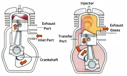

      I am putting together the powerhead for my KA 37. Pistons were out when I aquired it. Which way do the pistons face in the cylinder. Ie the crown. Any pictures would help?

              This is one of Buc’s pictures b

                The longer slope goes toward the exhaust.
