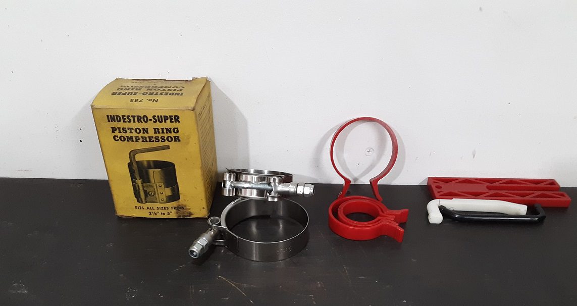

Ring Compressors. The one in the yellow box I’ve had close to70 years. No good for outboard motors. I had been using these hose clamps till someone on here said these plastic ones work well. So I tried them. IMO they do work well. There on eBay for less than $15.00. May find them cheaper if you like to shop around.
