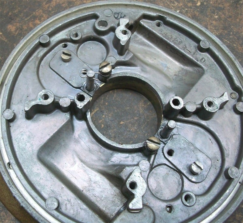

      Lost that silly little spring clip that holds the points down on the pivot post …. I replaced it with a C clip
      should I worry ?

          I am not worried about loosing/dropping the spring clip I am worried about the C clip not being a suitable replacement… is it ?
          it seems to hold enough but the C clip does not go all around the post as much as spring clip does
          #157397
            I guess you are concerned that the points arm may rotate the C-clip off ? Dunno, I guess it is one of those things that would never happen if you wanted it to, but surely will happen if you don’t want it to. My opinion is it will be OK, but don’t try to go to the bank on that.

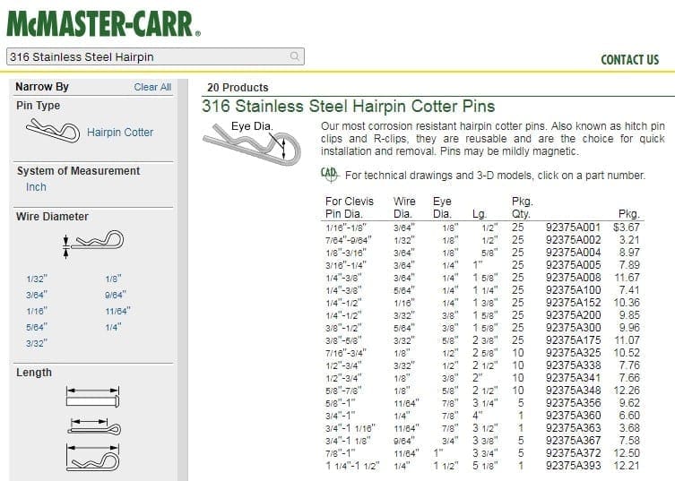

                        As long as we’re on the subject, is there an equivalent, generic
                        replacement for those little clips, such as from McMaster’s, that
                        outboarder’s have found satisfying?

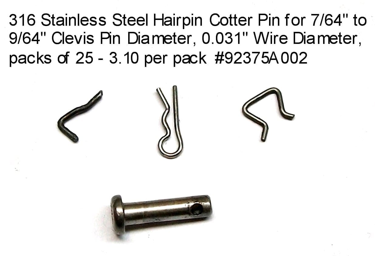

                        I bought these from McMaster Carr awhile back to use for carb linkages and they work great.
                        316 Stainless Steel Hairpin Cotter Pin for 7/64″ to 9/64″ Clevis Pin Diameter, 0.031″ Wire Diameter, packs of 25 – 3.10 per pack #92375A002
                        They slip on a lot easier and are easier to work with than the straight wire or a tiny cotter pin. I tried it on the points post and they seem to work ok, although a little tight. Maybe the next size up would be better to use for the post.
