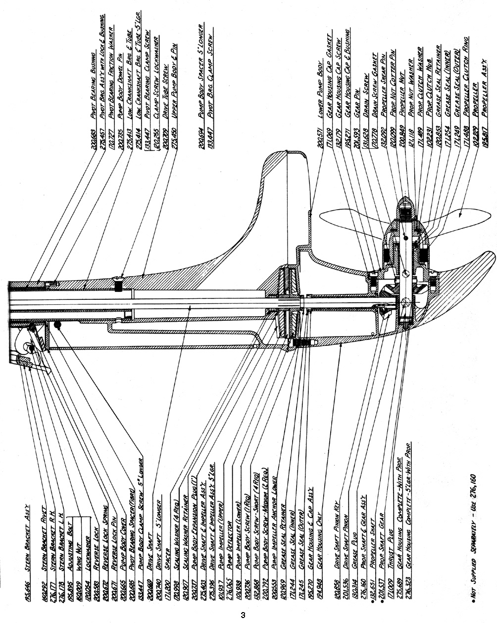

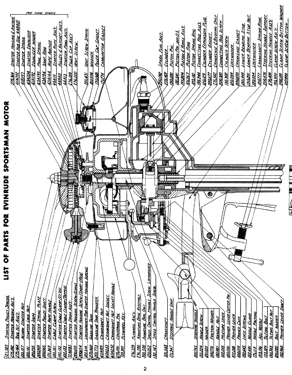

              Is this the Sportwin you have?
              Or this one …
              #19656
              wyo307
                Garry The second one is the one I am working on at the moment. Thanks a lot for those diagrams they help a lot. I’m missing a bunch of washers and bushings that I didn’t know about.
