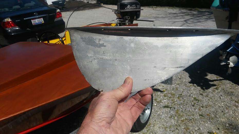

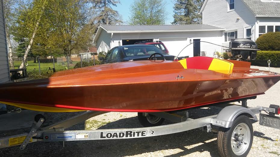

I have an 11′ Clarkcraft replica 50’s racing runabout. The problem with it is the tendency to skid (slide sideways) through turns. I have what I think to be a vintage aluminum skid fin made for this type of application. It measures 13" by 5". The boat is not a hydroplane and the skid fin is not the type used on a hydroplane. My question is, where along the keel line should this piece be installed? Should it be used at all? I’m thinking either the linear center or possibly the center of gravity. Suggestions from knowledgeable folks would be appreciated.

Your choice. PS; -that fin may be a bit big ?May 6, 2016 at 4:36 pm #36092Absolutely love that boat and motor combo. The Martin 200 is at the top of my "motors I must have before I die" list. I agree with bh, that fin is to large for the combo.

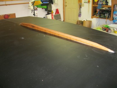

May 7, 2016 at 9:46 pm #36165May 7, 2016 at 10:29 pm #36167My 8′ runabout used to slide all over the lake until I put this 2" x 8" ski fin on it. Cured the problem.
Located for left turning, but will turn right at less speed.I think the fin you showed is from an old slalom ski, and too big. It doesn’t take much. Good luck. 😀
