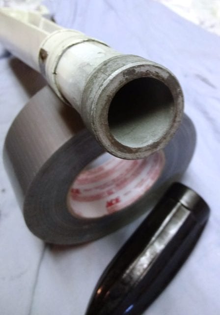

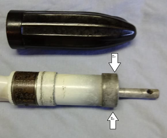

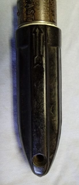

      There are no slots for the friction block to engage into.
      I do not know the original color.
      I’m missing some inner parts.
      Two questions-
      What year and model did this tiller come from?
      Do you have a parts list for it ?

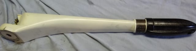

        The tiller arm looks correct for a Bigtwin or RD, but that black throttle grip does not look correct, but you mention there are no slots for the friction block…
        Makes me think this is for a very early Bigtwin or RD, but the paint color is wrong…Maybe someone can post a parts breakdown for an early tiller handle….

          HI;
          the tiller came from a 1951 or 52 Evinrude Big twin or Johnson RD 25hp paint color should be either blue or green depending on the motor
