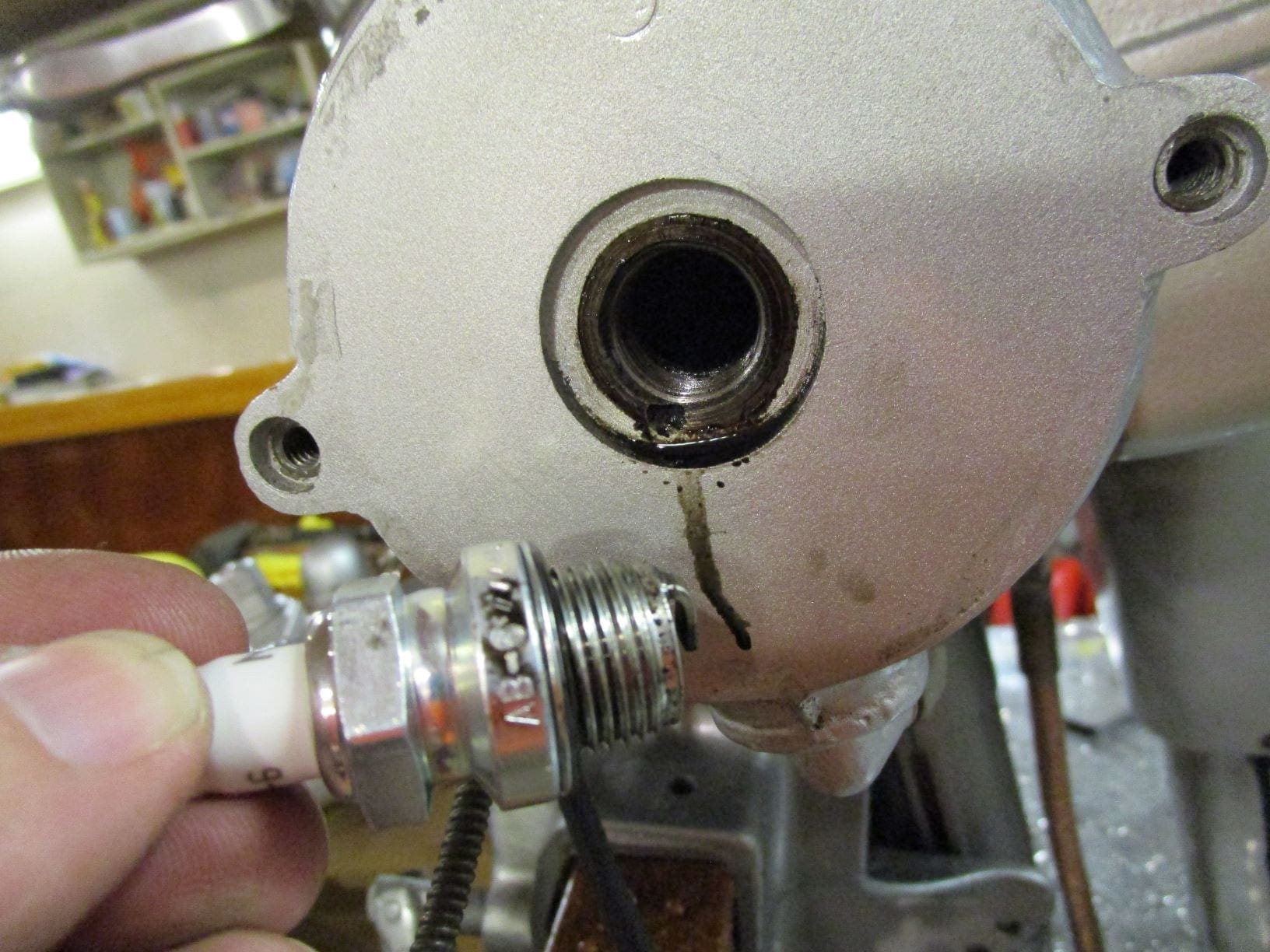

      Just installed new plug wires and after test running I noticed a little oil seeping from one of the plug holes . There is a small chip on the casing right on the edge of the hole .
      Is this a problem and if so how would I fix ?

        A new copper spark plug gasket might conform enough to seal the leak, but you would have to replace the gasket each time you removed the plug. It could be silver soldered IF you can get all the oil out of the cylinder casting. (Plus some very careful grinding to make it smooth.) With a heavy duty drill press and a BIG drill bit you could deepen the hole and use a thicker copper washer under the plug. OR just keep cleaning up the mess. OR find a good used cylinder. . .

          Thanks Garry ,I dont mind cleaning up a mess as long as its not hurting anything running it that way ..
          Do you think JB Weld would stay put for a while ?
