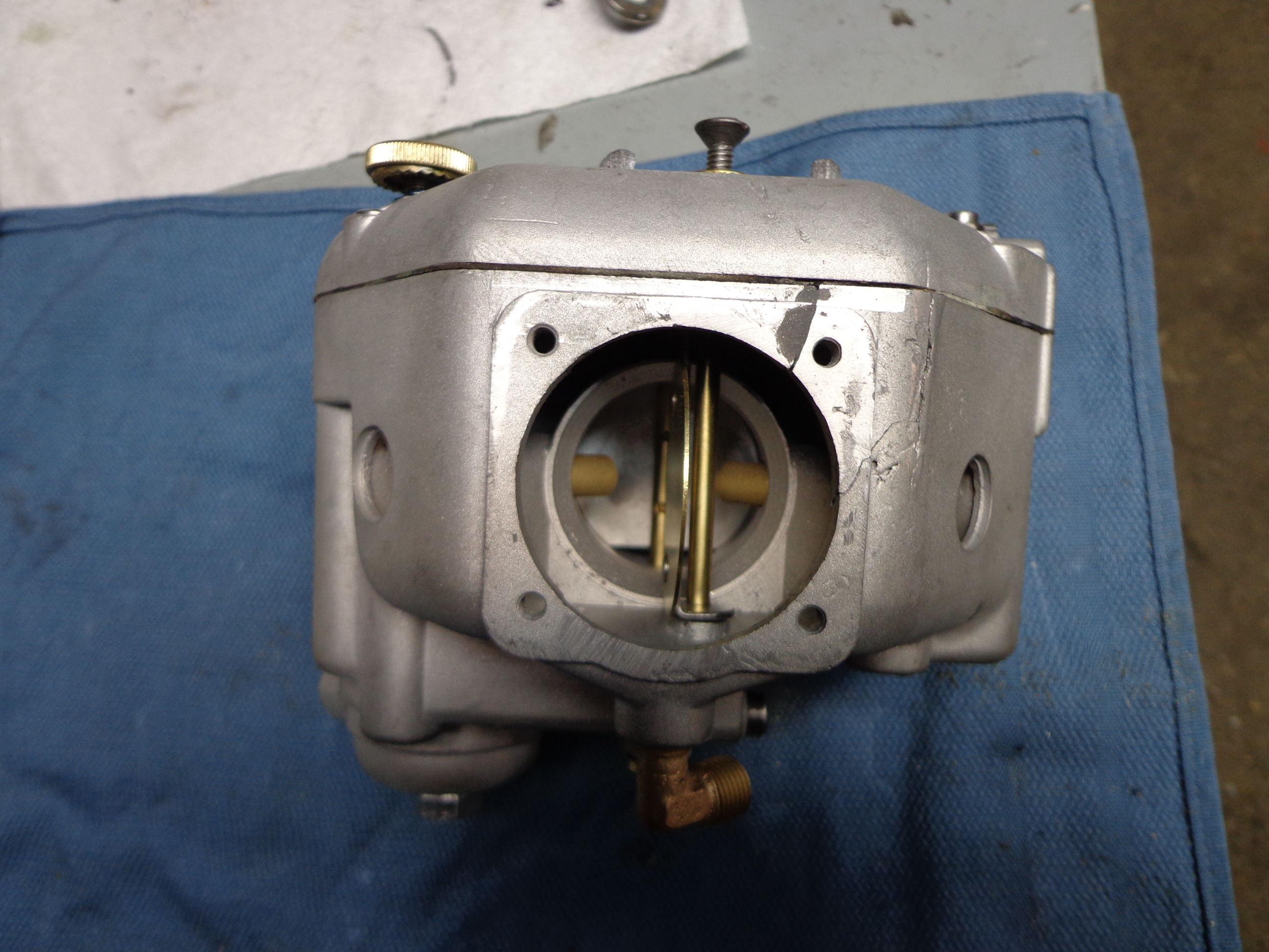

Putting the carb back together on my PO-15.
When I took the throttle butterfly off the shaft
for disassembly, the "flat" was facing down.
The parts manual would almost suggest it goes up.
Q. Which is correct?There’s quite a bit of slop in the throttle shaft bore.
Q. Would that affect operation on this type of carb?
The bottom shaft bore is a dead hole, but the upper
shaft bore goes to atmosphere.Thanks!
October 22, 2016 at 12:01 am #46270October 22, 2016 at 1:25 am #46276Thanks Mumbles, looks like I’m good to go!
Looks like your carb has a crack to fix.
Any thoughts on the sloppy throttle shaft bore?Prepare to be boarded!

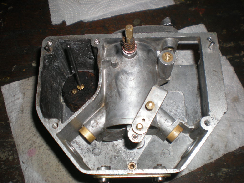

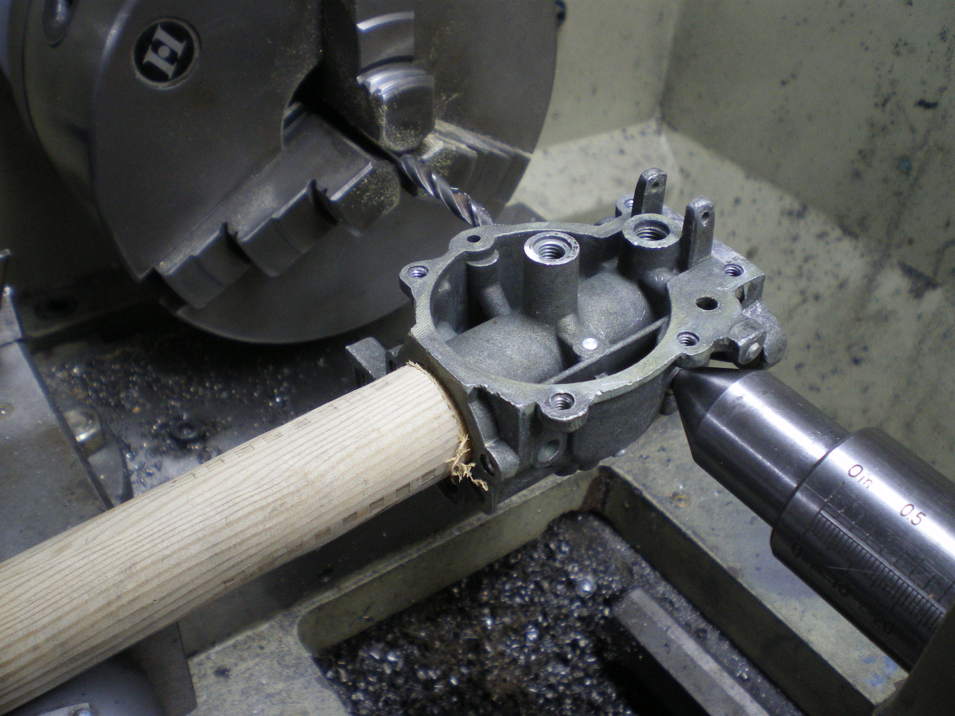

October 22, 2016 at 5:25 pm #46314I silver soldered the worn areas of the throttle shaft.
That was the easy part….. then ground, machined
on the lathe, and filed them back to kind of original
size. I should have soldered the areas oversize instead
of just back to normal, but it is tighter than before!Prepare to be boarded!

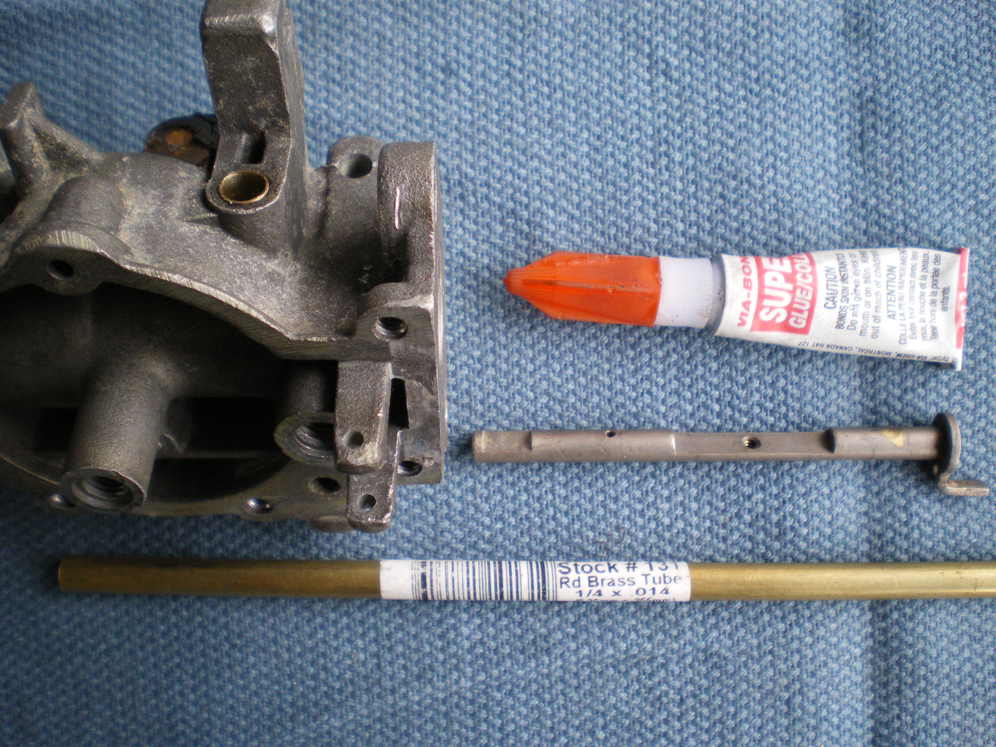

October 22, 2016 at 6:05 pm #46322October 23, 2016 at 12:53 am #46335Mumbles, I thought about the "bushing" idea, but like you say, if the shaft is
worn bad, it’s not going to cure the slop.

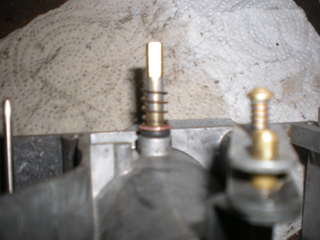

Making the shaft "round" again with the silver solder helped, and
then I came up with the idea to put a "shaft seal" on the top side
so it can’t suck air around the shaft…… not saying it will work,
but not out much. One O-ring, a spring, and a washer!Prepare to be boarded!
