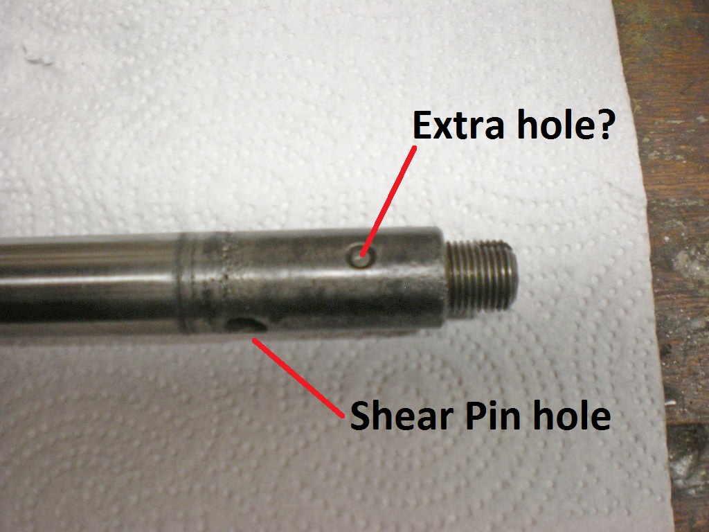

I took the gear box apart today (bottom half) on the PO-15.
The prop shaft has an extra hole in it that seems to have
no use. This 1/8" hole has a pin in it, but is flush with the
shaft. This hole would ride inside the prop hub bore.
Any ideas what it’s for?Also, the prop shaft outboard bushing has been modified
