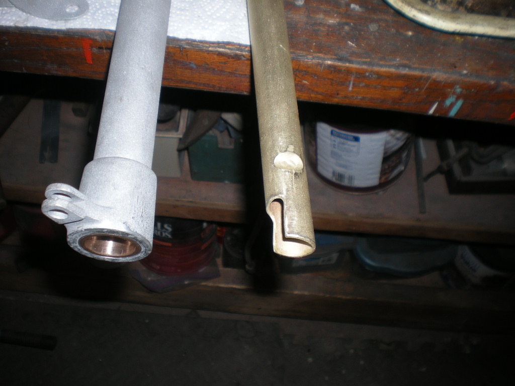

Was there originally "bushings" in the tiller handle that
the inner tube rode in?
I see no evidence that mine ever had any, and the
inner tube was really sloppy.
Also, the notch in the end of the brass tube (to allow
the wiring to exit) looked like it was cut with
a hack saw, and was full of burrs and rough
edges.
Bushings are now installed, and inner tube deburred.
Just wondering if Johnson’s quality control in 1950
was that lax or had a prior owner messed around?Prepare to be boarded!

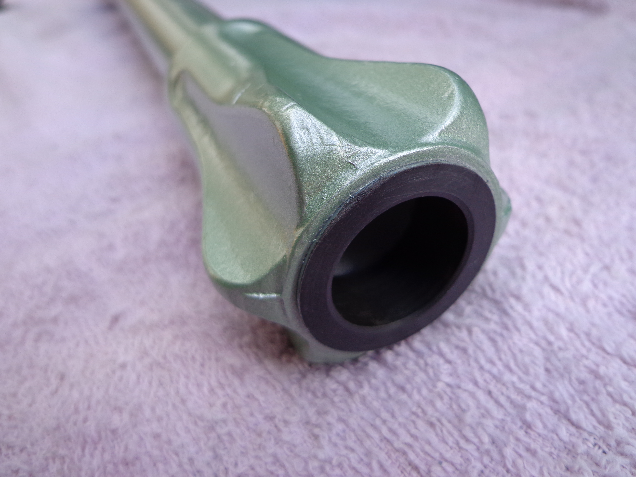

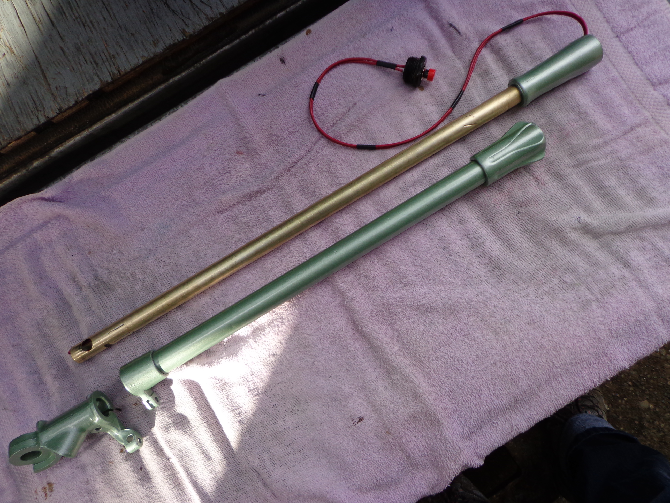

December 4, 2016 at 5:51 pm #48523My ’49 tiller had remnants of some kind of bushings but it was seized when I got it and had to be forced apart. After polishing the inner brass shaft and making new bushings with lips on them out of Acetal, it turns freely now and has very little end play. The notch looked OK so I left it alone.

Your Acetal bushings look nice!

December 5, 2016 at 11:24 am #48580Yes there is a bushing just like the one posted. The hole is where the wires exit for the suhut off switch.

December 6, 2016 at 12:20 am #48614The original bushings probably did not wear out. They were a heavy, micarta type material. Since someone sliced your inner tube for the wire passage I’ll bet they failed to reinstal the bushings when they assembled it.
Like Mumbles, I make new ones out of black delrin (acetal).
George
December 6, 2016 at 12:51 am #48618Did I say notch? I meant ‘the hole’. It’s right there in my photo. Duh…
December 6, 2016 at 3:06 am #48628Oh, I guess somebody did do a "hatchet" job on my inner tube.
I didn’t notice that Mumbles had a nice hole, vs. mine
being notched!
If my bronze bushings bind up on the brass tube ever, then
the Delrin look like the way to go!Prepare to be boarded!
