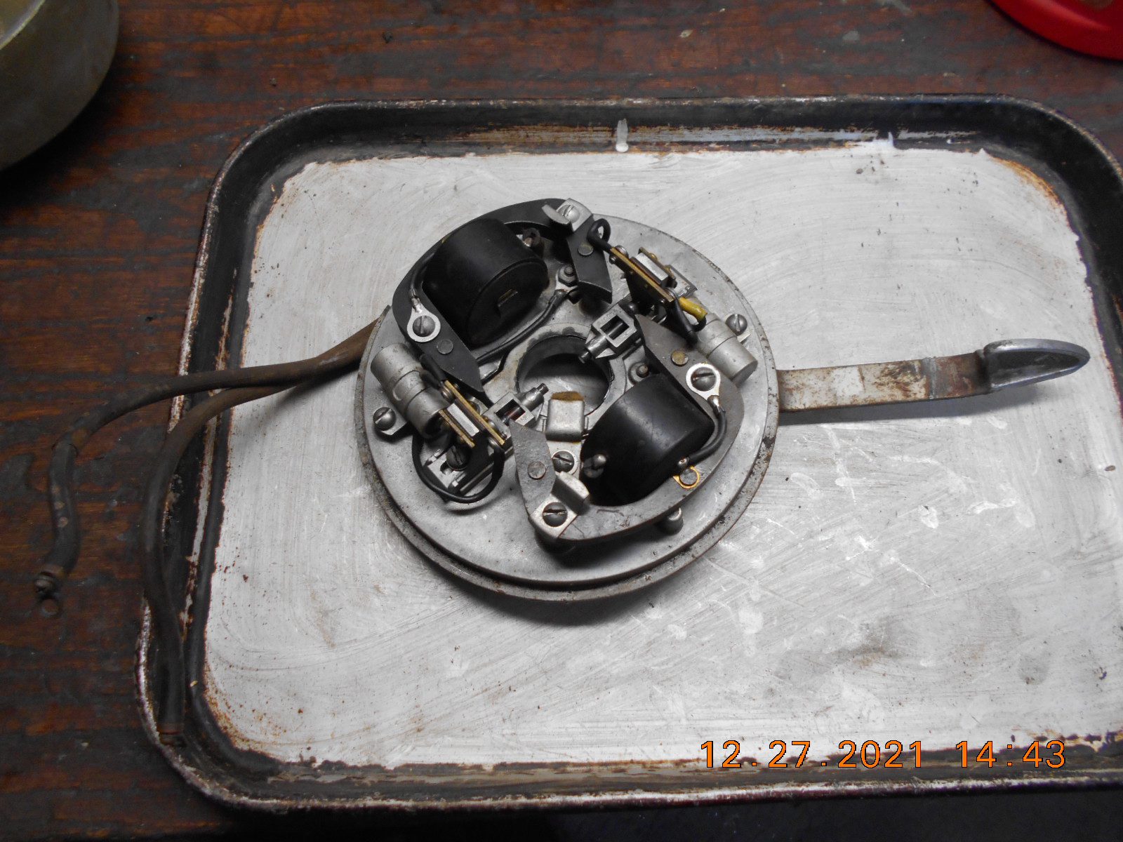

      my 1946 HD25 2.5 hp i picked up a few months ago had all the wiring disconnected.The points on this motor are very different from other Johnsons ive seen?Does anyone have a wiring diagram for this motor.Looks like the ground and hot on the points are on the same bar ? Any help would be appreciated.A shot of the wiring on the points would be very helpful.Would love to get this to run  THANKS DaveR

        Maybe the attached images from the Service Manual will help.

          this is a TD-20 Johnson magneto, but I think the HD is about the
          same.
          DSCN2909
