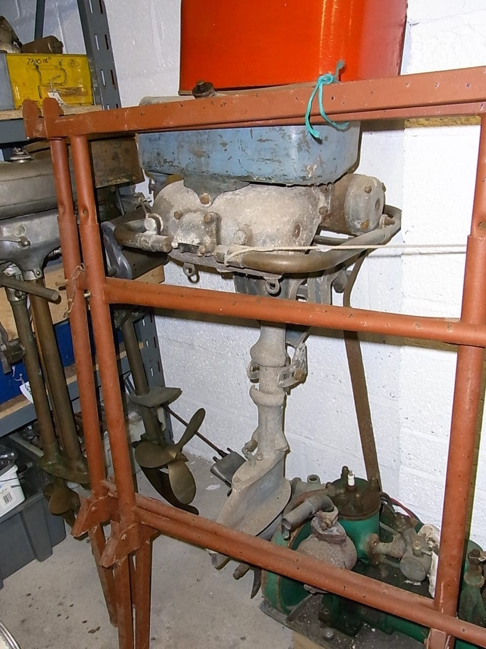

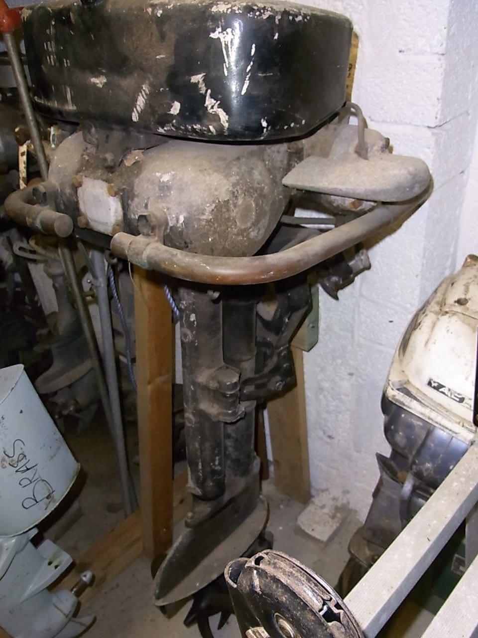

      Can anyone advise what the exhaust system is on this POLR-15? I am interested aquiring 2 project motors, one is a POL-15 serial 434453, 1941, the other a POLR-15 468797, possibly 1943.
      RIMG0065
      RIMG0064

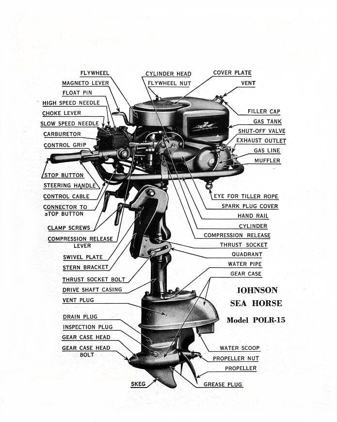

        The POLR (Long, Reversing) could be spun 180 degrees to go in reverse so the exhaust tube to the gearcase was eliminated and the exhaust fumes dumped straight out of the muffler can into the atmosphere. I think it was through a screen on the rear where a cover is installed on your motor but???

        #165803
        rapier
          OK, so that makes the top pic a POL. The other ’43 POLR I had was the green version, so wasn’t aware therewas non-reversing model. Thanks
          #165943
          LLOYD LAUTNER
            On your POL model you will definitely want to take apart and free up the exhaust relief valve located on the side of the exhaust tube. It must function well for starting and running at low speeds. Typical for them to be stuck from sitting for long periods in storage.
