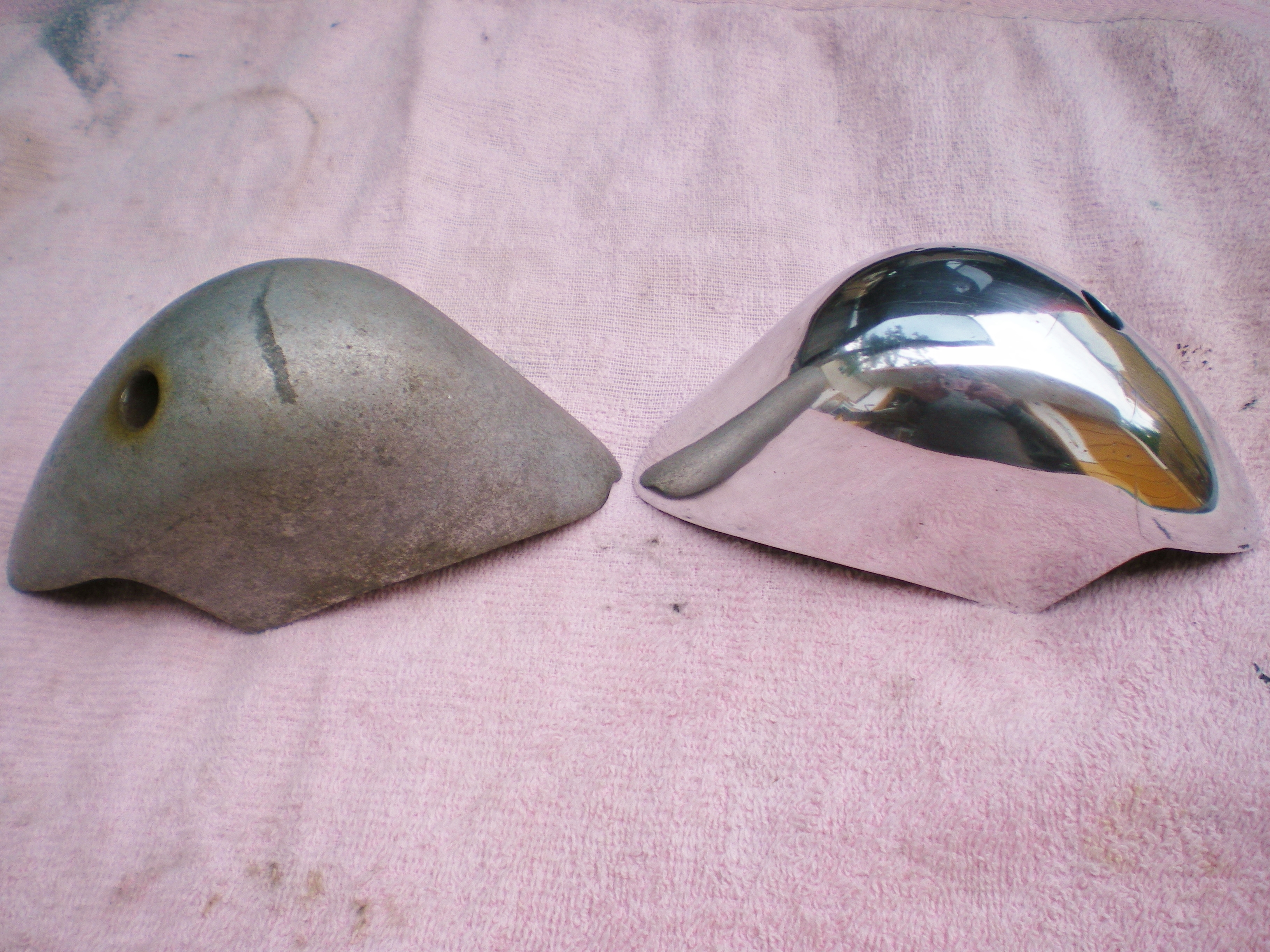

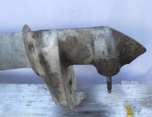

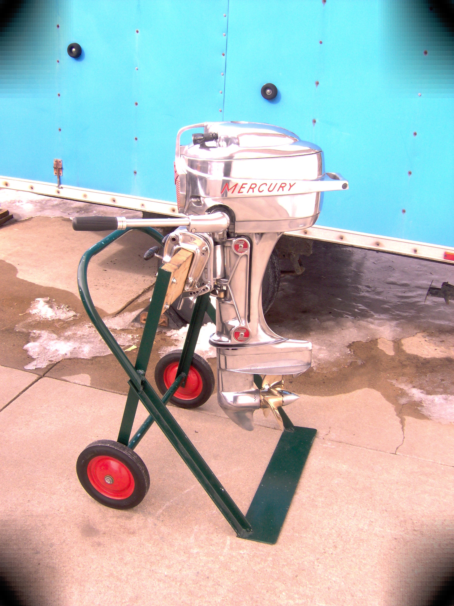

December 8, 2016 at 4:45 am #48838My first attempt at polishing a motor was a Mk-25 project that I called "Project Quicksilver" or "Johnny Cash". as in one piece at a time…. This was built from parts that came from scrap piles. I had recently started to weld aluminum and I wanted to see if my welds were good enough to polish them out. That lead to the entire motor being polished. These parts were all in really bad shape. I had to weld the cowls, drive shaft housing, swivel bracket, recoil housing, and the lower unit not only didn’t have a skeg, it had been assembled with the wrong bearing and a gear went through the side of the case. The previous owner then covered the hole with a huge gob of JB-Weld. I figured I couldn’t hurt anything! ๐ I hit my welds with a disc grinder and then went from there to a sanding block with 180-220-320-400-800-800-1200 and them used a wool pad. The next project was a KH-7 that I started with left over parts from this project. As it was left over from "Cash", I called it "The change"… ๐
The biggest thing I learned is that you can’t go with too fine of paper too soon. However, don’t use 80 grit or you will work your tail off trying to get rid of the sand scratches. With each different grit, I would sand in a different direction so I could tell if I left any sand scratches from the previous grit. This worked quite well.

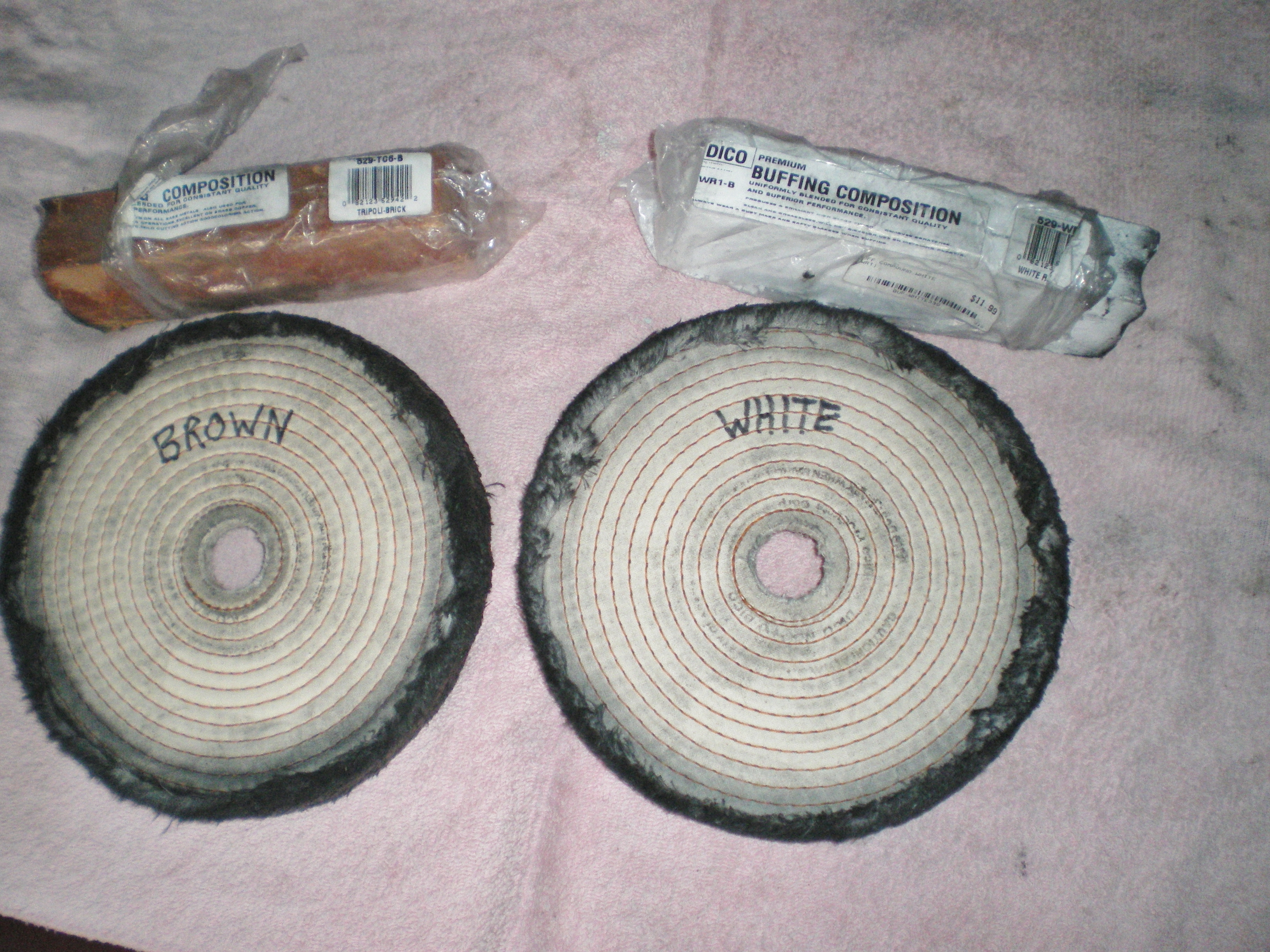

December 8, 2016 at 6:04 pm #48868Yes, I use sand paper. Wet sanding starting with Windex on the 220 grit and finer. All by hand on these two projects here. I did use a DA on my latest KG-7 tank ring that was awful. The corrosion is like a cancer that goes deep sometimes. In this case, I used 180 grit on the DA until I was able to get to clear metal. You also have to be careful not to sand out details or casting trademarks etc. if you want to keep them. As for polishing compound, I have used Mothers, and just about anything that you can put on a wool pad. I mounted the wool pads on my drill press, and worked it that way. You have to also be very careful to not let the chuck contact your work, or you have to sand out the flaw all over again. I had pads for Dremel tools for the nooks and tight spots.

December 8, 2016 at 7:29 pm #48877Using progressively finer grits of wet and dry is the key. Allow yourself lots of time and have a big tub of elbow grease on hand. To get a mirror finish, the parts have to be buffed after to remove any fine scratches. One word of caution, DON’T use Twinkle or other coarse polishes on any finely polished parts. They will clean a tarnished part but will dullen a mirror polished one. Then it will be back to the buffing wheel. ๐

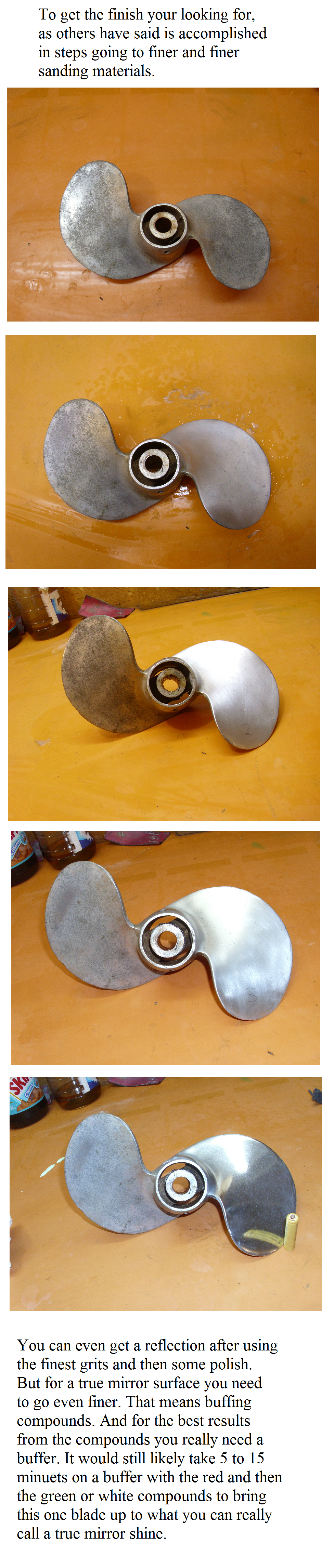

December 8, 2016 at 7:53 pm #48878December 9, 2016 at 12:25 am #488913M 2" pads can be also useful sometimes.
