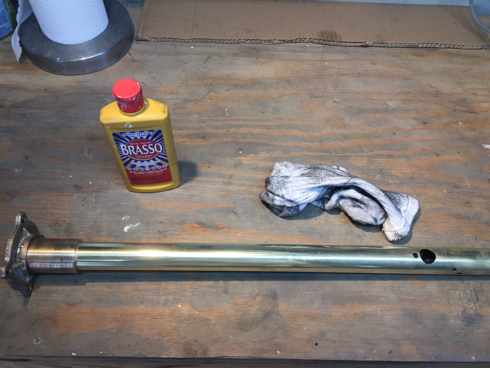

        I used Brasso on a Champion motor I restored.   Worked great.
        Polished-Driveshaft-Tube
        1982 Evinrude 25hp
        #270447
