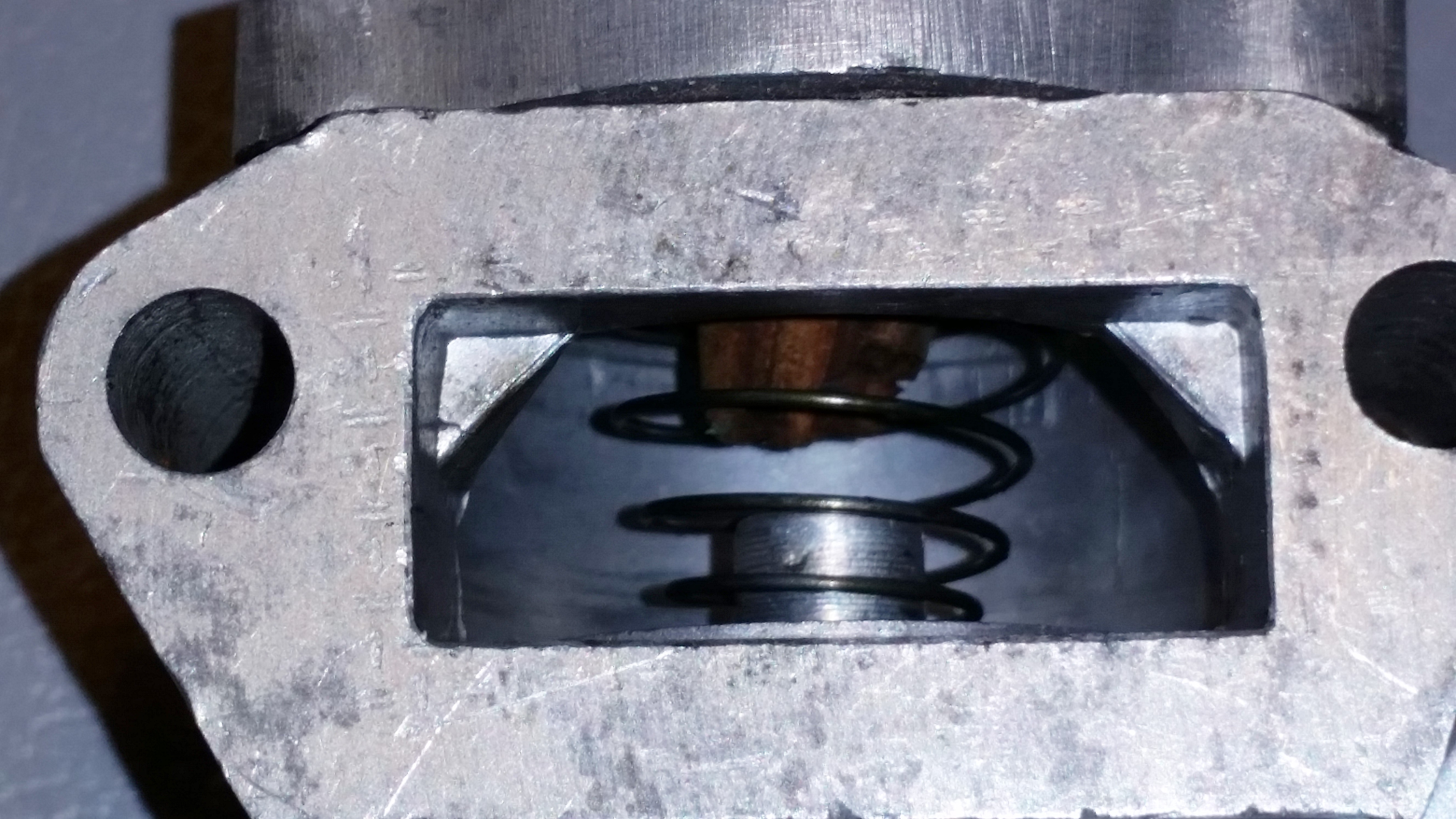

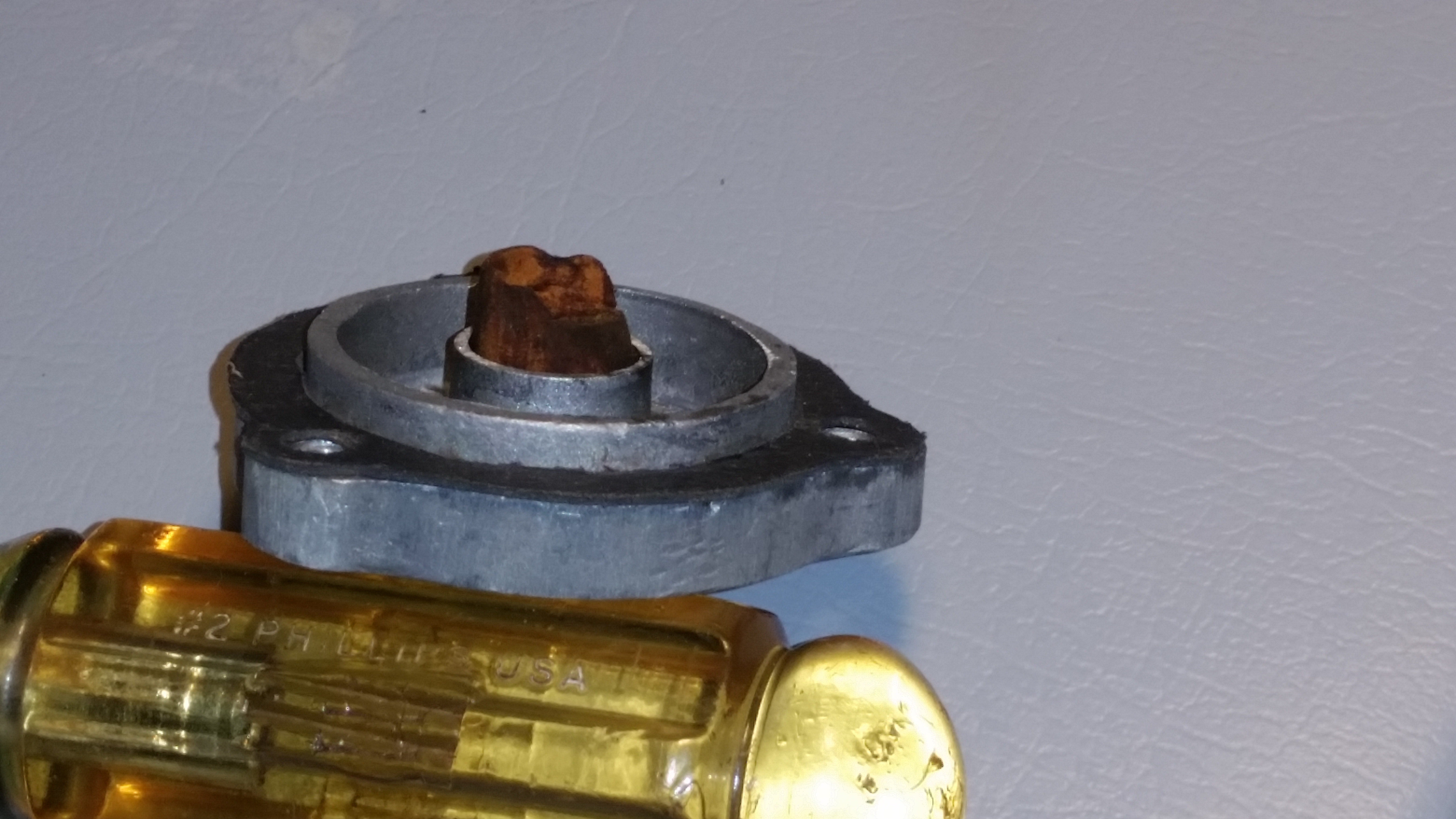

      Gentlemen,
      I recently started my Evinrude Sportwin 4421 for the first time, unfortunately it won’t stay running for very long. Looking back at the carburetor I found the up-stop for the poppet valve is deteriorated. It looks like ti’s allowing the poppet valve to travel upwards much further than originally intended. It’s going to need to be replaced, does it have to be replaced with cork or can a substitute be used? Would a piece of dowel rod suffice? If it has to be cork, could one be fabricated from a wine bottle cork? Any suggestions on how you could determine the length of a replacement?
      Many Thanks,
      Ray
      Brandon FL
      #68333
        Clearance between poppet and stop should be 9/64", measured by inserting the shank of a drill bit between them. I don’t know the answer concerning material. My guess is it has to do with wear rate and noise.

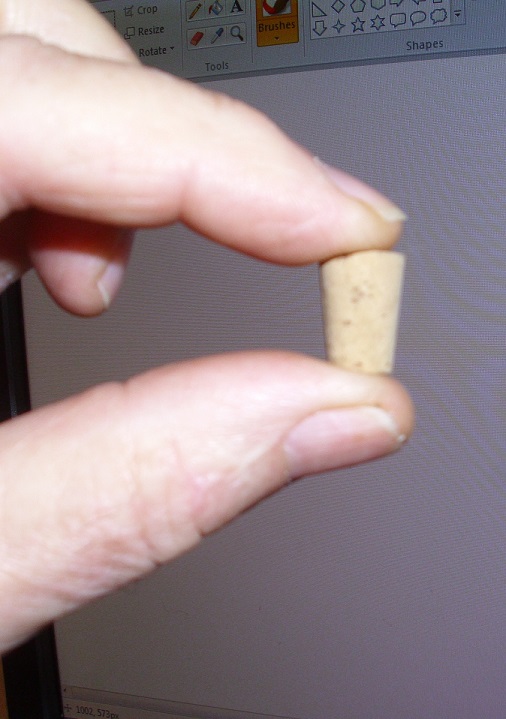

              #68356
                Go to a store like Lowes or a good hardware
                store and get one of these small corks. You’ll
                need to remove a little from the big end for
                it to fit. Then remove the rest. I suggest a
                sanding block when you get close and bring
                home a couple.

                  #68440
                    I found the right size small cork like Tubs pictured in the home canning section of my local Publix grocery store. . . 😆
