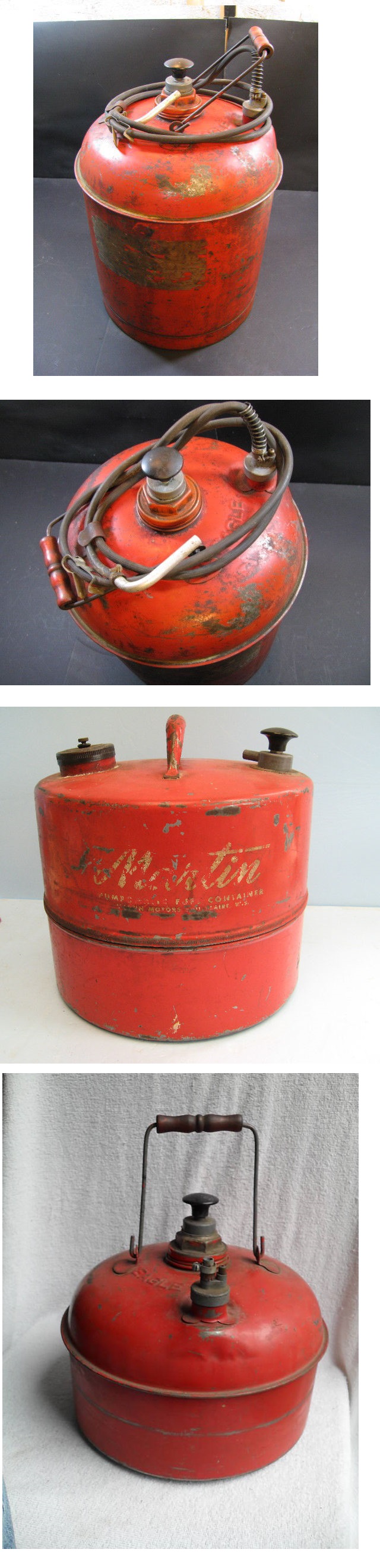

            Pressurizing the fuel can was how Eagle
            and some others would transfer fuel.
